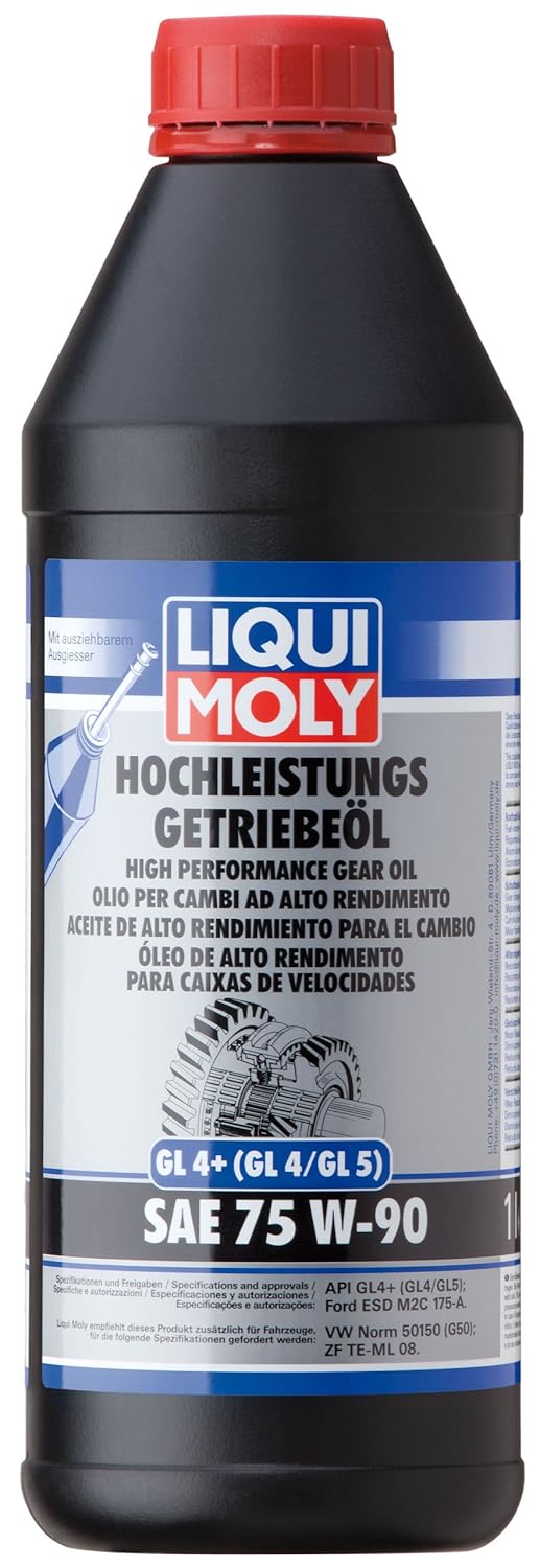

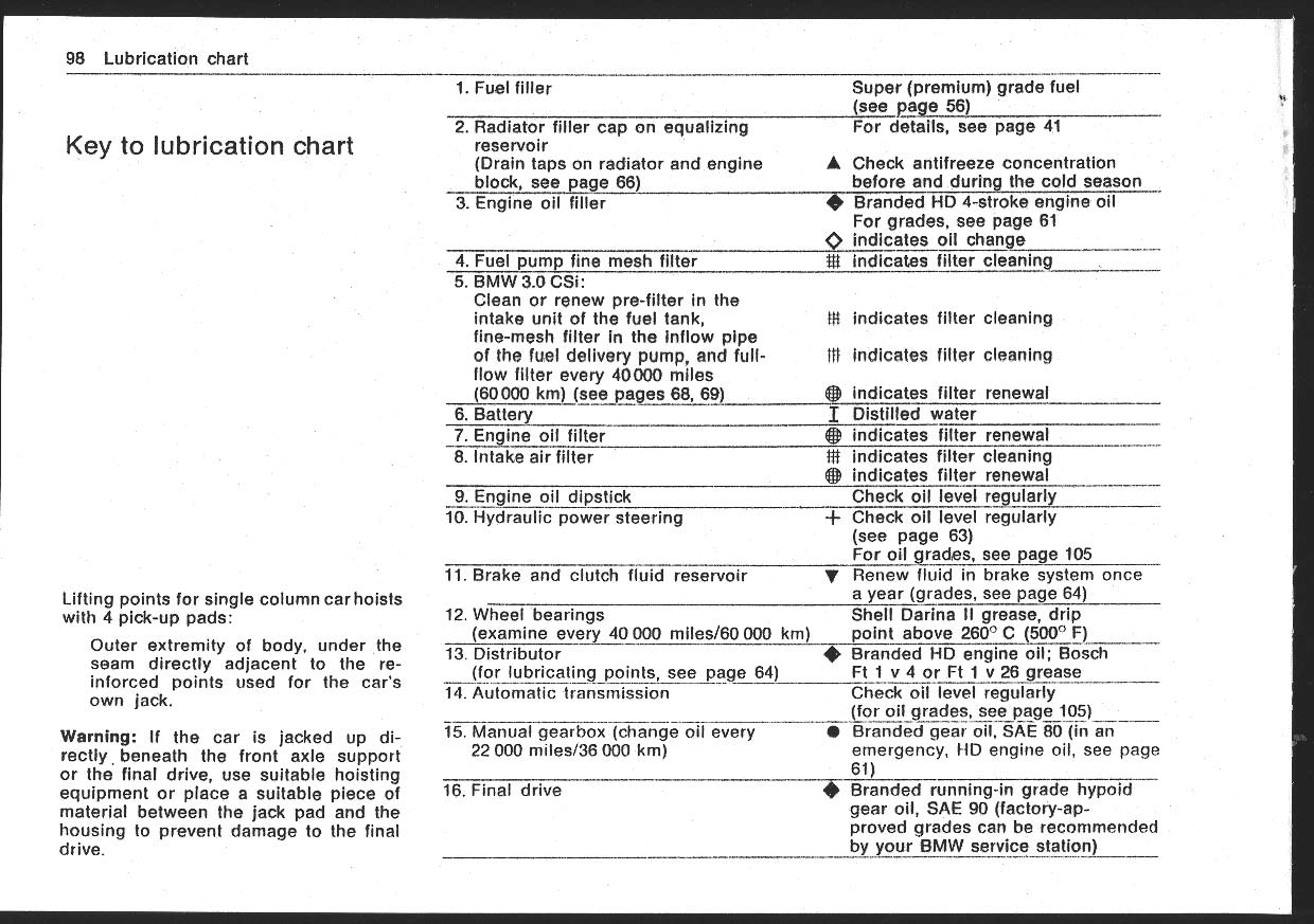

If you are only trying to increase viscosity, you could try adding some of the viscosity improvers commonly used in engines, e.g., "STP" or "Wynns Friction Proofing." To the best of my knowledge, these additives do not contain extreme pressure lubricants commonly found in hypoid lube that attacks yellow metal "GL5." Another option is replacing Redline with one of Amsoil's transmission lubes that are also GL-4 rated and therefore yellow metal compatible. LubroMoly also offers a GL4 75W 90 alternative. Another alternative is engine oil (see below).
