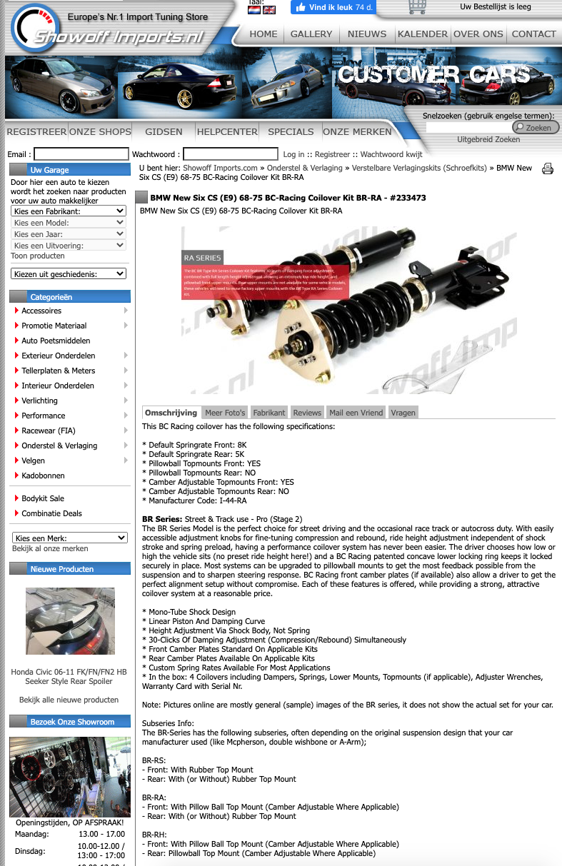

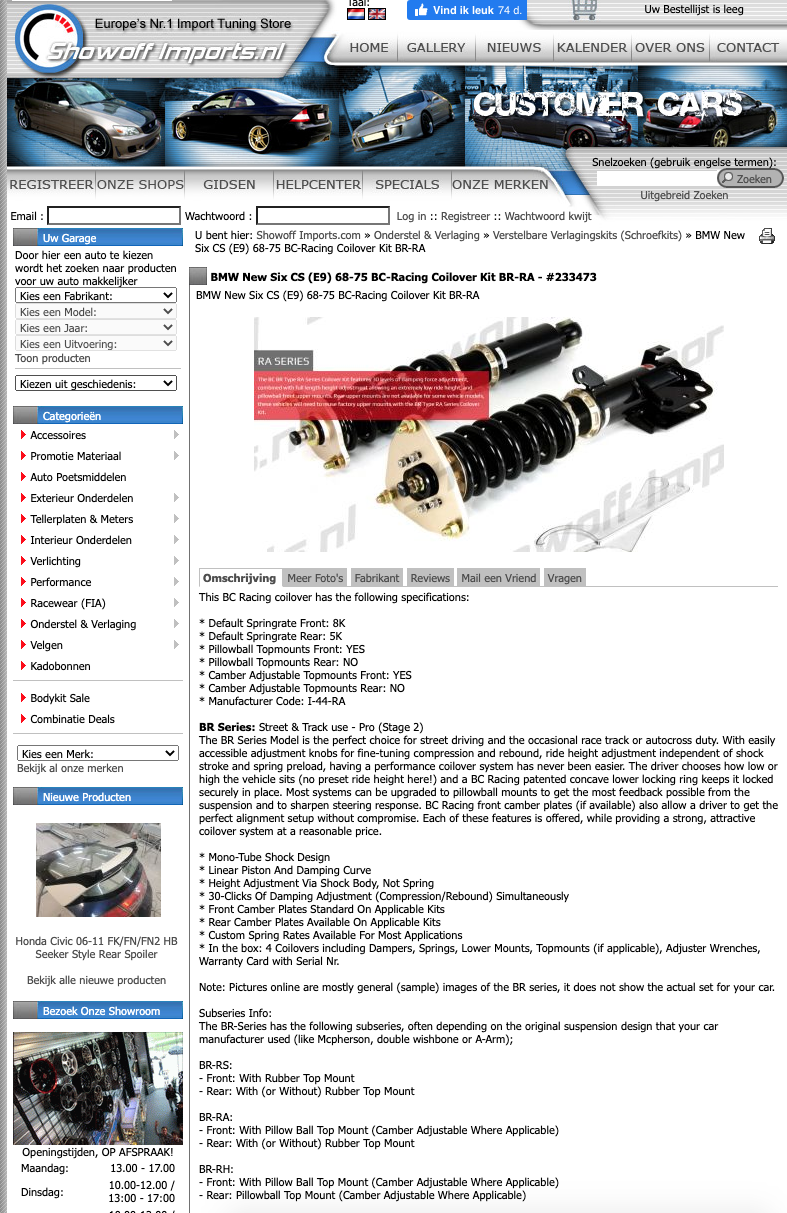

Need some advice!, new to the BMW E9 but not new in the restauration of cars. I have an BMW E9 2800CS here from 1969 and want to buy some coilovers and saw this company in the Netherlands. The guys says it's plug and play, but i think that i must cut my original struts and weld them on the new coilovers.. And must i use my upper strut with bearing again? or are these already in the new coilovers with camberplate? And i don't now if the back is going to fit, because it looks like that it is a other top-mounth then the original shock, these have two bolts (but maybe it's a universal picture by the Ad?)

I’m very suspicious that the vendor is using a stock photograph! The upper mounts look like they might work ok, even with a camber plate, but like you say, you would be cutting and welding your strut tubes drastically.
Perhaps the vendor has a reason to be confident but I know how difficult it can be simply putting Bilsteins in these struts if, for instance, one has been replaced with one from a later car.
