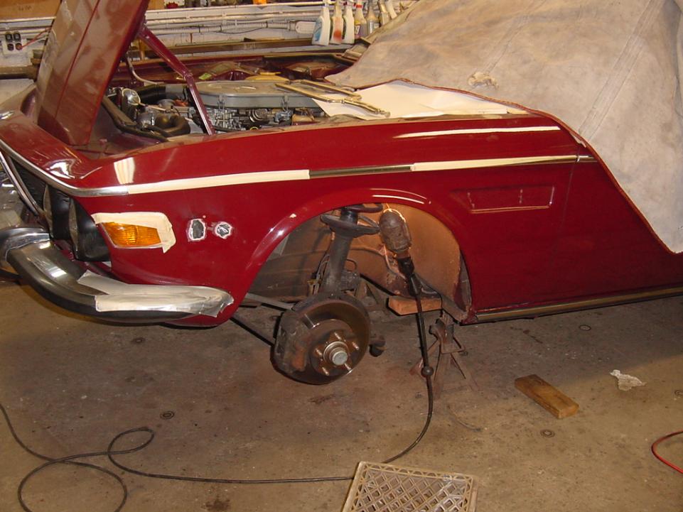

Well I have the biggest job I’ve ever had in my shop right now (a stretched flatbed movie shoot truck) that will probably take 2 months but by working at nights I’ve still managed to get my coupe ready to go to one of my old employee’s shop for some paint & polishing work. I have removed & welded up the holes for the automatic emblem, front reflectors and the swivel neck side mirror.

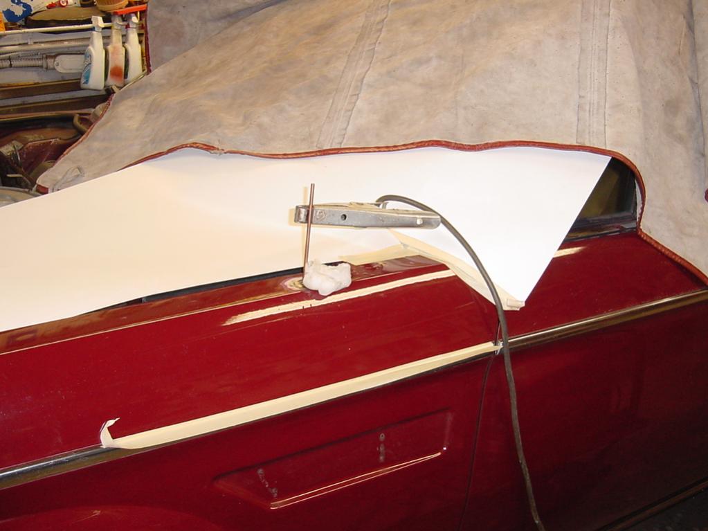

I’m thinking I will be going with the trapezoidal mirrors mounted as far forward on the door as possible. I believe the trapezoid heads mount nearer to the side window so less mirror view will be obstructed by the vent window frame :confused::confused: ??? I know it’s not original but I plan to mount the antenna on the quarter near the front tip of the deck lid. My friend is pushing for a roof mounted shark fin antenna which I feel is too modern to be appropriate but I’m open to other suggestions.
While I had the front wheels off I removed the rear shields and used various scrapers, picks and blow tips to remove about a dust pan of road dirt from each fender well. I’m thinking I will coat underneath with Dupont VariPrime, then POR 15, then seal the shields to the fenders with auto body caulking and then spray the whole inside of the wheel-house with schutz type undercoating. I’m open to any alternate suggestions on the previous procedures but I have decided it’s a poor band aid fix at the very best, the coupes desperately need proper front fender skirts. While I just don’t have time this winter hopefully next winter I can find a couple of weeks to build some bucks and fire up my power hammer and pound them out. I have several sheets of .022 thickness #321 stainless left over from a Osprey (vertical takeoff plane) duct job so I don’t even have to buy any materials. While the stainless doesn’t shape that well I don’t see it as that much of a challenge, I will just make them in several pieces and spot weld them together, stainless spot welds great :-D. ~ John Buchtenkirch
