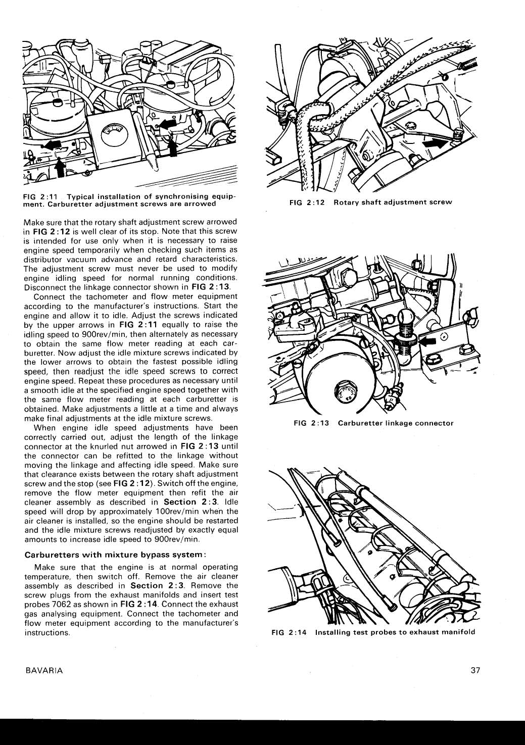

I'm trying to get this '73 running right. The timing was WAAAY off, and now that I think I've set it right, the idle is WAAAY low. It's been so long since I had a carburetted E9 that I forget. With the dual Zeniths, there's a single adjustment screw that sets the stop for the linkage for both carbs, but there is no such single screw on a Weber setup, correct? I need to set them individually, correct?
Not clear if you are referring to "rotary stop adjustment" (see Fig 2.12 below), but setup I have limited familiarity with was same as factory. Haven't worked on Weber conversions in a while, but obviously, some linkages may be different. Maybe this will help:
I think there is a single adjustment screw on the linkage to synchronize the carbs but I am pretty sure the idle adjustment screws are on each carburetor for both Zenith and Weber. There is an adjustable stop on the linkage that is used to increase the rpm while adjusting ignition timing but that should not be used to adjust idle rpm.
I think that answers my question. The "rotary shaft adjustment screw" shown above is, I think, only present on the original Zenith linkage but not on the aftermarket Weber linkage. You're saying even if it were there it should only be used for timing, not for normal idle adjustment. Got it. Thanks.
Correct, and to dial in proper idle, you'll need vacuum gauge(s), air meter(s), or a hose to listen to the carbs with in order to sync them.
