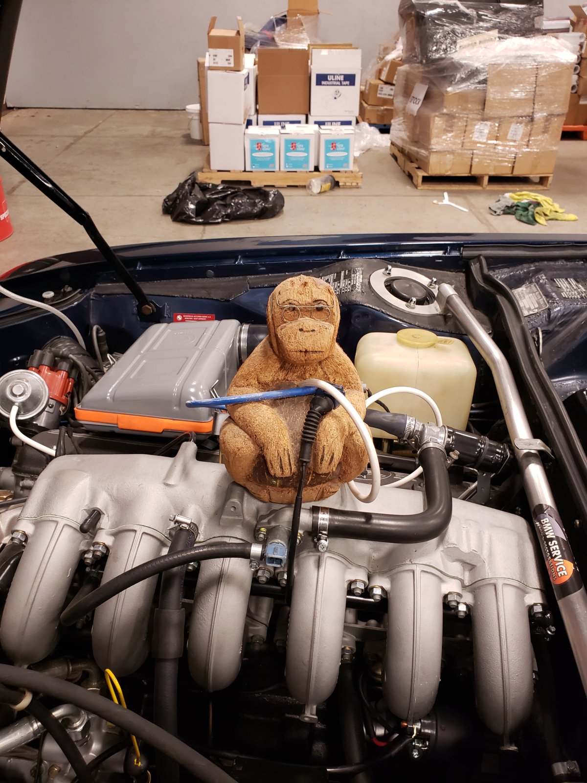

Peter, you are an awesome host and our time at "The Ranch" was super relaxing and comfortable. It was great getting to know Stevie and the goats! The Coupe looks great...there were just a few items under the hood that I couldn't make sense of because they just weren't connected to anything...o_O
Glad to hear everything is in good running order now. I look forward to our next visit...on to SATURN!!!
Hi Drew, I looked and looked and I simply could not find anything under the hood that was out of place??
Hello-?? Am I the only one that can see the vacuum advance hose is the WRONG color?!?!
Other than that its perfect...... The dizzy is indexed to show off the vacuum can- it's called artistic interpretation for Gods sakes.
Well I liked it Actually.
I think its the bracket on the ICV with the zip tie that is throwing me off...

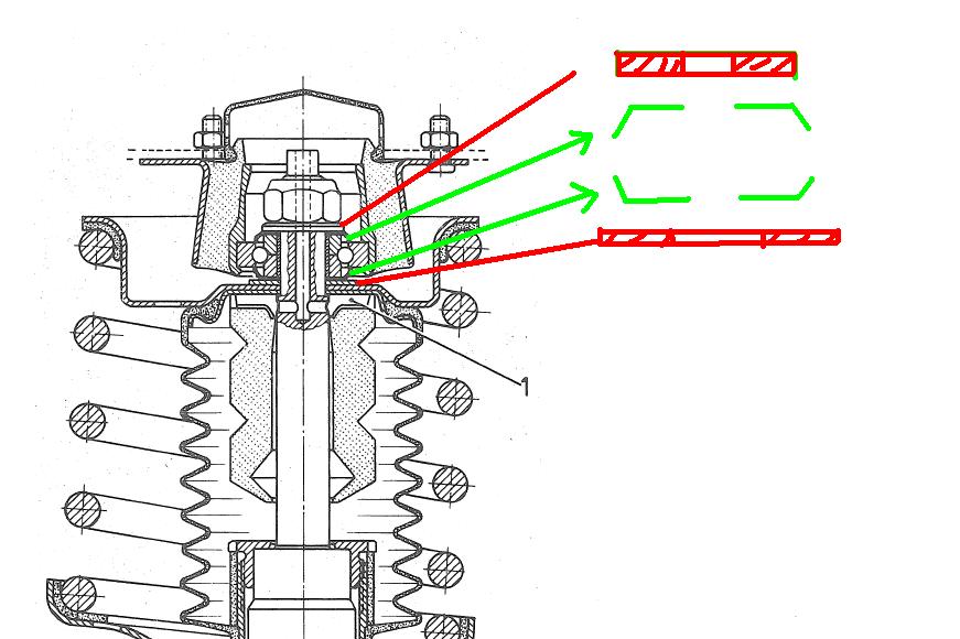

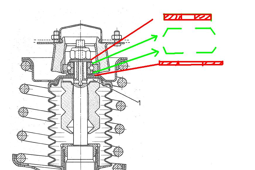

Hi James, there is a specific sequence for the washers that go on top of the strut (between the strut housing and the bearing) If you get them wrong the steering will "bind". The problem with this situation is that you can't detect it when the wheels are off the ground as there is no weight on the bearing, so when you jack up the front end everything feels fine. The picture below is courtesy of DeQ. I have to reference it every time I put in the struts :-(

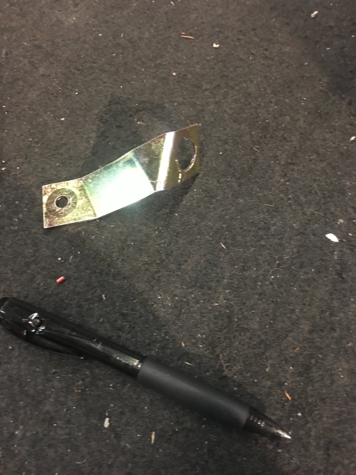

If anyone has a "proper" bracket for the idle control valve they would like to sell please let me know, I could also use a "proper" bracket for the fuel regulator.

Lose the monkey and reconnect the cold start valve and we will talk....

But Don, how will the car possibly run without the Monkey?
...and Peter, make sure you hook up the "other" end of the cold start valve as well please...

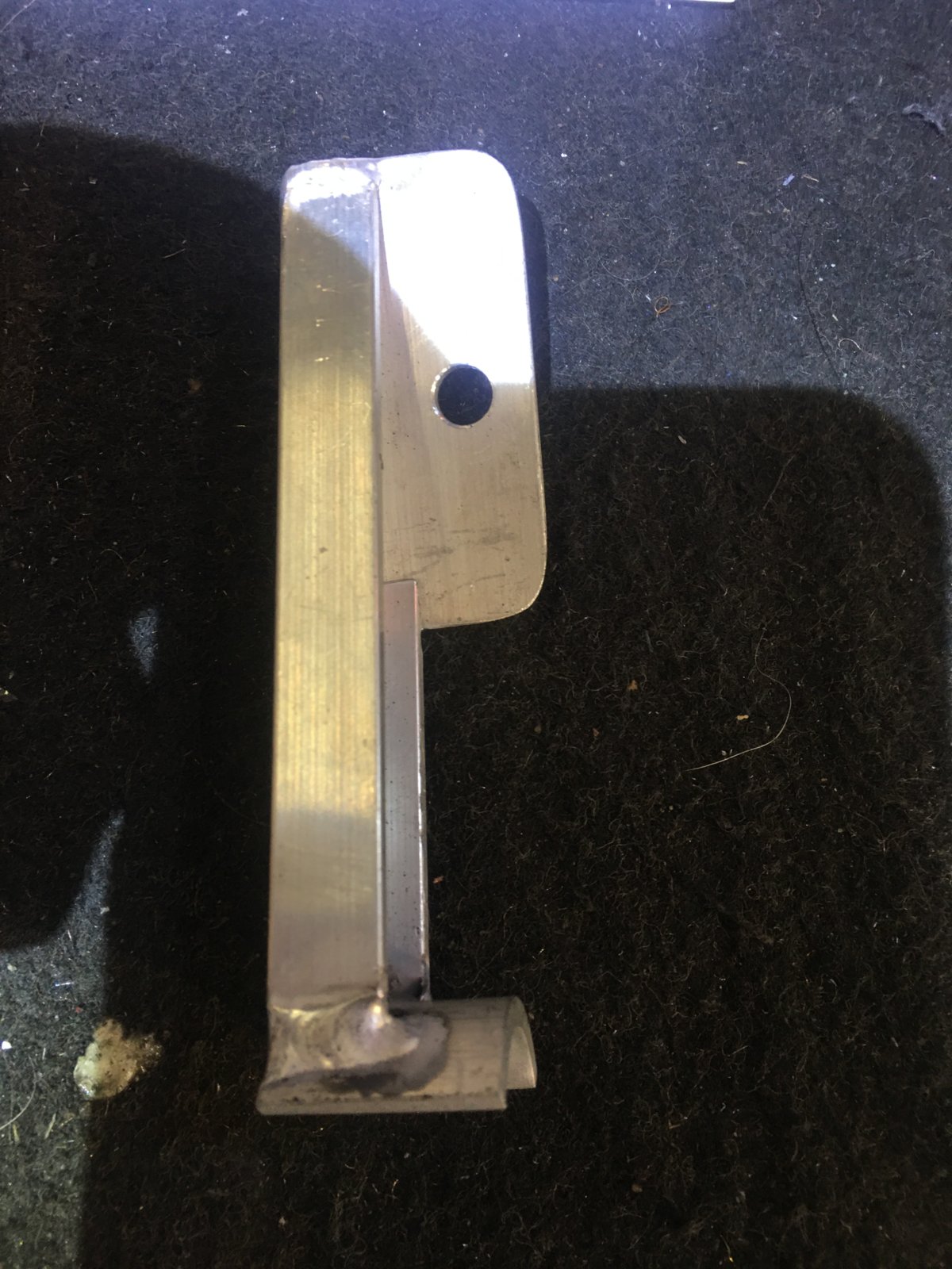

Your other bracket (for ICV) is shipping today.
Drew is very jealous now.....
Note the picture is upside down- which shouldn’t be an issue for expedition 56 guys :)
The jury is still out until we see it in action...but you know, there are other places to install that ICV Don...
