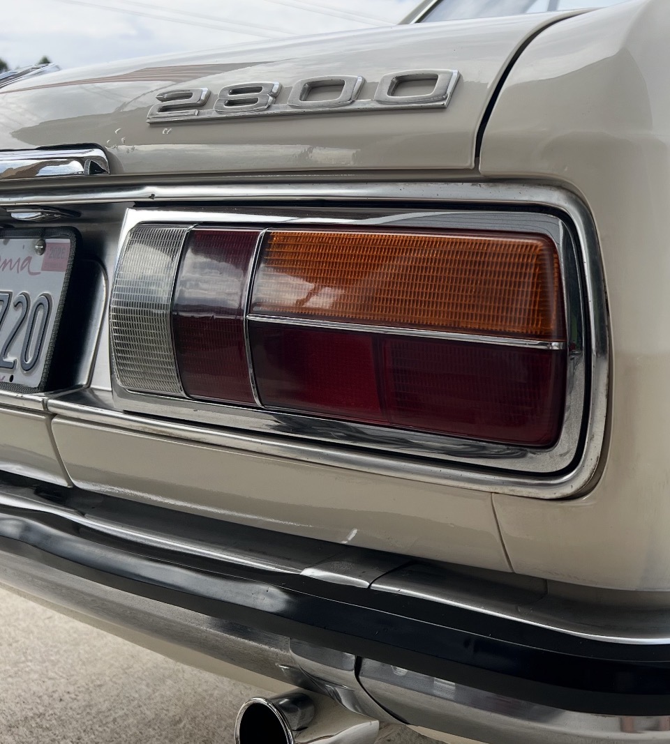

As an experiment, I used a series II tail panel for my series I. The Bav chrome trim indeed fits the early cars (if you want to change to Bav tails). I had to trim the openings to fit the larger horizontally taillights, but fit and seal well.

Thank you for your help and the photos!
Two questions @RichenFamous :
  1. Your 3rd photo is a Series I headlight mounted in a Series II tail panel on a Series I vehicle (I can see the trunk chrome) .. a photo of the actual modification you did?

1. Yes

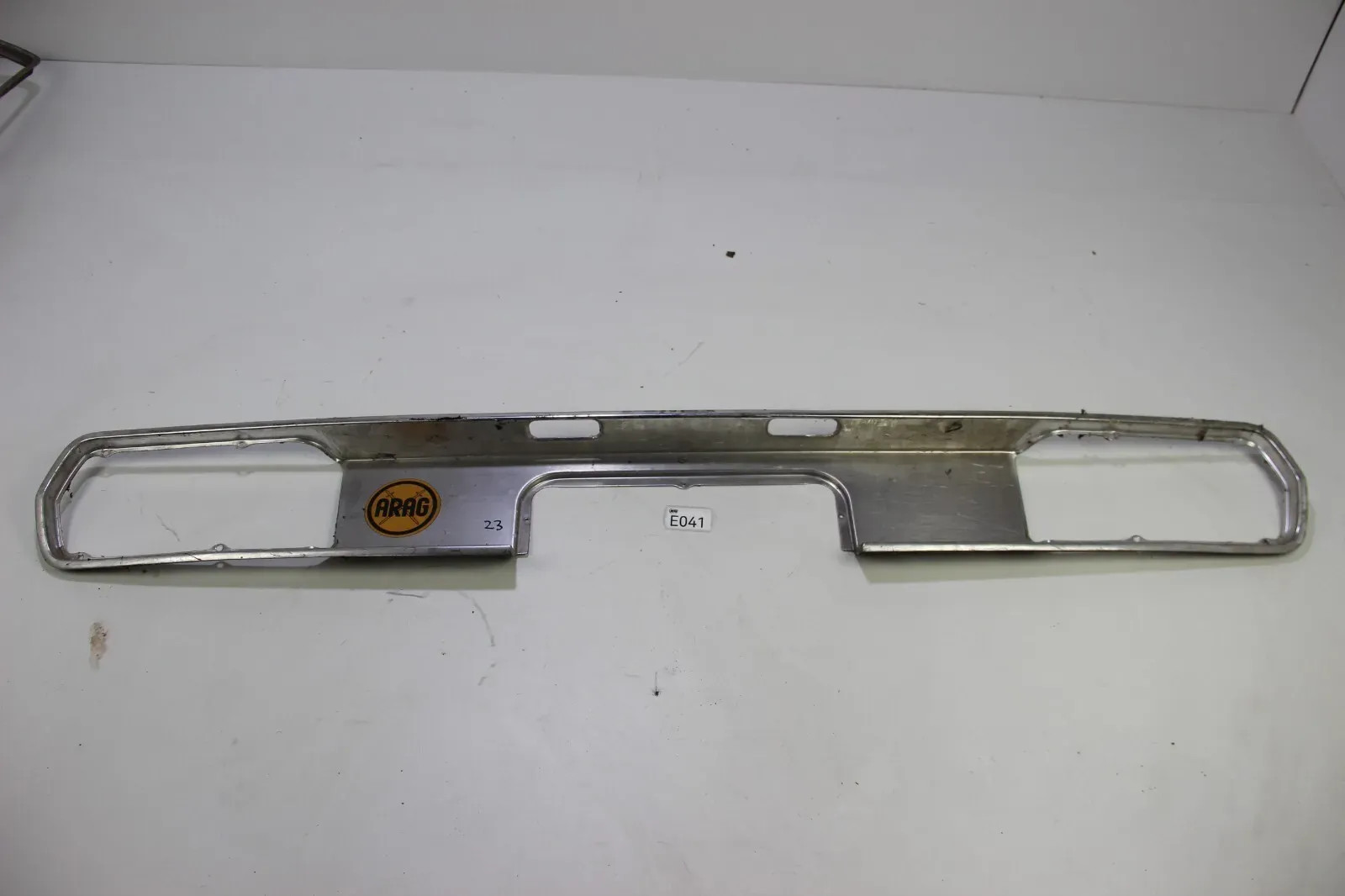

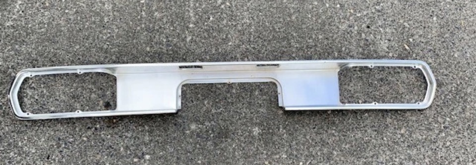

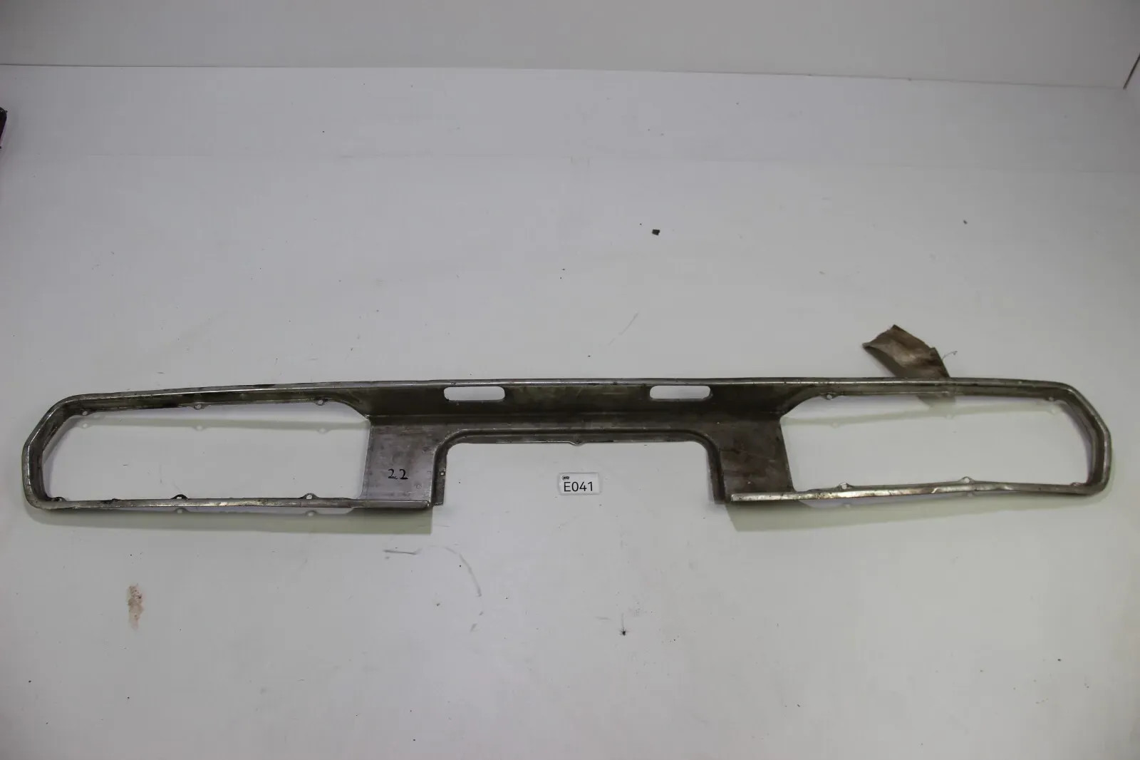

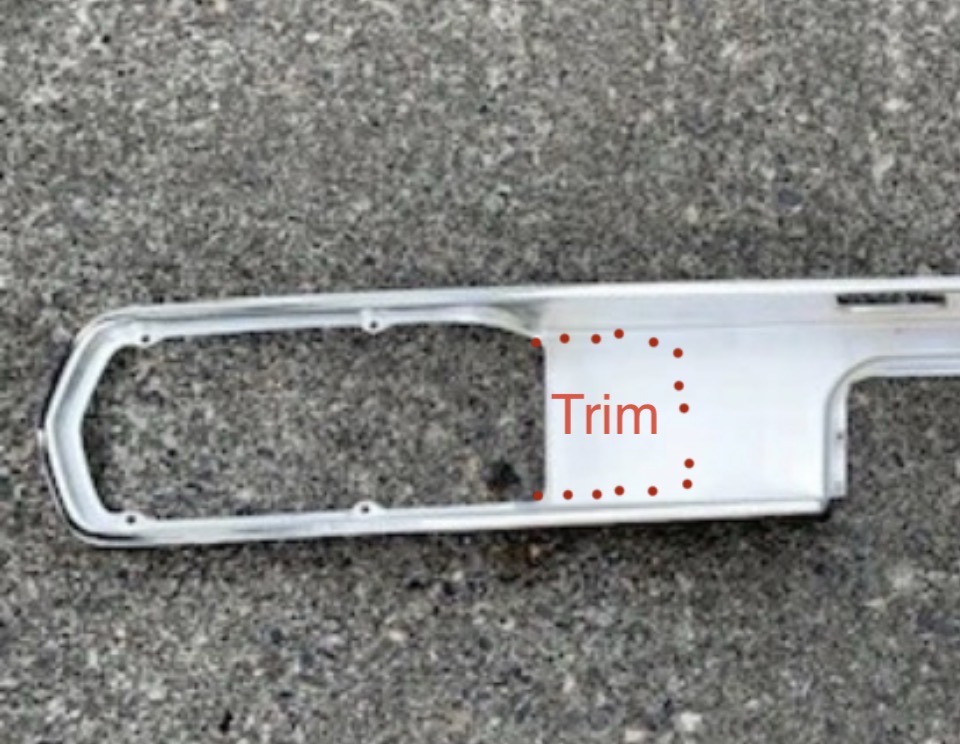

Here are images of Series I & II tail light chrome panels... you can see the difference in the tail light width.
