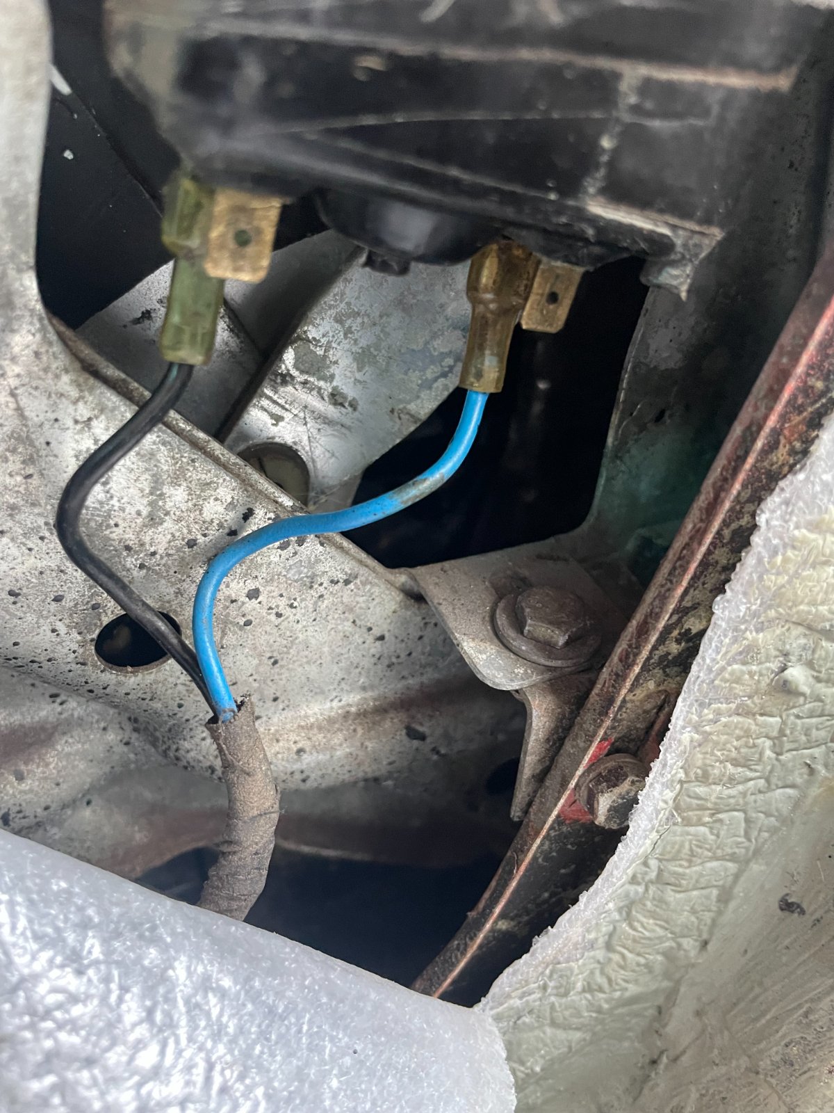

My passenger side rear window is exhibiting some weird (to me) behavior. Its a 2 wire system that worked fine previously before the winter hibernation.
The window will go up when to switch is activated, but will not go in the option direction (down) when the opposite side of the switch is depressed. Of course, the window will go down when the connections to the motor are reversed.
The motor itself has 4 connection points and I didn't record what the previous wire connection was. What am I missing here?
Does anyone recall what the correct wiring connections are?

Take the switch apart and clean the contacts with an emery board or equivalent.
I was just gonna ask if it was an Audi.
If the motor worked before, and you have no changed the connections, then yeah, it is probably the switch.
