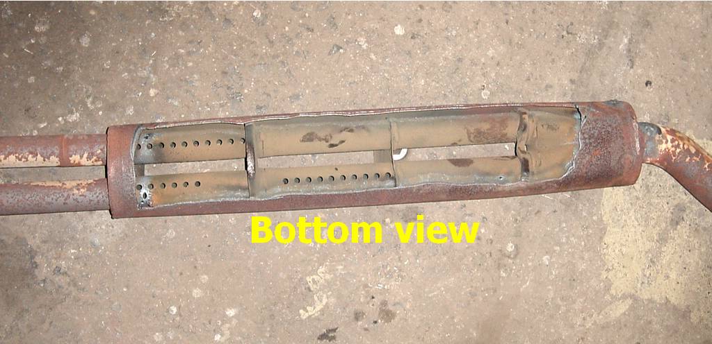

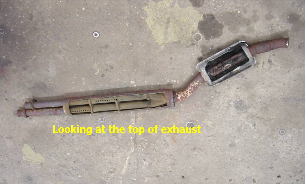

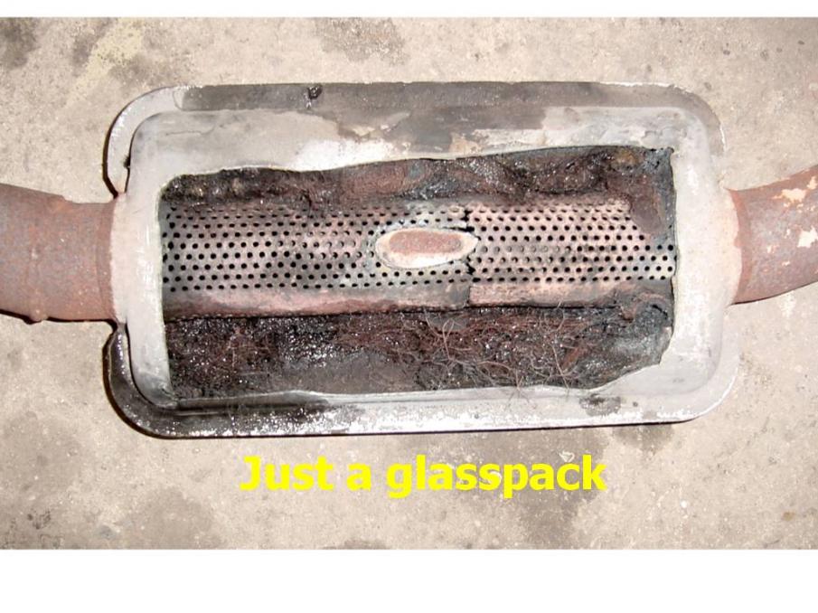

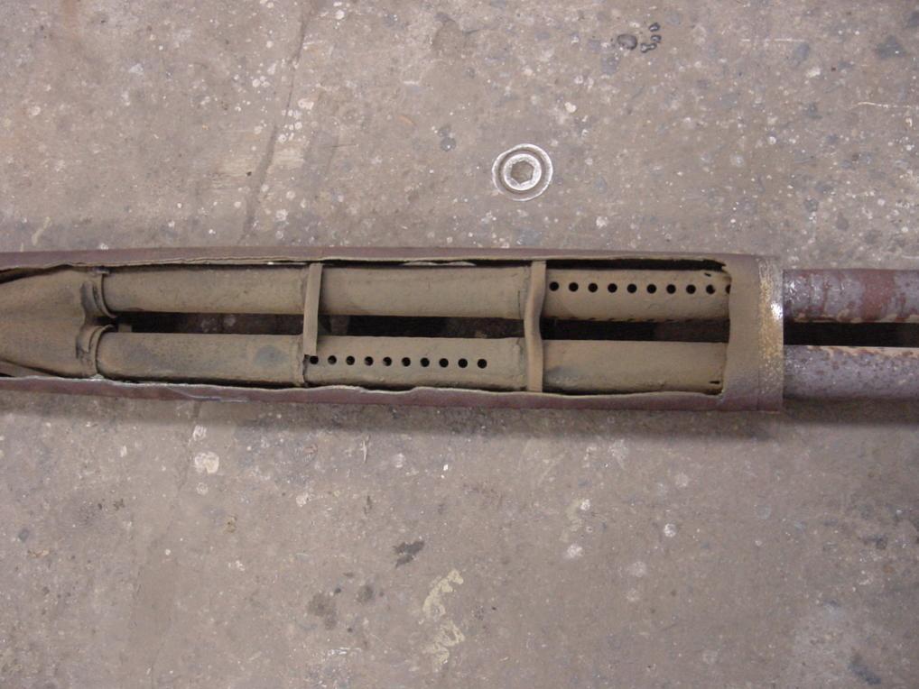

I don’t believe the stock exhaust is that restrictive unless you feel the tubing is just too small. I also remember Murray mentioning speaking to someone from BMW whom proclaimed the same. When I dropped the bad exhaust on my coupe I plasma cut the skins off to see what made her tick, so to speak. As you can see the front muffler is just a straight thru pipe with a few holes bleeding off into side chambers and the center resonator is just a glass pack. Sorry, the rear muffler was good so I can’t show you a cut away on that. ~ John Buchtenkirch
