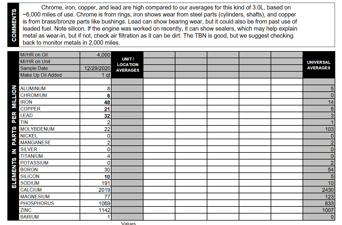

I am hearing some knocking coming from my engine. Per @sfdon suggestion I took the filter out and saved whatever was in the filter housing and want to send it for oil analysis.

I’ve only used Blackstone so I can’t compare and contrast but it’s easy and convenient and reasonable turnaround time and price. You get a nice report about wear items and water in the oil and viscosity breakdown by the numbers and a nice written paragraph of explanation, easy to understand.
  • BlackstoneReport.pdf

My analysis came back, wow, some many elements it looks like a periodic table!
The note says:
Universal averages for this engine type are still in the works, but lead, and possibly iron, look a bit high. Iron comes from steel parts, and lead can show bearing wear (or blow-by fromleaded/race fuel, if used recently). Low oil pressure/engine knock are two common signs of a bearing issue.
If sodium is from coolant, that could be adding to wear. Potassium (the other coolant marker) is low though,so sodium may just be additive in the oil. Monitor for coolant loss as a precaution. The oil's low viscosity is okay -- fuel wasn't to blame. Check back in 1,000 km.
