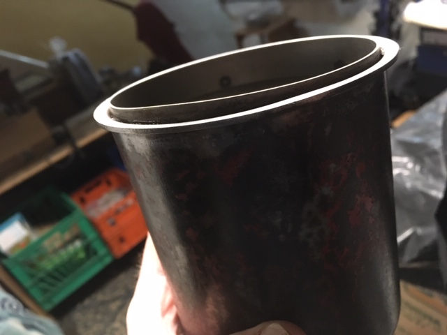

I swapped out my original for a top mount but then decided I needed a winter project. I know decals were available from Luis A and CS-Werk sells them. I assume Luis has none given the age of the post. Any source here? Also any sense of the color? My guys can match but there just isn't enough left of the original color. Also I assume mine is original and not modified, I ask cause the inner flange is a bit obtuse ( see below). Also there is only a mounting bolt, inner removeable lower plate and spring. Is there anything missing?
I have a top bolt on there but the recent forum has got me concerned about its applicability. I have to look and see if there are any numbers on it. I had the top bolt setup in my basement for ten years and don't recall what car it was from. From my POV, the bolt location is moot. The original one was just beat up but you know, as you restore, you become more anal an desire more of the original.

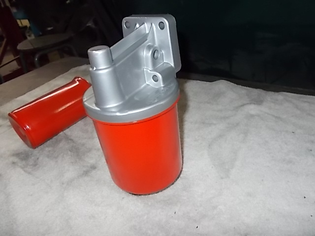

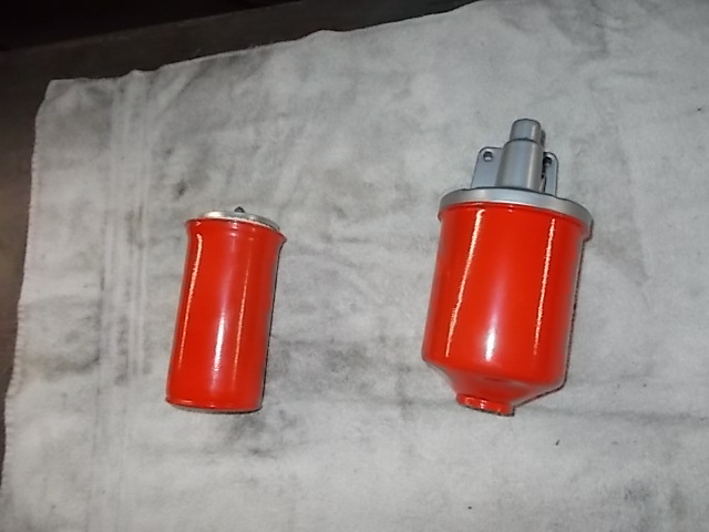

Here is an original one that I powder coated Still have to get the decal for it The smaller one is for a very early M10 engine It is an orange/red powdercoat
