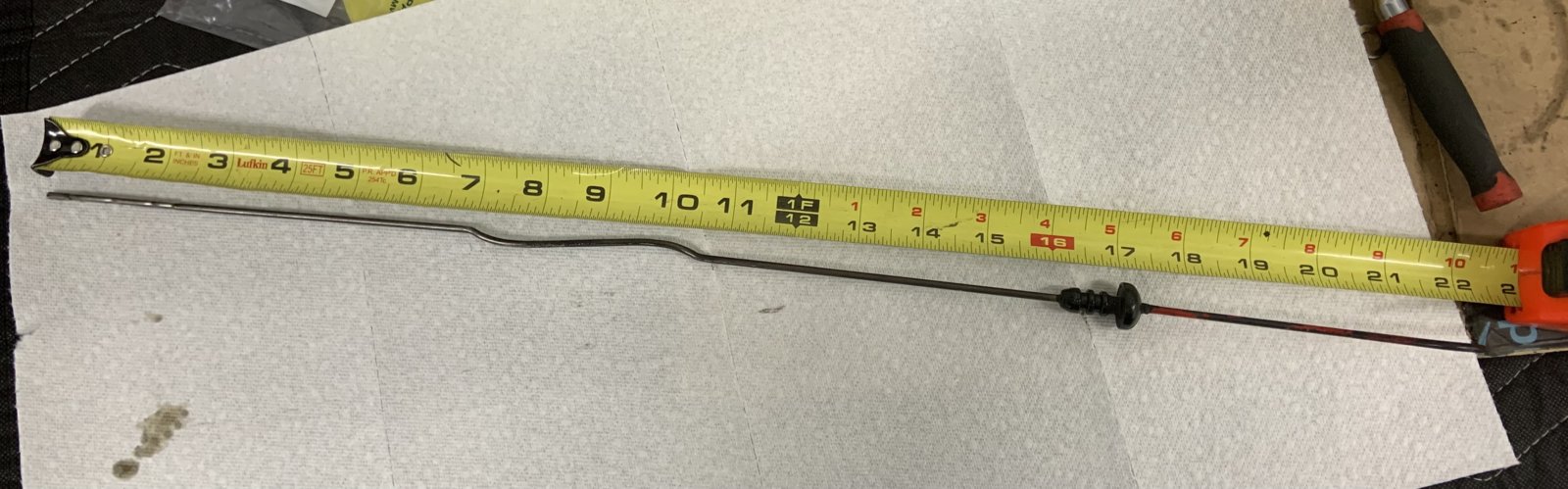

I still haven't solved the issue with the oil not reading high enough on the dipstick. I bought another dipstick from a 2800CS and have also confirmed that the tube from the block to the top is 8-1/2 inches. I will try modifying one of the dipsticks to be able to accurately measure the 6-1/2 quarts with filter change. It shows 1-1/2 quart low,
The only other possibility could be the oil pan but it appears to be correct I don't believe it has been changed.
This one is perplexing.

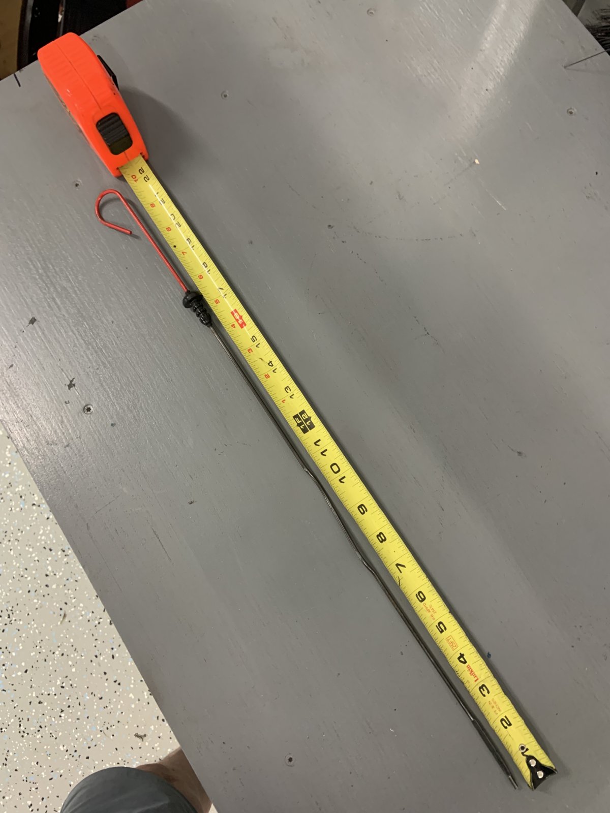

The 2nd 2800 CS dipstick is identical. I have inserted a coat hanger in and it goes in straight. I will take pics and also measure the angle of the dip tube.
This is taking all of my engineering and statistical problem solving skills. Atleast I have most of the oil leaks fixed so I am not loosing oil.

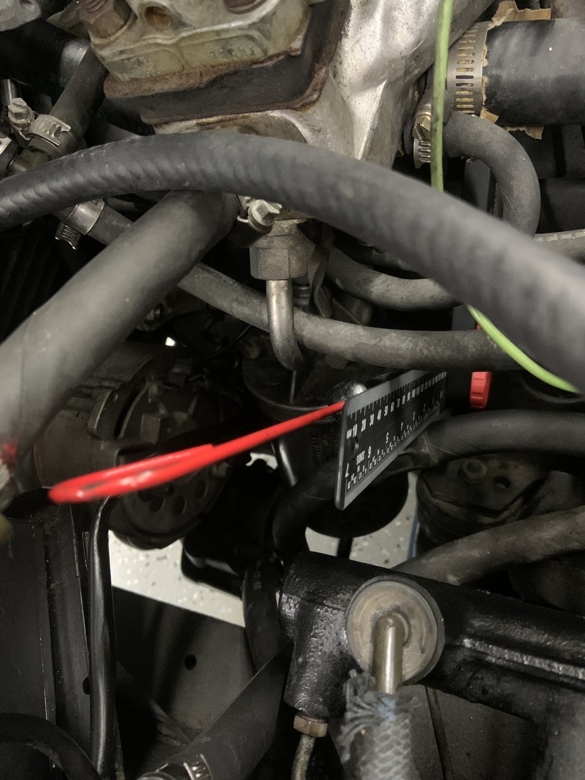

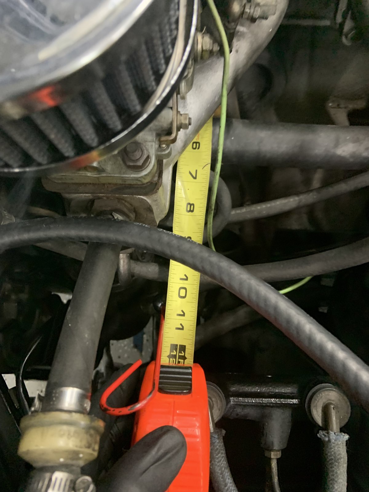

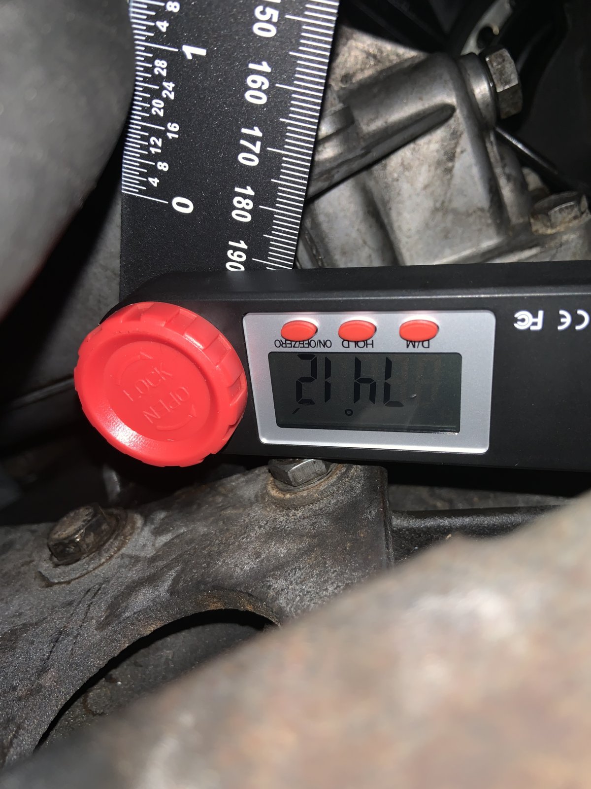

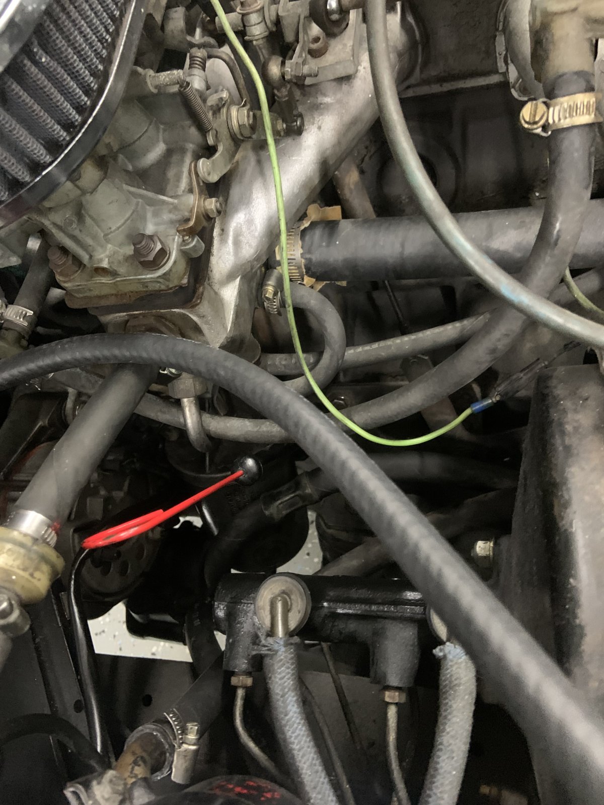

Here are some pics that might help understand my issue.
The tube is approx 74 degrees from the block (difficult to measure)
The center of the tube is approx 10 1/2 inches from the block.
The dip stick is approx 17 1/4 to stopper.
I sincerely appreciate your help.
Dan
