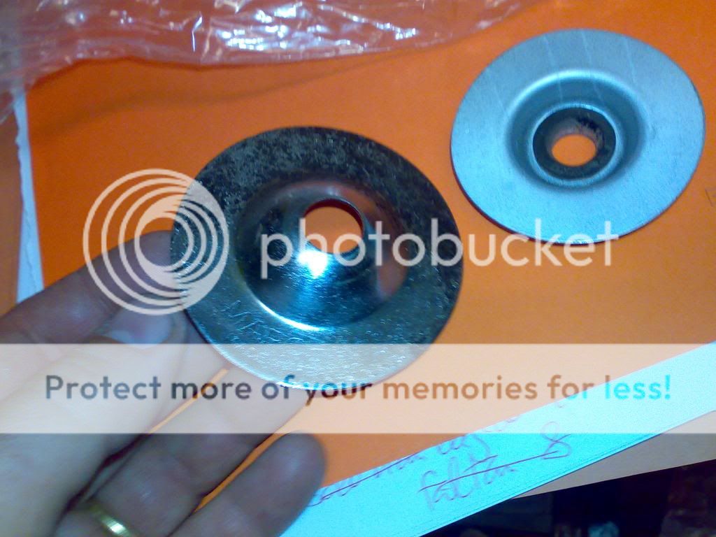

and checking the parts that we need for it, we opened the oil filter can,...to find...an odd part inside:

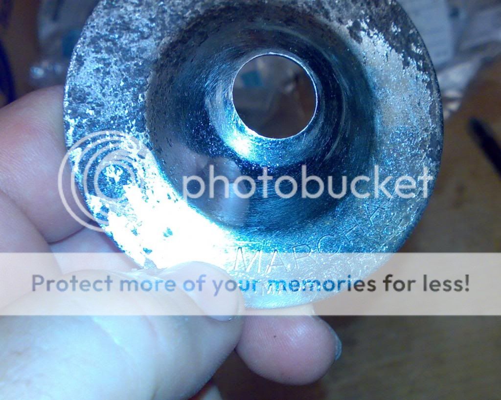

a "marchal-made in france" support, or cover for a certain light model,...but what was that plate doing inside the filter ?
it was placed like this:

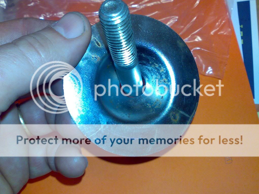

with the aim of supporting the filter cartridge, plus blocking any by-pass of dirty oil, thus forcing all dirty oil to go through the cartridge for a good filtering operation
but you see the gap between the bolt and the plate, this means that it was a by-pass happening, and a certain ammount of oil was not being filtered,....this was bad

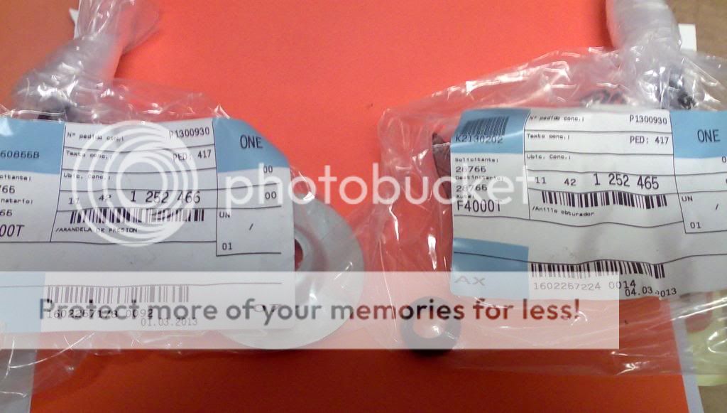

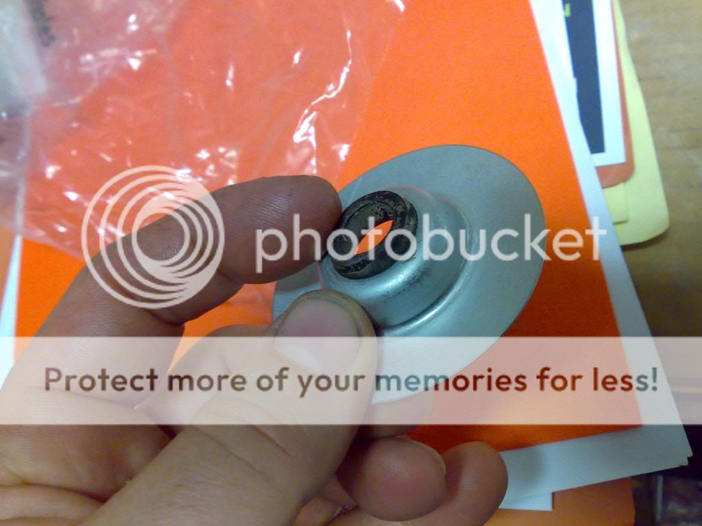

this is the right plate plus seal:

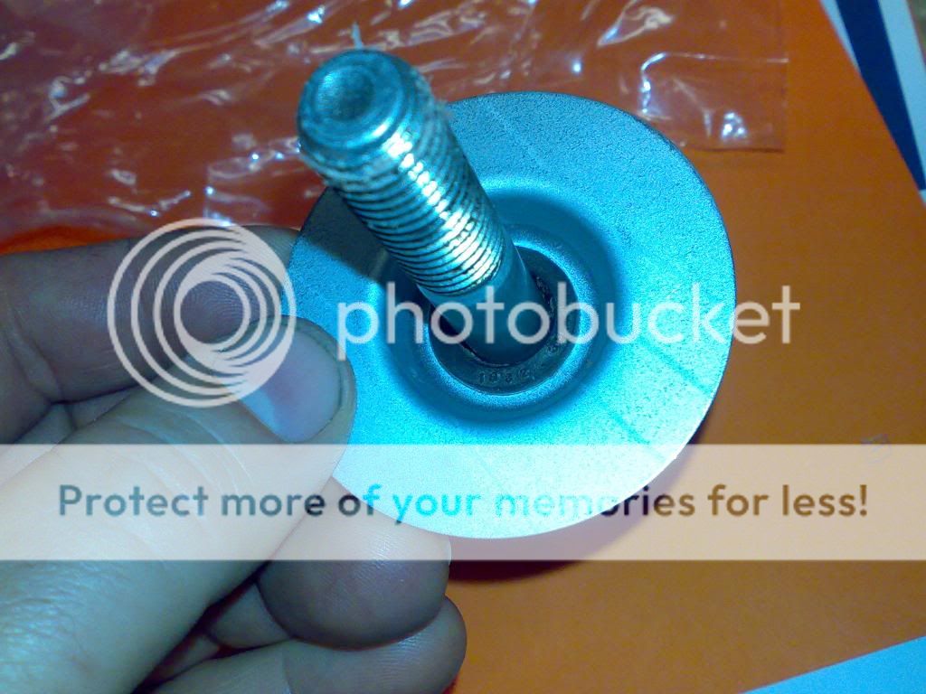

compare:
installed:
