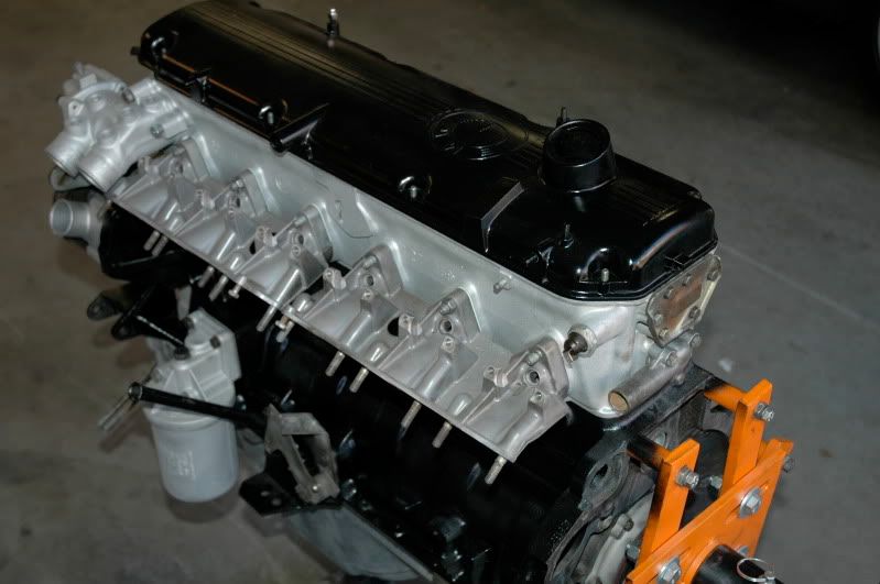

oil leak...maybe the pressure sensor , or rear cam cover..
Barry
Hey Barry,
that sure looks good!
I think the pressure sender is leaking a bit but the back plate seems not to be from feeling it - not dirty/wet etc. I have no insulation so can also see a good bit more down there. It definitely looks like its from the head gasket unfortunately.
I've never heard of the M30 losing oil from the head gasket before, but it is common for the plate at the back of the head to leak as Barry says, I had to do mine last month. Its worth having another look as it's a much easier/quicker fix that pulling the whole head off.
2.6 Ohms is fine although if you want to be picky you will get slightly less fuel per given pulse duration. It is worth doing a C.O. check and/or look at the colour of the plugs after a run.
