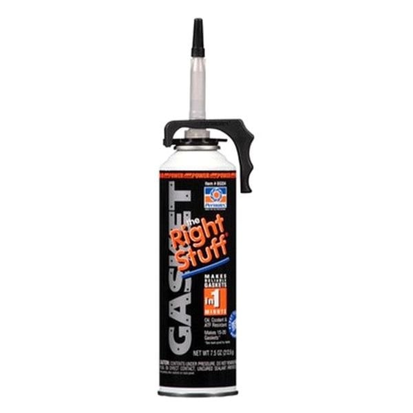

The right stuff...
Dirko or Hylomar per the manual. Usually in the corners where the cover meets the gasket and head

I don't believe Hylomar is a good one to seal a gap like this. As Mike suggested, The Right Stuff, or my fave, Loctite 598 in the pressurized can. 598 is a very tough RTV, spec'd to fill up to a .5mm gap. The Right Stuff is incredibly tough but a royal b***h to remove. That's how good it is, it tenaciously adheres. I once used it on an oil pan and needed tremendous effort with crow bars to remove it.
