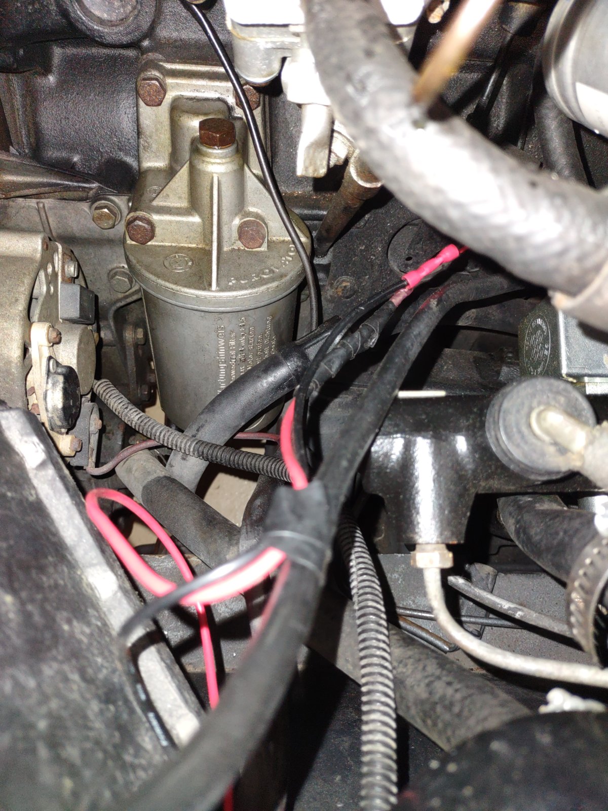

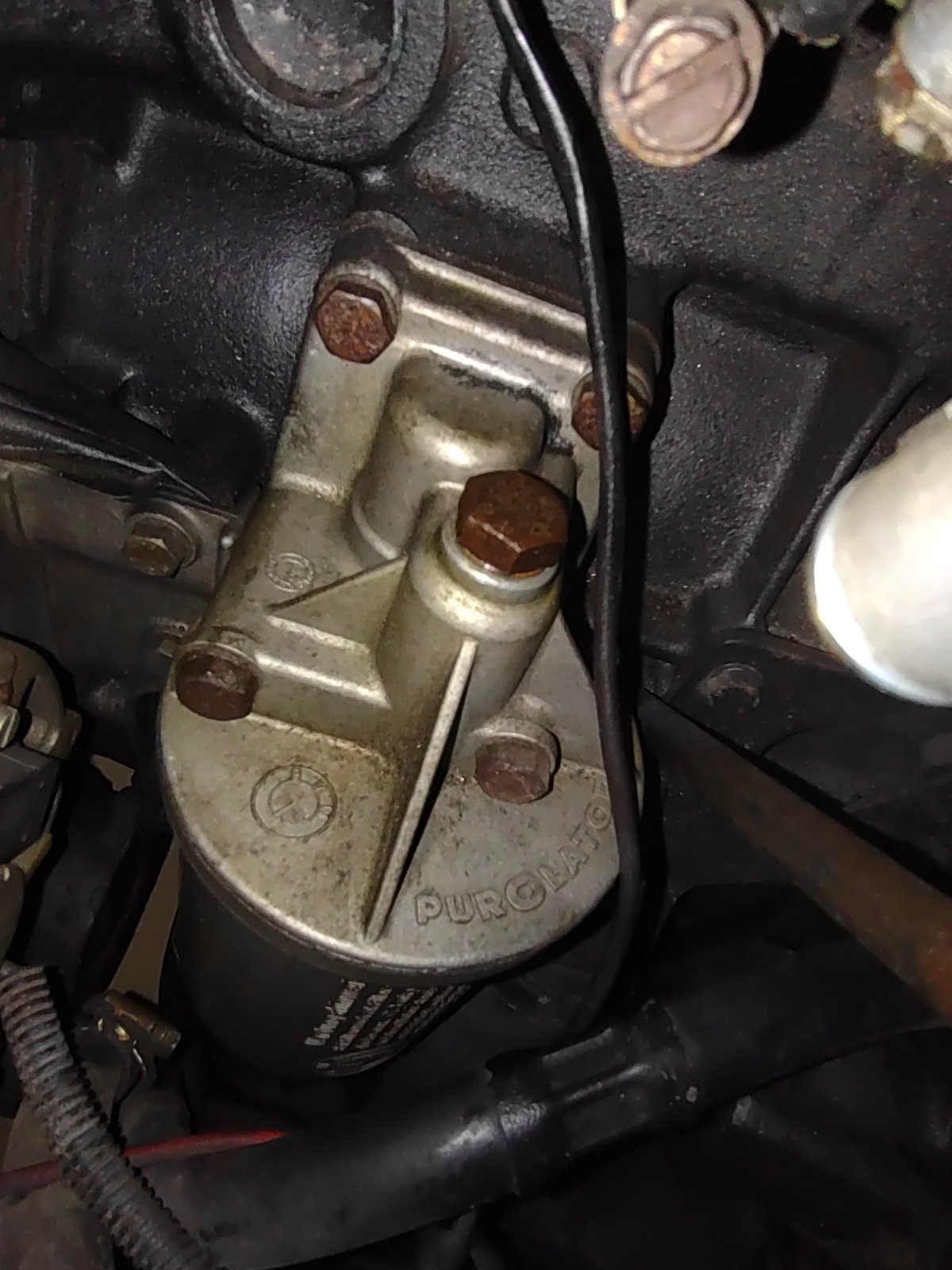

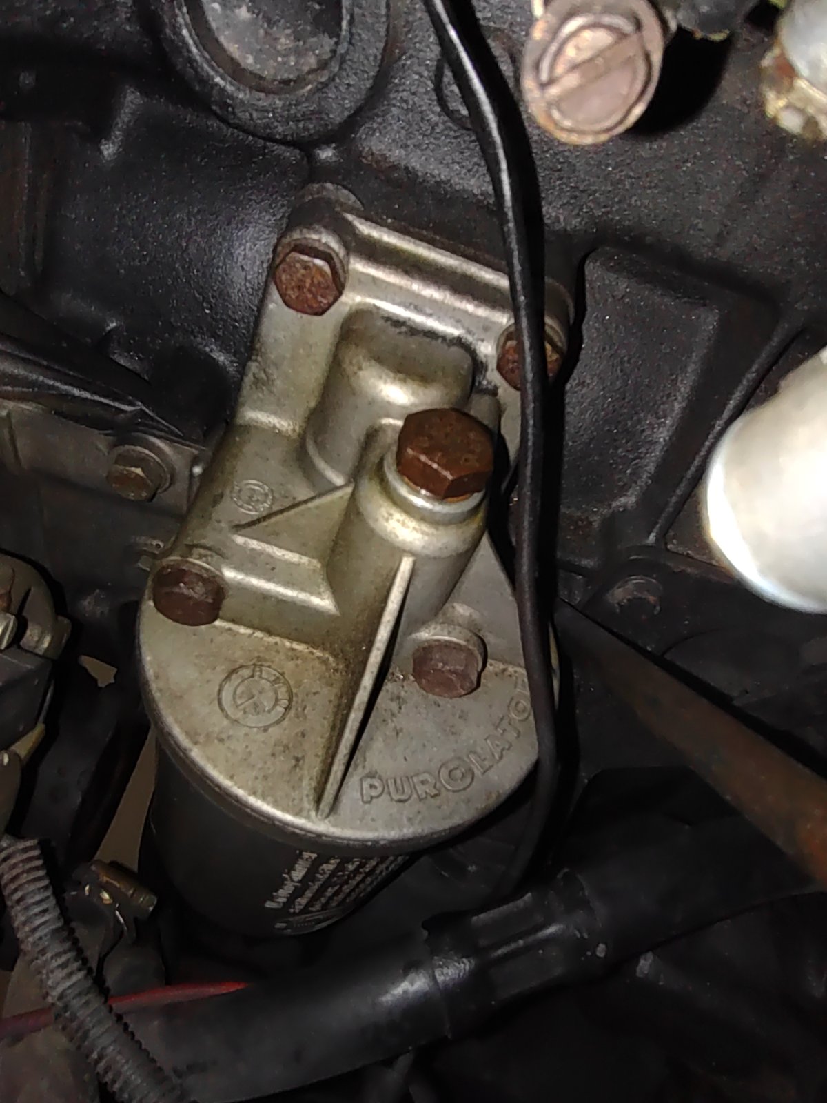

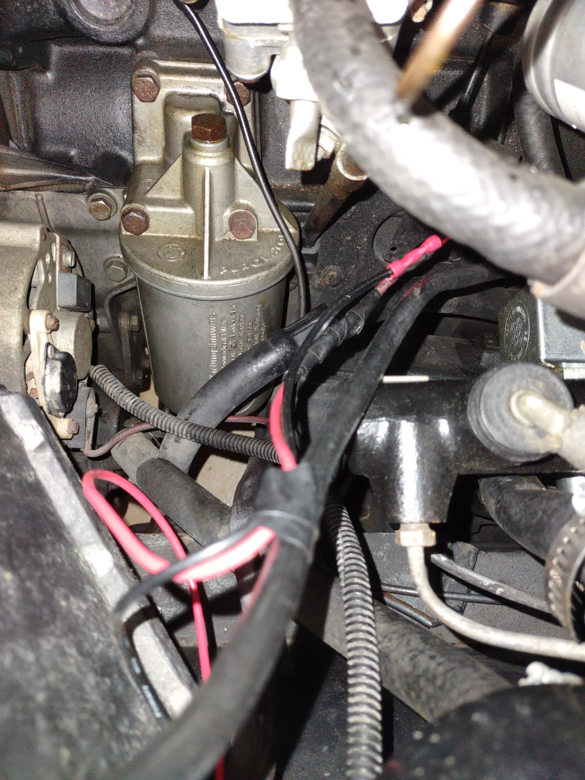

Here are pictures of current setup. Let me know your thoughts.
Oil is 20W50. Car is kept in my shop so always 65 degrees or above.

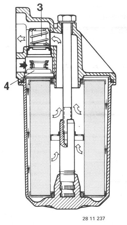

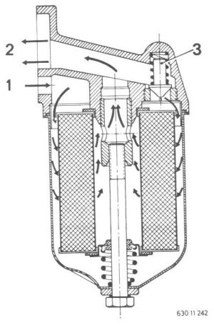

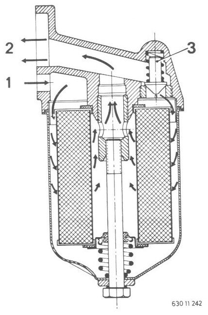

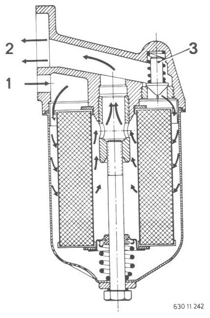

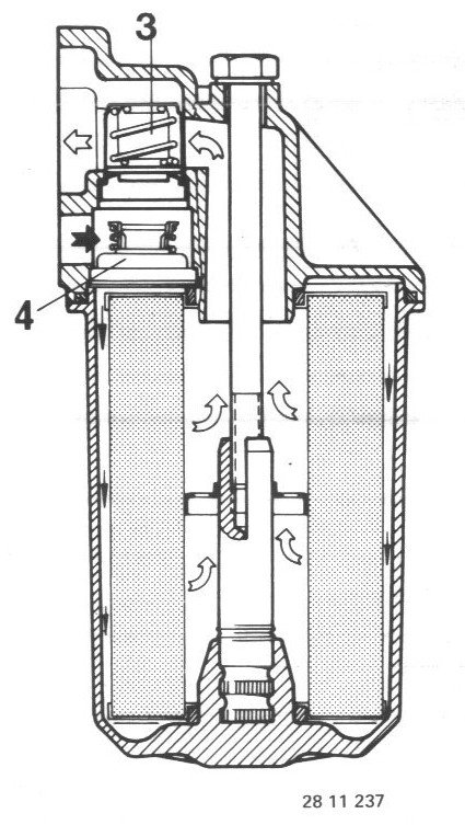

Found these diagrams of the later style and early filter housings.
Note that on the later they added the Return flow inhibiting valve
- opening pressure = 0.1 ±0.05 bar (1.4 ±0.7 psi). Marked #4
I believe the reason for the update was to stop oil from the block and head that is higher than the top of the filter canister to back flow through the filter and then seep past the oil pump (if it has some ware) and drain back into the pan. The equivalent of wet sumping on dry sump motors as experienced on most old motorcycles. Because the filter canister is full it takes less time for the pressure to build then after an oil change. BMW probably felt that this eventually might shorten the lifespan of the motor and made the update. My rational anyway.
The housing is easy to access and hopefully can find a good used one on the net. Will let you know the results.

What you have installed is the best one as far as I’m concerned.
Nothing to change except the hardware the next time you change your oil

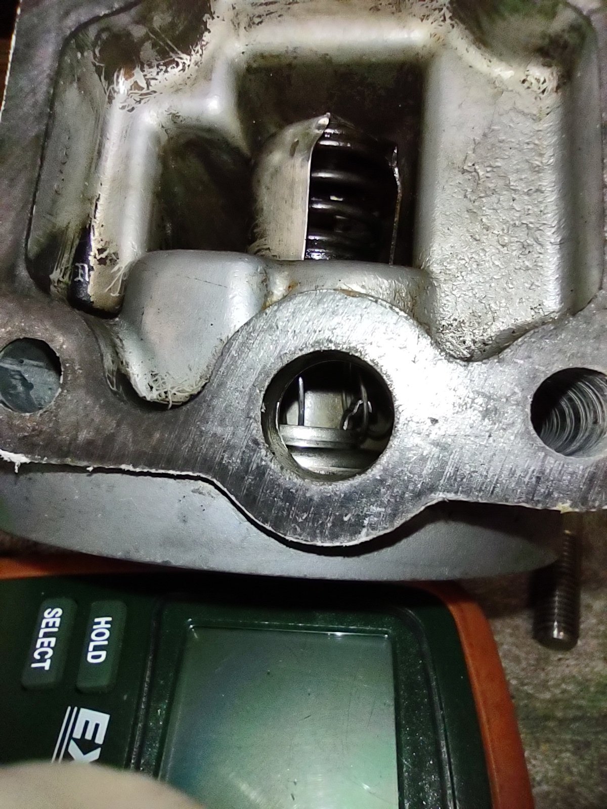

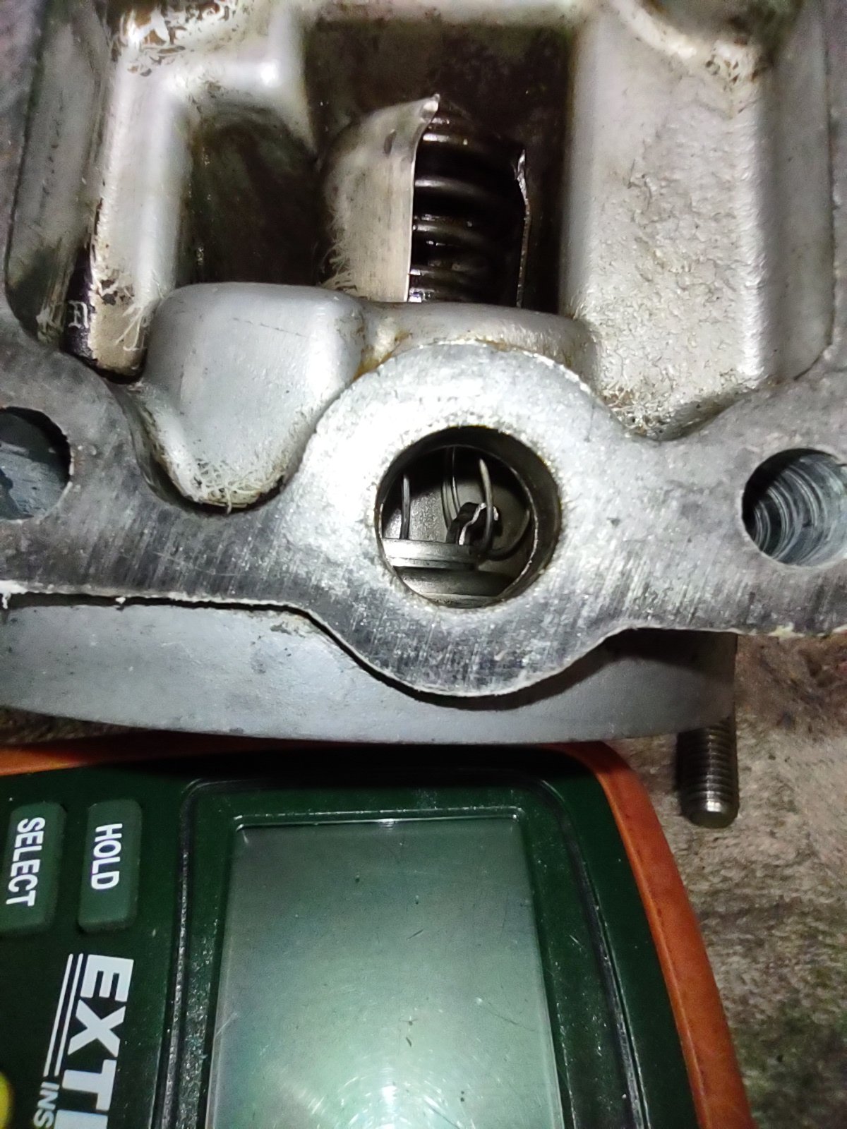

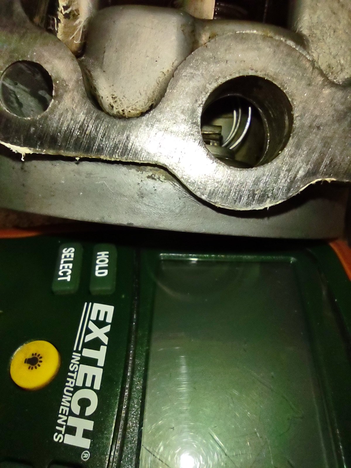

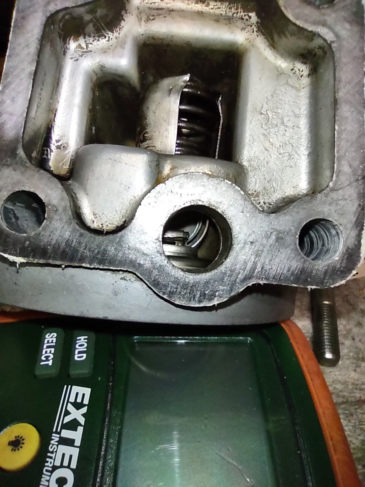

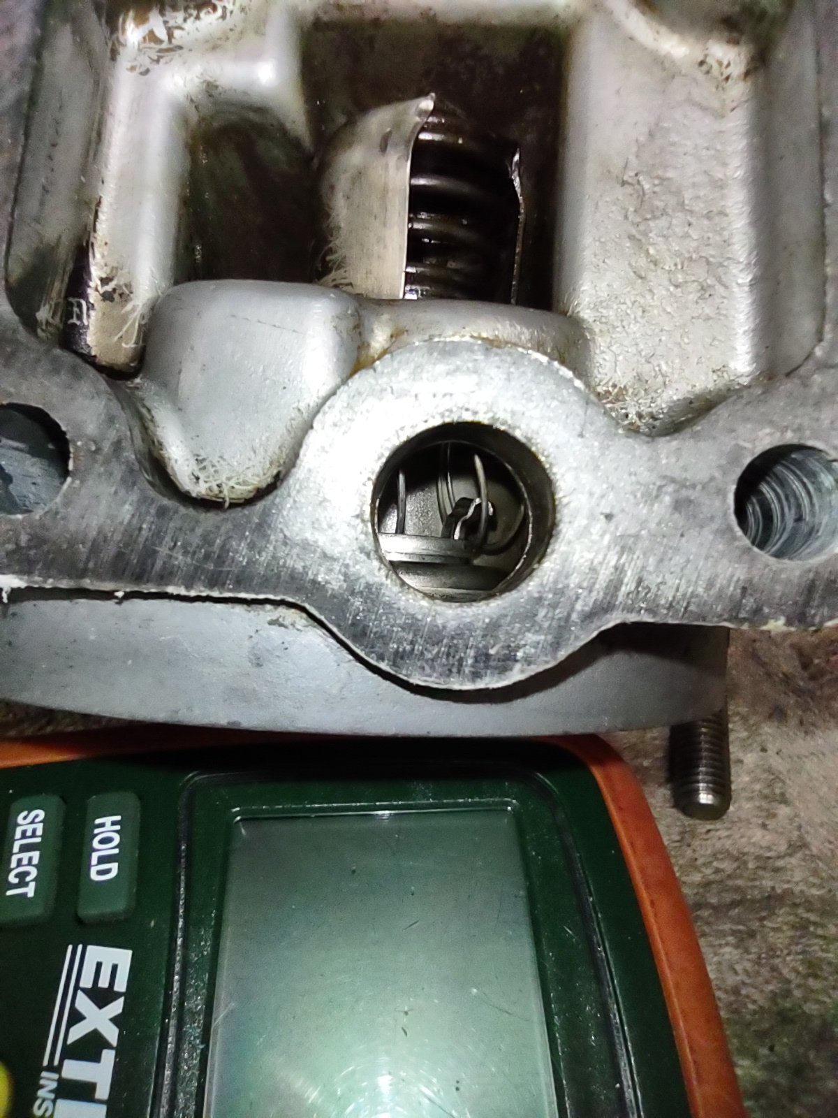

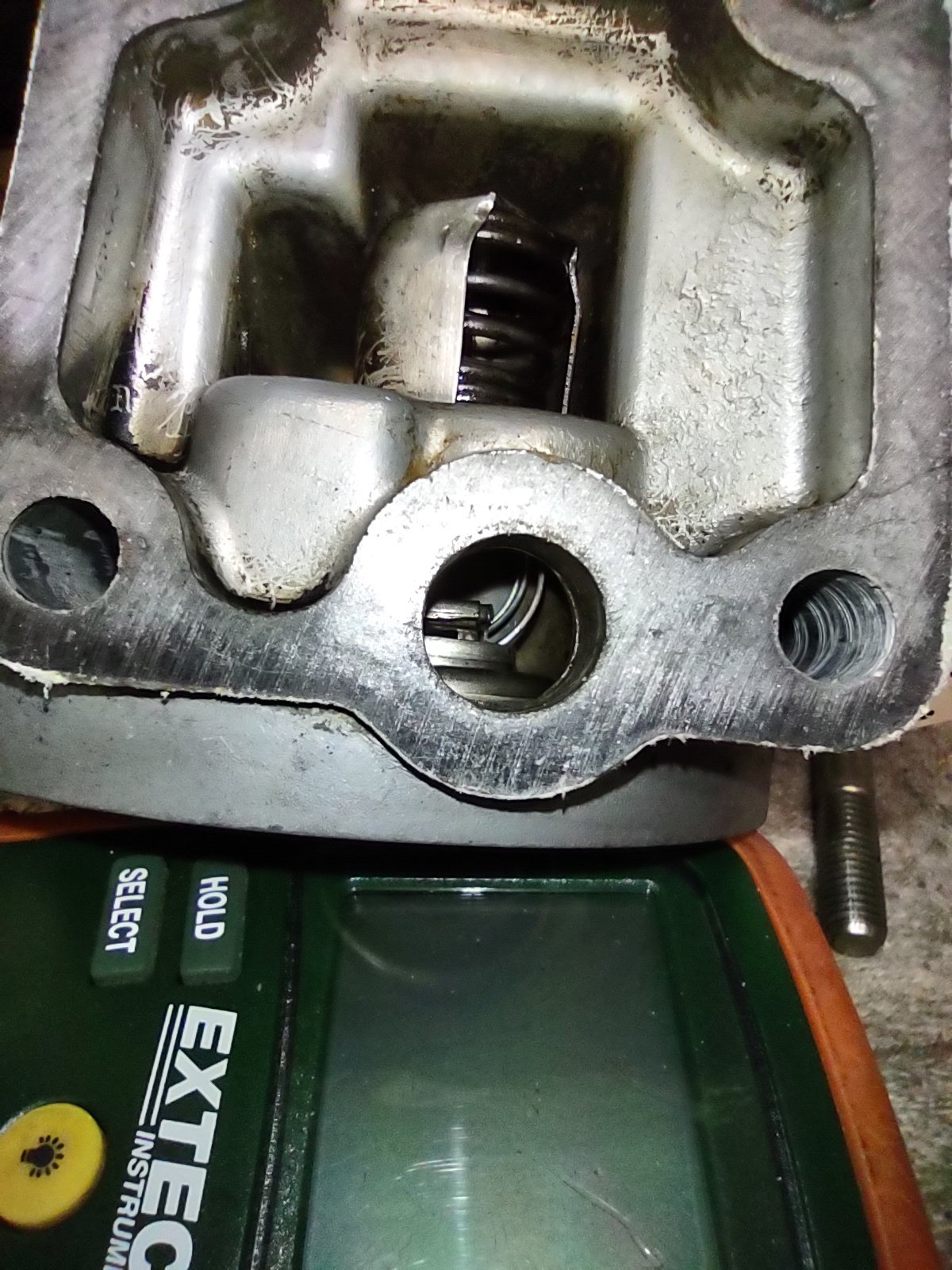

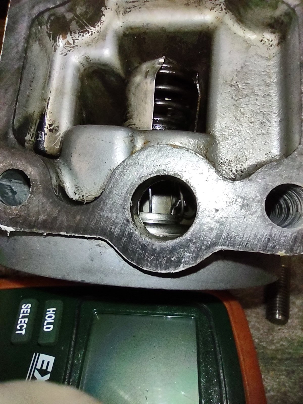

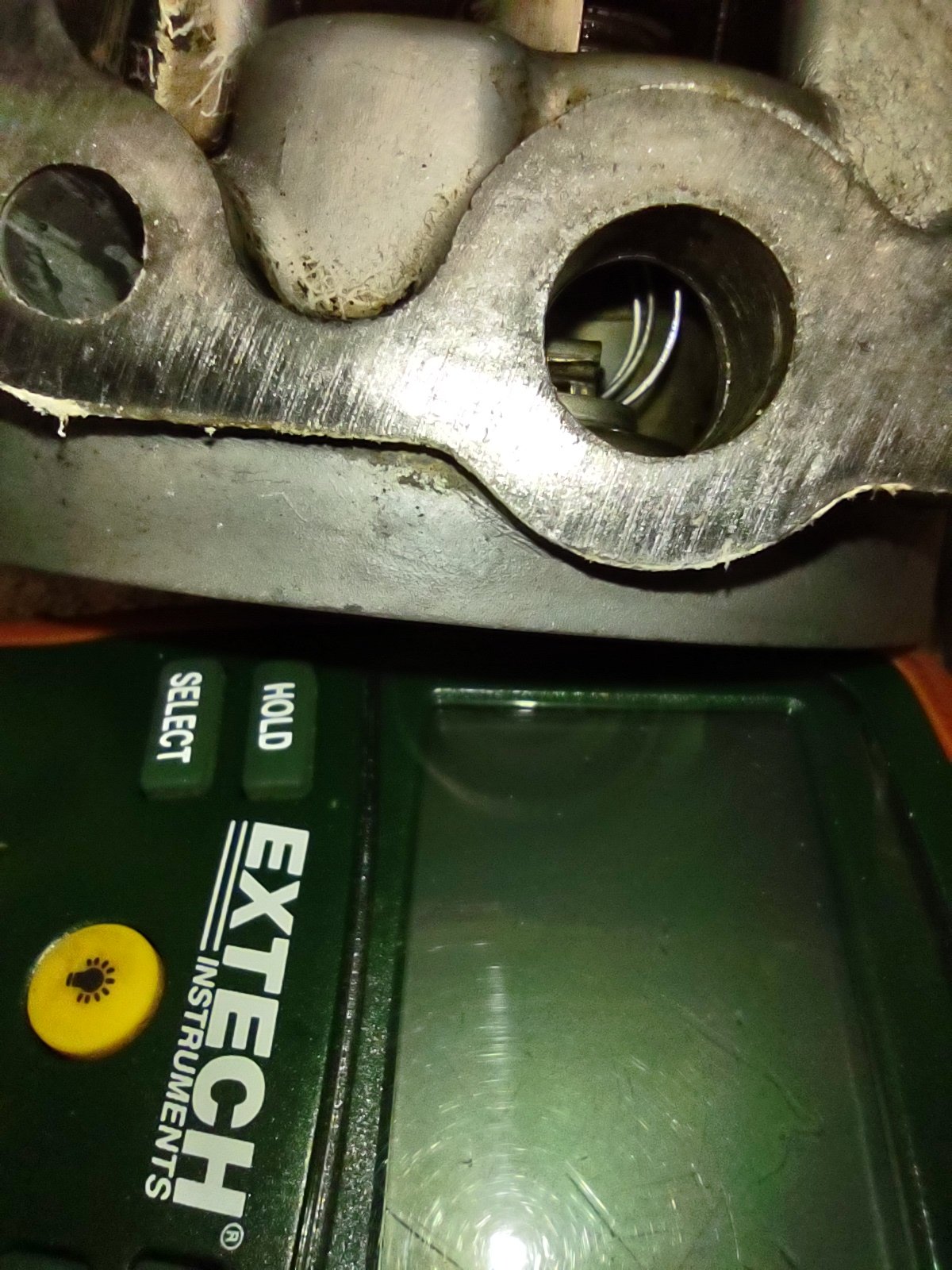

Ordered one on Ebay ad of course its no good. You can see that the spring for the anti-siphon valve has popped off and is sitting sideways in the housing. Look down round port. Looks like this is a pretty common problem.

Ouch
Make sure you return that immediately so you can get your money back
You should reach out to Al Taylor Bavman. He’d make sure you get a good one.
AL Taylor supplied a oil filter housing at a very nominal price. I was a late one with the check valve and deep spring retainers. Seems there are three style housings.
1 - No check valve (What was on my car)
2 - Check valve but shallow spring retainers. First one I bought but spring had come out of the retainer
3 - Check Valve with deep spring retainer
With the new housing if car is restarted with an hour or two light goes out almost instantly.
If car sits several hours goes out in about a second.
After sitting a few days goes out in under two seconds.
Does it make much of a difference? Probably not since we are not putting on hundreds of thousands of miles, but I am glad I went through this exercise and understand what is going on.
