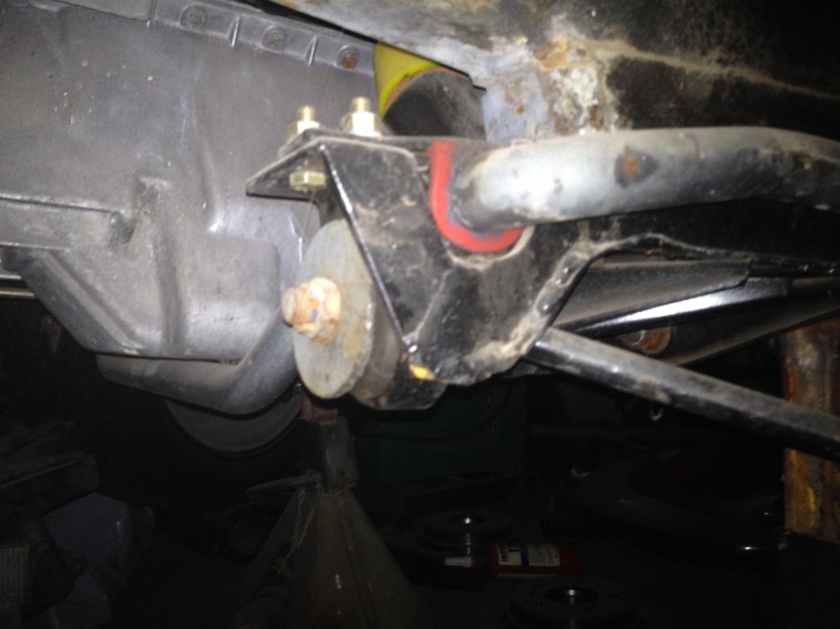

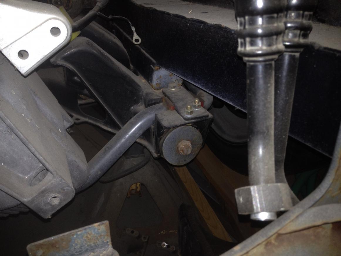

You can use the S38 oil pan and pump but you will have to lower the front sway bar by sinking it into the front frame rails, that will lower it enough that the oil pan will clear it by about 10mm. That's how I did mine, as I'm firm about having a much oil capacity and baffeling as the original M5 had. I have to believe that the extra effort is worth it. Good Luck, Leroy

Sorry…... but I am confused by your description. The frame rails (actually uni-body rails) are above the sway bar so sinking the bar into the rails would actually be raising it. Were you able to drop it into the engine / suspension cross-member somehow ? There is very little distance between the sway bar and the front strut rod bushing. Could you post a photo ? Thank you ~ John Buchtenkirch

Look at the last pictures in this set. The sway bar mounts on top of the subframe.

Sorry about that, I should have written subframe rails. Yes the sway bar mounts on top of the subframe rails, in front of where it mates to the unibody frame rails. Interferance with the sway bar is the only problem with the S38 oil pan. There is even space to mount the engine further to the rear, but then major surgery on the firewall would come into play. If I can get my son to help me I'll try to post a couple of pictures this afternoon. Leroy

sway bar pics
Here' a couple of pics of how I did it.
