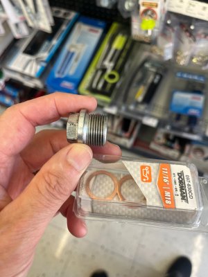

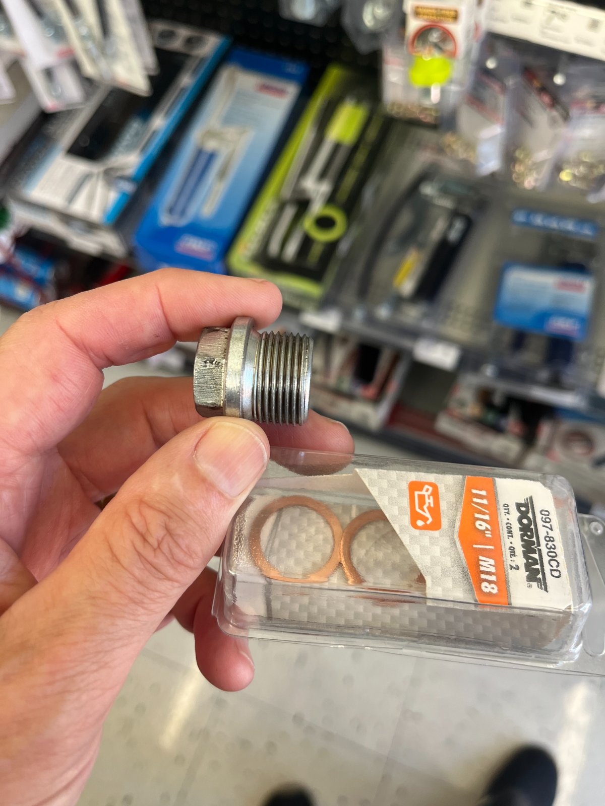

I am changing oil and when I pulled the plug it did not have a crush washer. Its 22mm. Do I need one, I cannot find it readily available. Have one on order from Orielys but not in stock

i would always put one on, it helps prevent drips. i have always heard you should replace it every time you do an oil change
58 cents from getbmwparts.com - list price is 69 cents ... go to your local dealer + buy a couple ... least expensive part you will ever buy there.
bmw part number is
if you really want to freshen things up, get a new drain plug 12.56 - same as 2002, e3, e9, e12, e21, e23, e24
11131250089​
