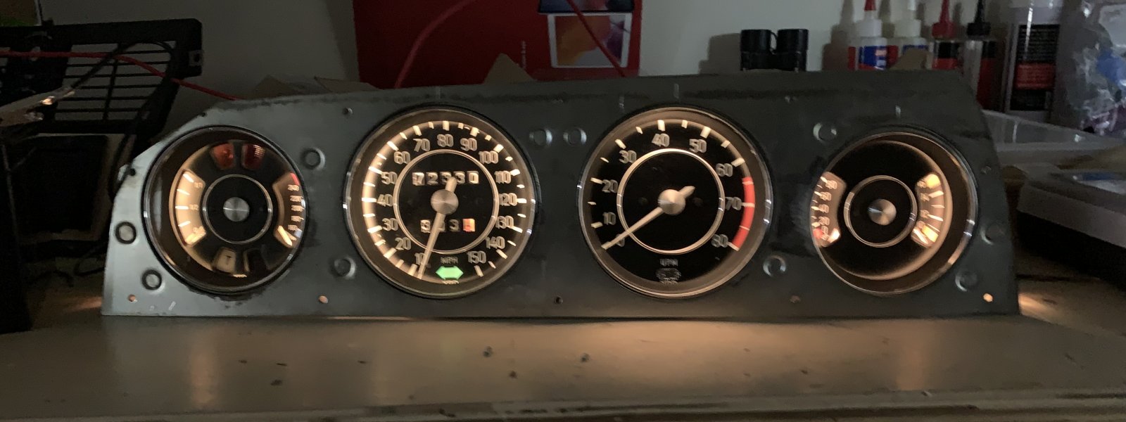

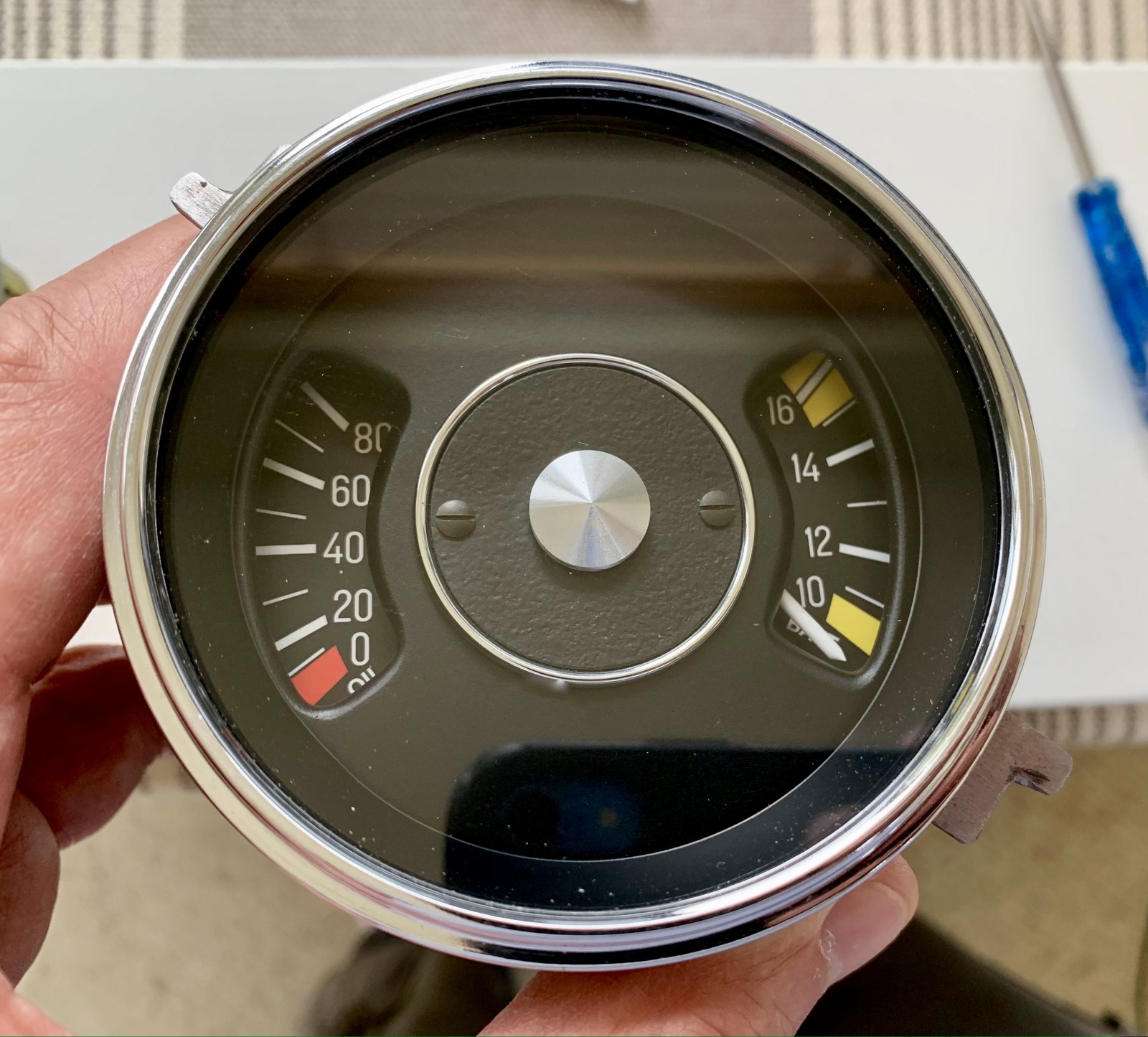

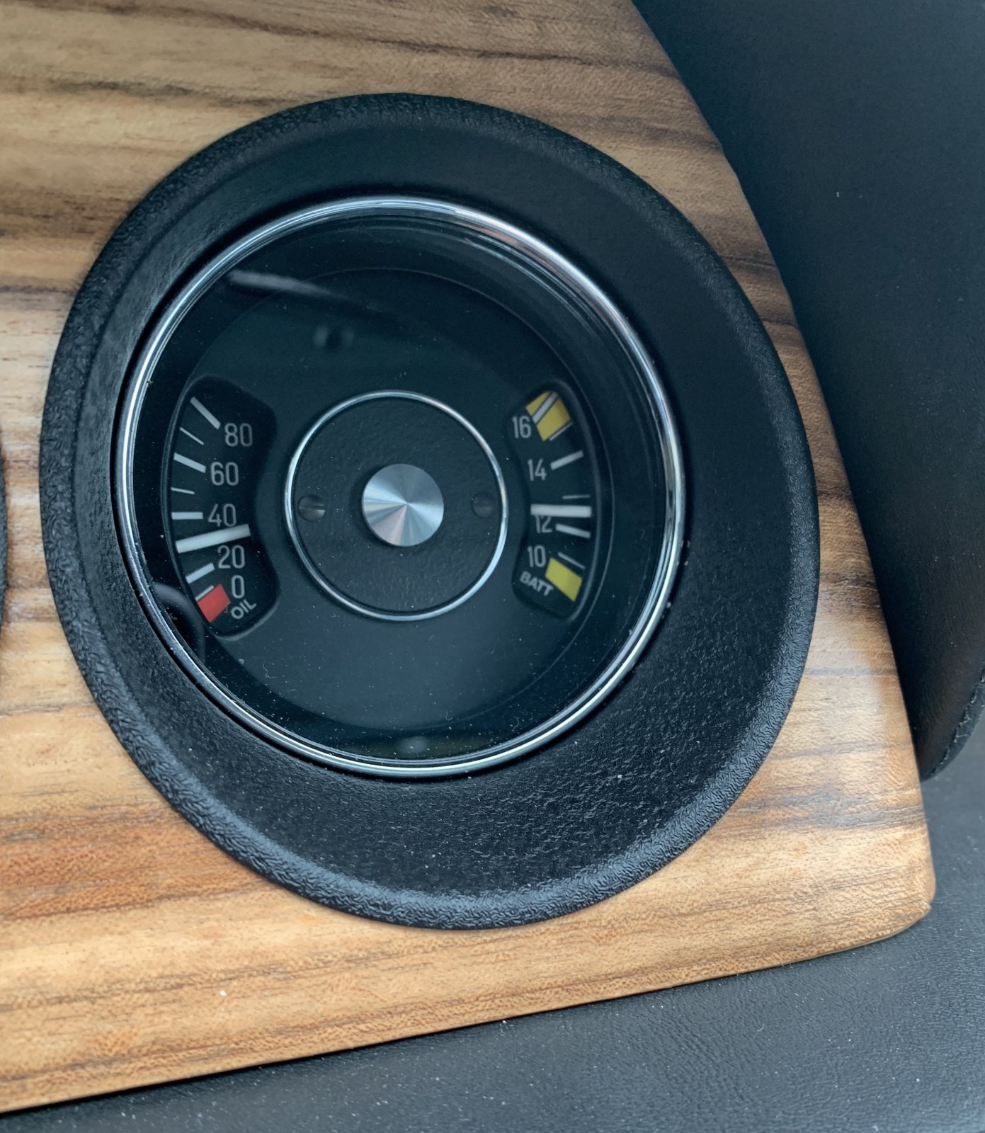

After many months (years?) of r&d, I finally realized that this mythical gauge idea, originally started by @paul cain had no cheap and easy way to get made. Paul had mentioned that he had his done at North Hollywood Speedo but the guy who had done it originally is MIA and they are not interested in pursuing it.
As mentioned elsewhere, I tried to adapt some Porsche gauges but it never looked or worked right. So I decided to go back to square 1 and build it right. It does start with a Tank and Coolant unit but even the housing has to be modified quite a bit to work properly. I had all of the guts replaced with brand new VDO coils, made a new face and had the marking designed with as close to the original style as possible. Then lighting was adapted to work with this new gauge setup.
This ended up being far more time consuming and far more expensive than I had imagined but I have to say I am pretty happy with the results.

I have not added all my cost to build one yet. But I do know that it is not cheap. Just the cost of having brand new VDO coils installed by a specialist inside those mini gauges and calibrating them is very significant. And there is quite a bit of labor involved after that.
I will let anyone who is interested know in a few days.
