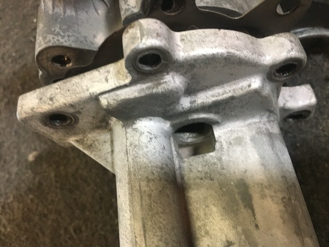

So my engine got new parts, it is restored and we wanna assembly it. I could purchase all the requested parts except the original oil pump. It works well, clearance ok, but we found small cracks on the triangle part, that holds the sprocket with 3 screws (pic) We don't wanna take the risk to use this part so I need to find the solution: buy a new, or a used one that has this part without cracks, or to buy spare parts somehow, or to install another type that will fit...

I preface this by knowing nothing about this part. Can you remove it and have it repaired? In situations like this, I should say in exhaust situations like this, I have brazed a washer of similar material to each opening.
If I don't find other solution, yes, I have to repair it. A good specialist maybe can weld it and cut a new thread on it but somebody has to put it back professionally, because it was tightened by temperature - if I know well. Otherwise it can lose its tightness and the oil pressure can go down to zero... Wouldn't be good :)

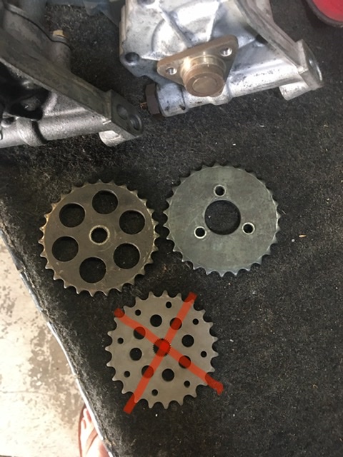

what you have there is the early style fixing for the sprocket with three bolts, that was changed in later versions for the central threaded fixing with a selfblocking nut
first, i do not see any problem in installing that one again except the fact of the bolts coming out due to lack of fixing torque, maybe you can use some loctite on the threads or better install studs and then use selfblocking nuts to fix the sprocket to them
second, if it were my car, i do not think there is any problem to remove it and make a new one, of course you will need to use a tight tolerance to install it using heat, a press or both
good luck

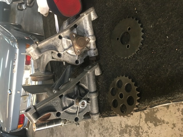

Throw it away...
take the front part of the pump off and toss it.
take the front part off a later pump and bolt it up
Make sure you use the matching gears and chains depending on the gear
relieve the shaft hole if it binds.
This just took 10 minutes- super easy

If you do want to use the later smaller gear- prepare to shim to fit and have the right chain.
chains come in 46 and 44 link
thick shims can be found on ebay sometimes.

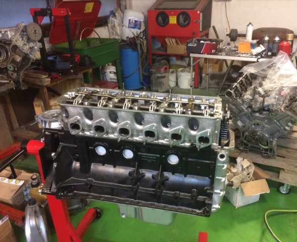

We started to assemble the engine
but would be good to find a good, simple way to set the timing chain and camshaft in a good position. Any tricks, advice?
