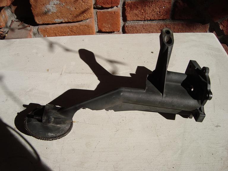

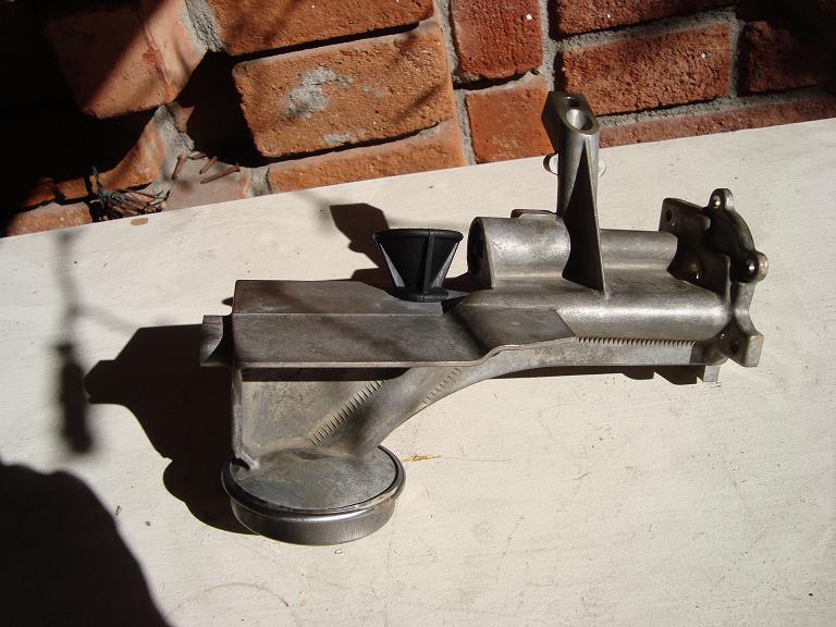

There was a swap to a new oil-pump (actually it's just the pickup) and oil pan in June 1971 since the old oil pan didn't keep the oil in the pan when cornering hard through a right hand turn - hence a new design oil pump became necessary to go with the new pan.
