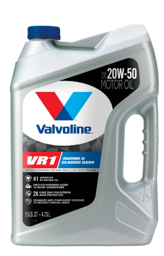

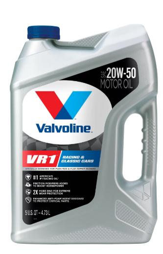

Valvoline VR1 20w50 has zinc

I started with VR1 20W50 high zinc, but my last two changes have been VR1 full synthetic 20W50 which also has the high zinc content.. There have been no leaks with the synthetic, which is purple
I drive the Coupe 3-5K miles yearly, with oil changes at 3K.
The synthetic purple is almost twice as expensive as the amber oil. But our cars are worth it.
