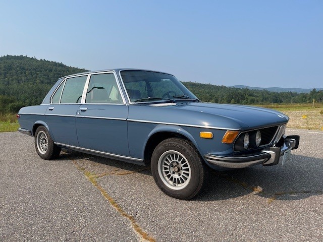

Here's pic. I'm finally winding up a 9 year restoration project.
