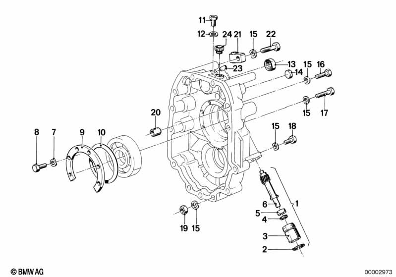

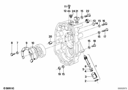

One other thought - I transferred over my speedo drive shaft from my 4-speed to the 5-speed. I alternatively have read that this is a challenging vs very easy process. In my case, i undid one retaining bolt, pulled out the drive and was able to just insert it into the 5-speed and secure the retaining bolt. It's been a few months since I did this so I don't have a perfect memory, but in looking at the parts diagram for the speedo drive, there is an O-ring and a spacer. I know that I ordered a new shaft seal (part 23121490192, labelled part 4 on the image below) as well as a new O-ring (part 11431740045, labelled part 2) because I can see both of those in my FCP Euro order history. That O-ring is called an oil dipstick tube O-ring on the FCP Euro site - I suspect it shares a part number with the ring on the oil dipstick tube. I'm half suspicious that I still have that O-ring sitting in a plastic package in my bag of parts because I seem to remember looking at it thinking "why did I order an O-ring to re-seal the oil dipstick tube? I don't need this!". When re-assembling I tried to follow the schematics fully along the way, but perhaps this was one that got missed. In which case this is a classic example of putting things back together and having one extra part left over. But yes, that's one more hole in the transmission casing that I hadn't accounted for above and another place to check...
