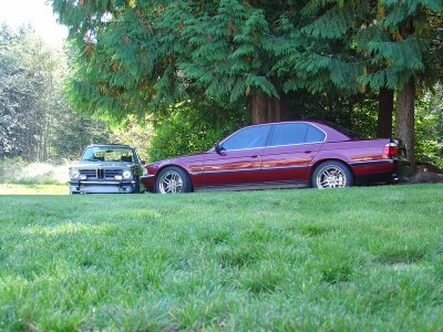

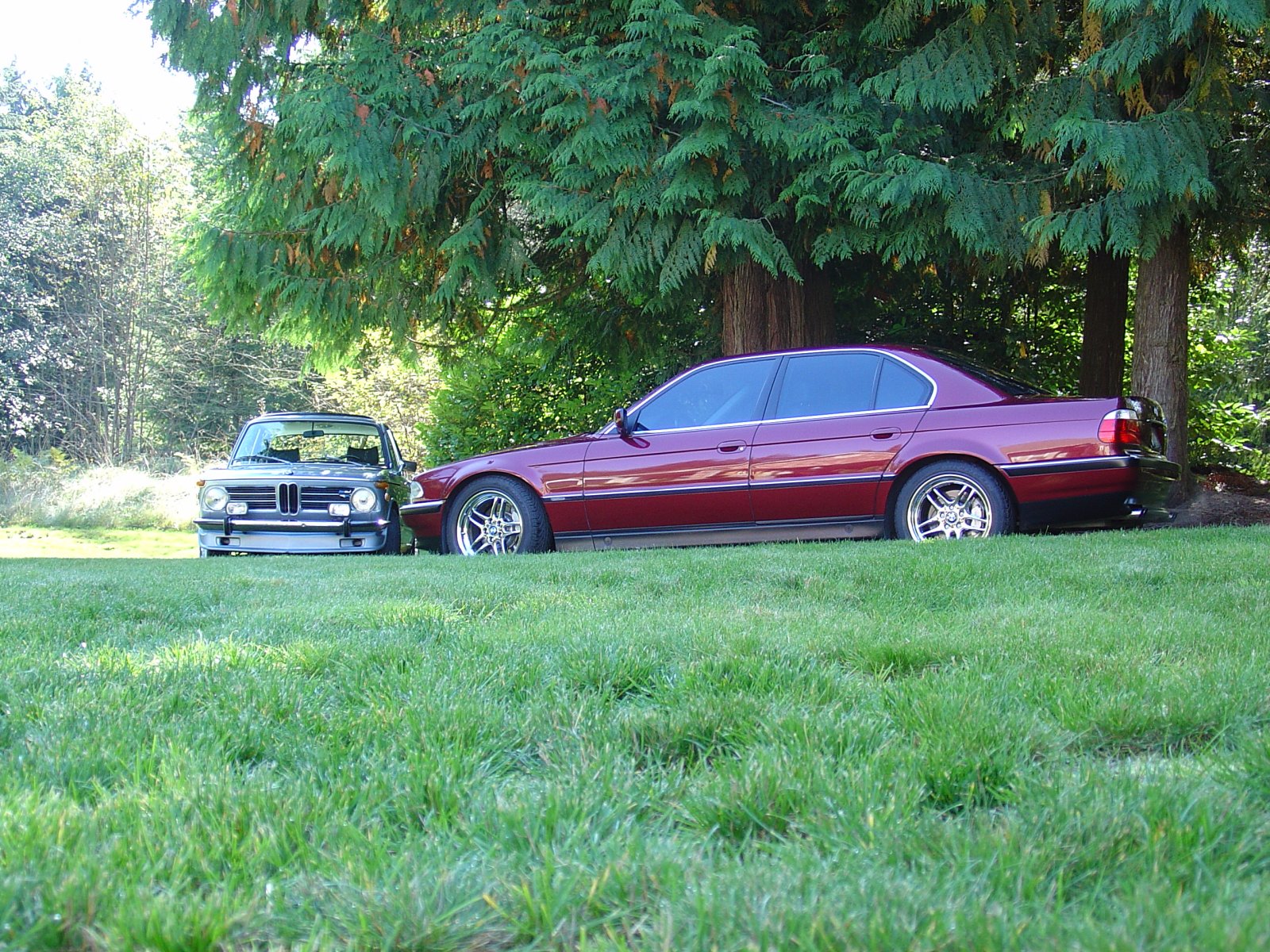

On a side note - Here is a pic of my first E38. It was earlier bought by a friend of mine from a local BMW dealership (as a used car) knowing it had failed the leakdown test so it would get a new short block. It was a first year E38 (1995) 740i (short), so no 'sport' package was available at that time, so - he built his own. LOL
He put a limited slip differential in it, lowering springs with sport shocks, M-parallel wheels, SSBC brakes in place of the original, a shift kit for the trans, chip in the ECU, Eisenmann exhaust.... All in Calypso. FUN car.... Really fun.... There were aspects of it that were a bit 'too much' for me - but all in all, was great. He had a business change and he needed to move to a place more appropriate for a truck (plus he had several other cars) - so when he let me know he was selling it - I pounced on it.
I had no intensions of letting go of that one, but... My dad bought one of the very very last E38's available in California. My dad bought it the day before the E65's were to arrive at the dealership. The dealer was under orders from BMWNA that no NEW E38's were to be on the lot when the new E65 7's arrived. So - he got a DEAL on that one (plus it is a friggin awesome car anyway).
After my parents passed away - that 2001 iL came to me. I had both cars for a couple of years but then realized I needed to let go of one. As much as I loved the red one, the dark grey iL my folks had was special. So... that is the one I have now. I have sunk a fair bit of $$ into it to keep it in top shape, but... will probably let it go in the next two years.
See below pic of two of the cars I don't have any longer. I miss the E38 - but I never should have sold the 2002. LOL
