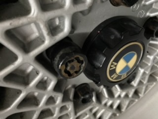

I have a security nut on the wheel but missing key. Removal strategy needed.
Is it the BMW locking style or the squiggly lug wrench key? Squiggly lug wrench ones can be spun off by a tire shop.

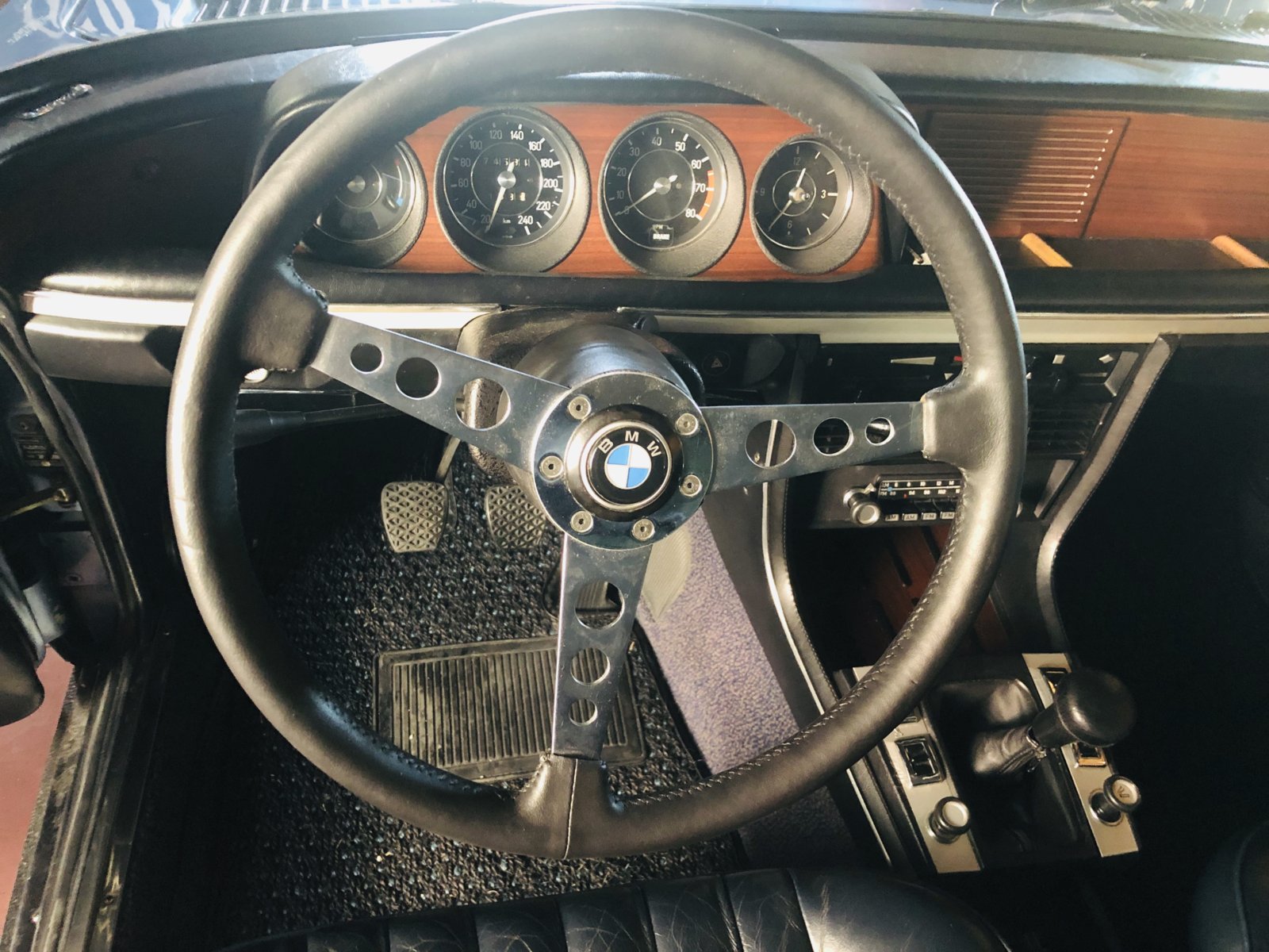

Did the Petri tri spoke steering wheel ever come with wood?
As far as I know the stock 3-spoke wood rim steering wheel was made by Petri yet is not the Petri people want.

Lock looks like a squiggly.
I love the petri look. Keep seeing it in photos but none for sale yet.
Yeah, that wheel lock can be spun off with a pounded on socket, there's also a socket with pins inside to remove this easier. May need to pay a couple of bucks to have a shop remove them.

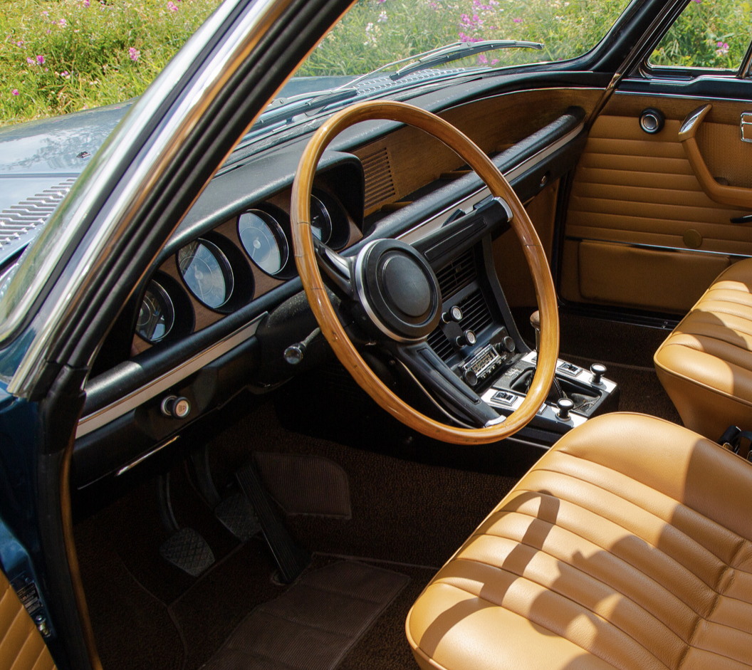

So you want the wood rimmed CS wheel? I have a few of those, yet need to be re-veneered as they are rough.
This is the usual Petri people look to find.

Welcome! Before getting creative with the wheel lock, take it to a tire shop. They usually have most of the common wheel lock keys handy.
If not, you can just buy a 19mm black oxide nut. Have it plug welded it to the face of that lock. It sounds complicated but would take a fabricator more time to setup the machine than it would to do the work.
Any off-road, hot rod, or metal fab shop can do it. Hot rod shops will cost the most. If you go to a car place make it a 3/4 black oxide nut to match their SAE tools. Pick up a set of new M12x1.5 lugnuts.

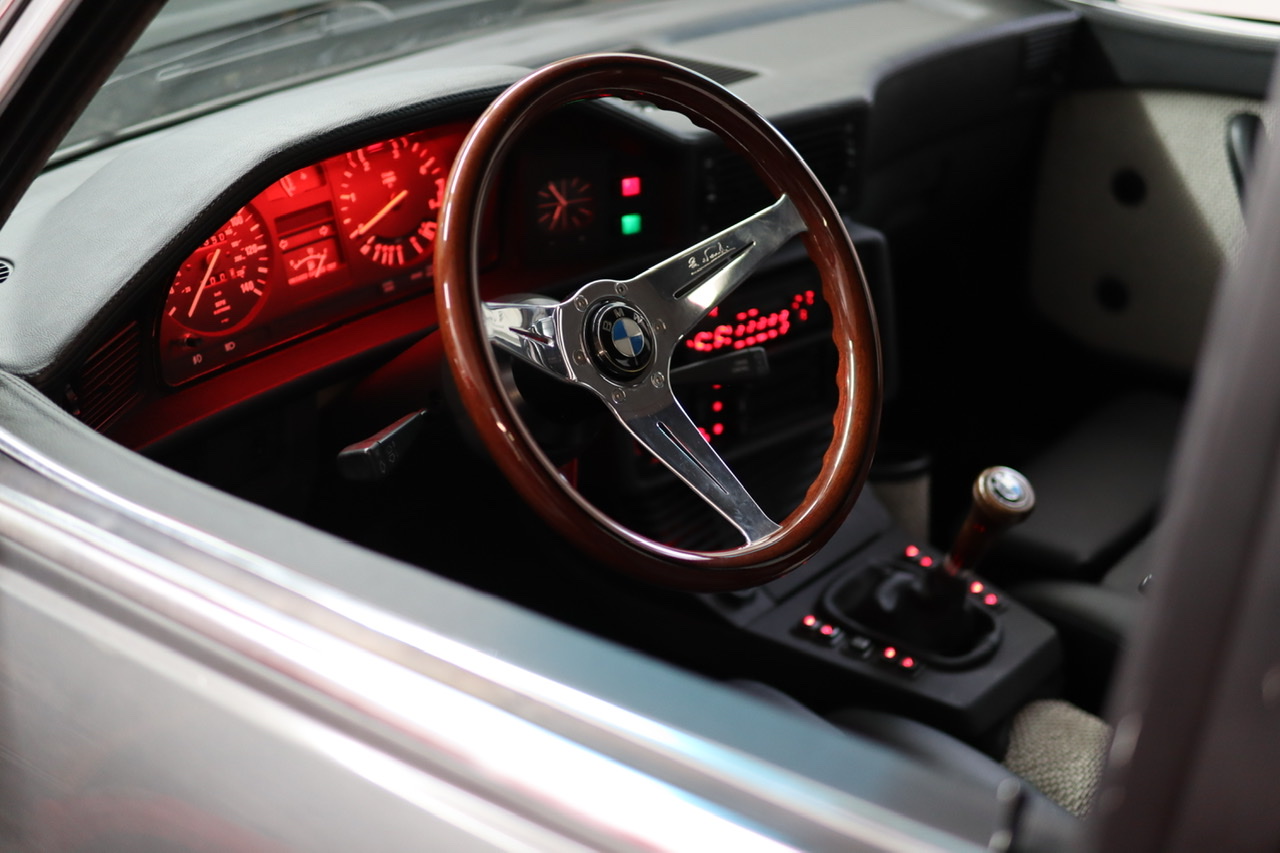

Take a look at the Nardi wood wheels. My favorite.
Love a good Nardi wheel too. I have a deep corn Nardi when in the 5 series. Was also considering swapping it over to the e9 but the stack up is too deep.
