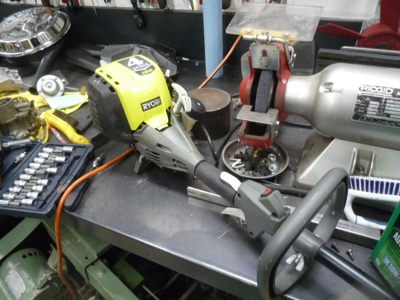

Walking to my car yesterday I happened across a snow covered object in the garbage that caught my eye. A Ryobi weed wacker that was missing the wacker part.
I could not leave a 4 cycle motor to be mixed in with the diapers and refuse, so popped it in my trunk. Once home I google "What can you do with a weed wacker motor"

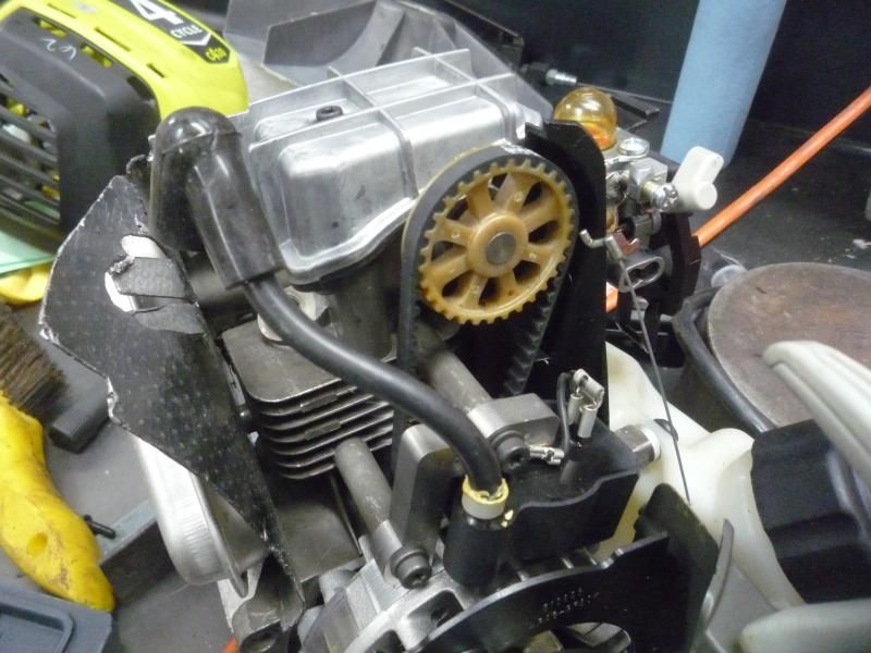

Stripping the plastic off my wacker, you find a sleek 4 cycle overhead cam single with integrated gas tank. It weighs 5.5 pounds with gas and oil.Displacement 31cc…should be plenty to send a 185 pounder to the hospital with either a ripped off Goolie when the crank goes through the case or a concussion when I fail to stop for that bus because I can't lose my momentum.
I fiddled with it a bit, (it had no oil which was worrisome) added gas and it fired up and ran beautifully…with crisp throttle response.

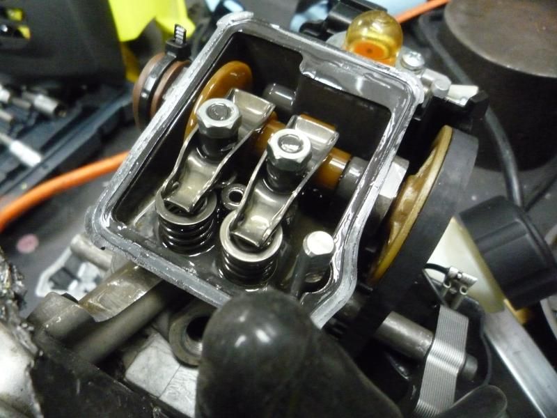

In 5 miles, the gas tank fell off and the fuel lines were not right and a bolt holding a bearing in also went awol. Took it back to the shop, spilt some of my gas, changed a few things, remounted the gas tank, new fuel lines, new bolt, and back to the gas station. This time it took 18 cents to top up. I then headed to my friend's house down a long hill and at the bottom it was running very poorly. Hmmmn, might be an ignition issue ( I was welding with the ignition module attached ) Carb? took it apart and didn't see anything wrong? Valve clearance looks good. Well no, rigged up my compression gauge to it today and it only has about 50 psi compression. I think the Ryobi is done and my prank on my friend is on hold for now.

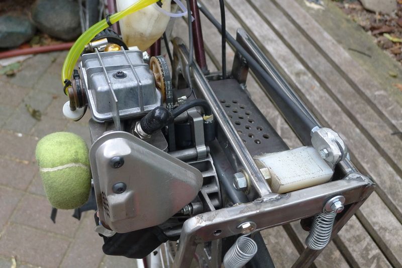

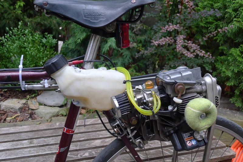

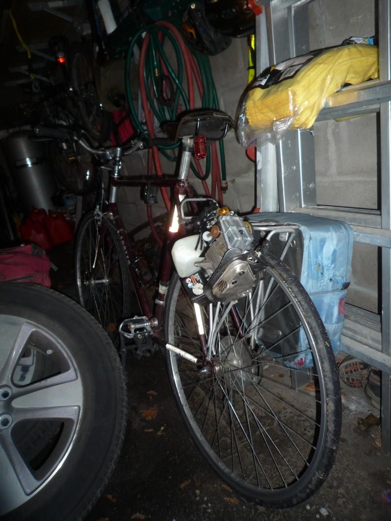

Side view

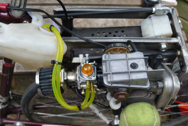

The tennis ball is to protect the motor if it falls over, made the air intake out of a VR6 Corrado breather and a cheap socket welded to a cutout plate.

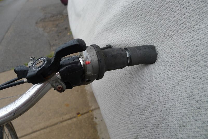

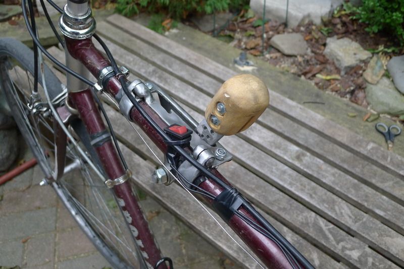

Throttle is a twist shifter from the used bike store $5. Locks full on !!
Motor engagement. I am most proud of this part and it works like a gated shifter on Exec Malibu's Dino. Piece of bent steel and made the hinges out of two nuts and bolts that were welded and shaped. Kill switch is still looking for a permanent place to reside
When you pull the lever it is hooked up to this nylon cam at the back that pushes down on the plate the motor is mounted to. This pushes the drive spindle (A 1.25 " BMx peg) against the tire and off you go!

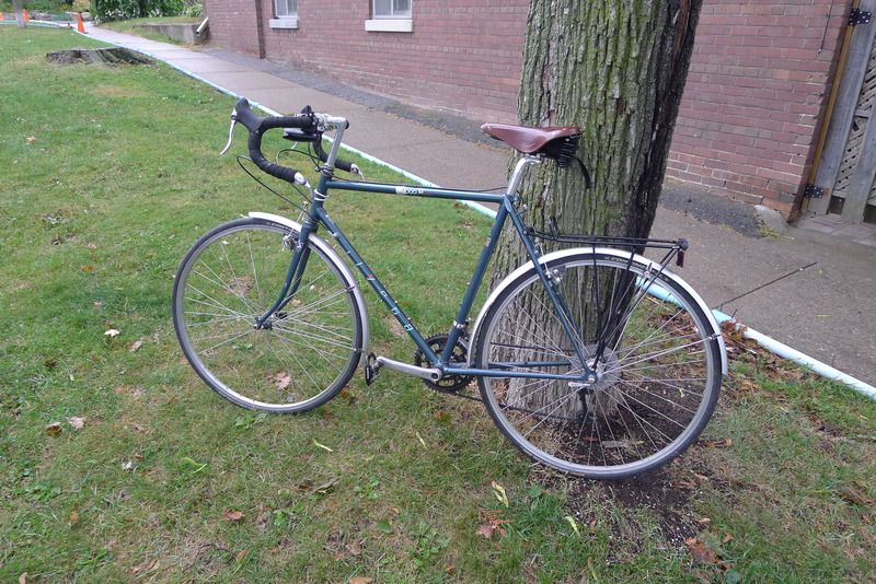

The best thing of all is it justified the purchase of this 1991 Miyata 1000 LT, which is now completely set up for long distance touring. If all hell brakes loose I can hit the road and live out of waterproof saddle bags.
