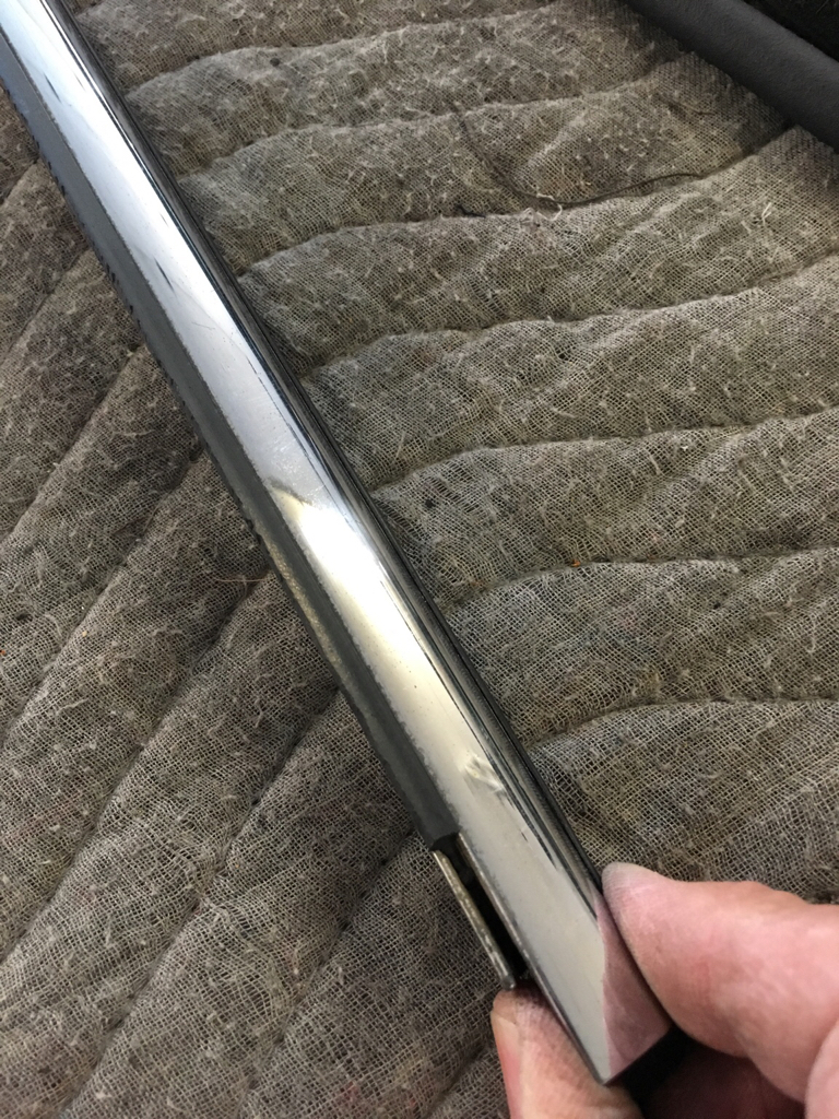

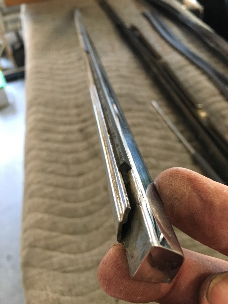

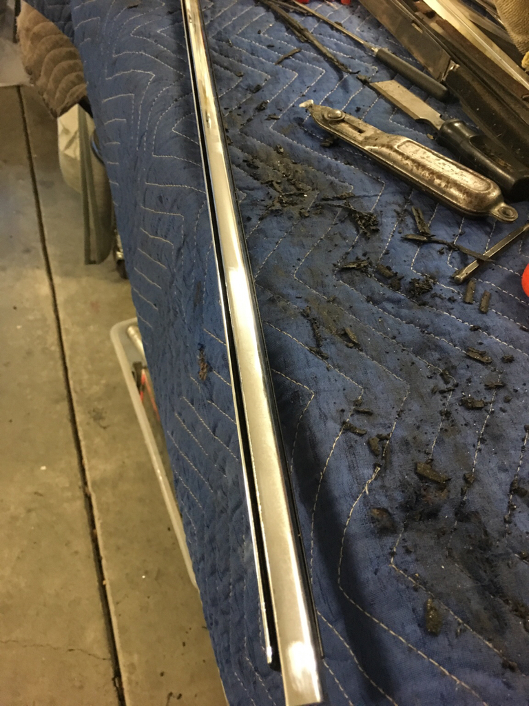

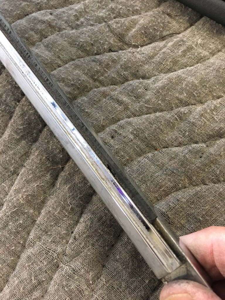

I have new rubber coming so I want to remove and install the rubber piece. All advice is welcome.
Here's some pic's
Thanks as always
Barry
I watched a master do this, you can't slide new rubber in, push it down with plastic blade like they make for removing chrome trim with lots (!) of lubricant. On a 2002 you can spread the metal a bit, here not so much. Make sure it's a bit long, it eventually shrinks.
