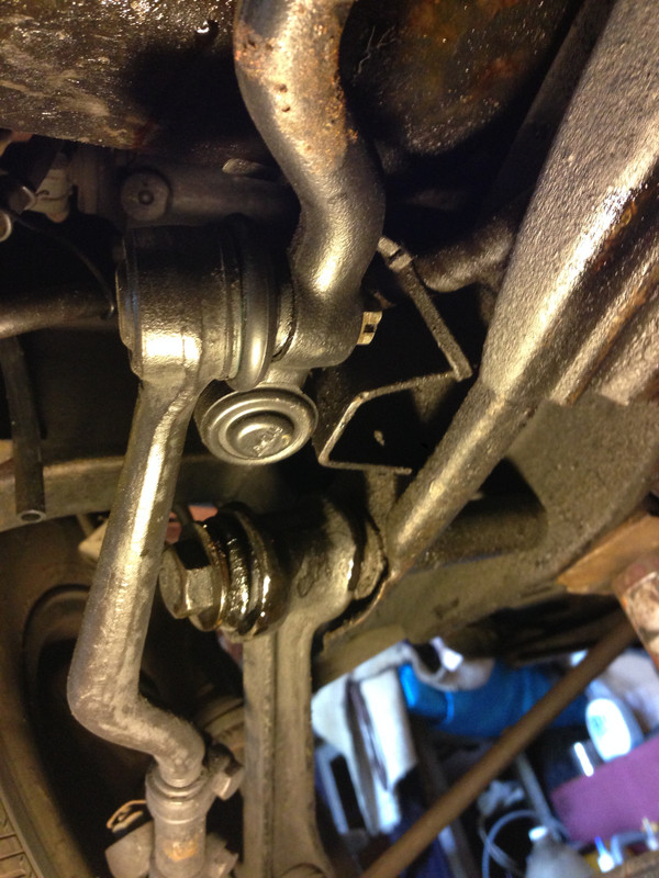

Below is a picture of my good left tie rod. As you can see the tie rod is curved to clear the lower suspension arm pivot bolt. The E12 tie rod is curved in the opposite direction and would be in contact with the bolt. This position is a worse case full lock turn on the steering with the car off the ground but it is pretty obvious that it is risky to use the E12 tie rod. I am pretty sure the E12 part would work OK with the car on the ground but caution would need to be taken when lifting the car or going over big bumps with the steering turned.
