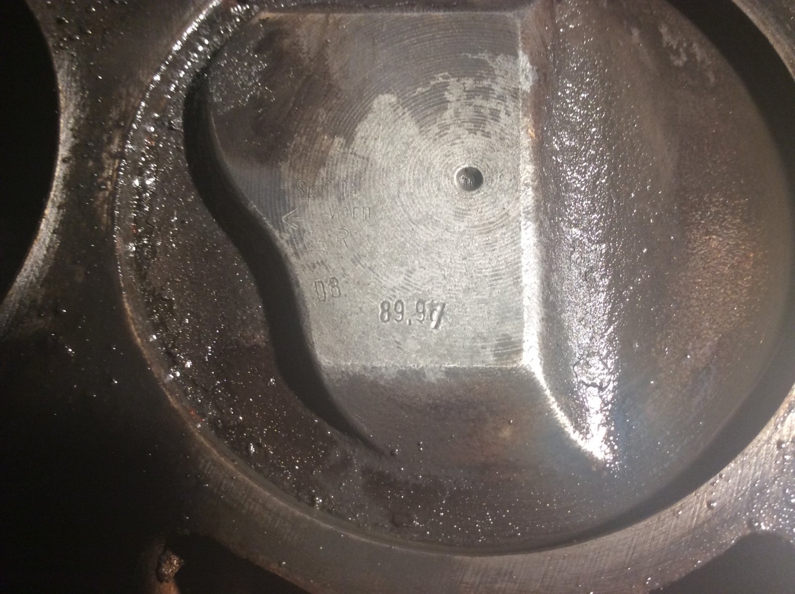

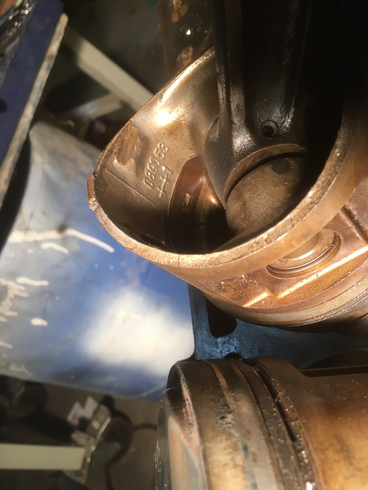

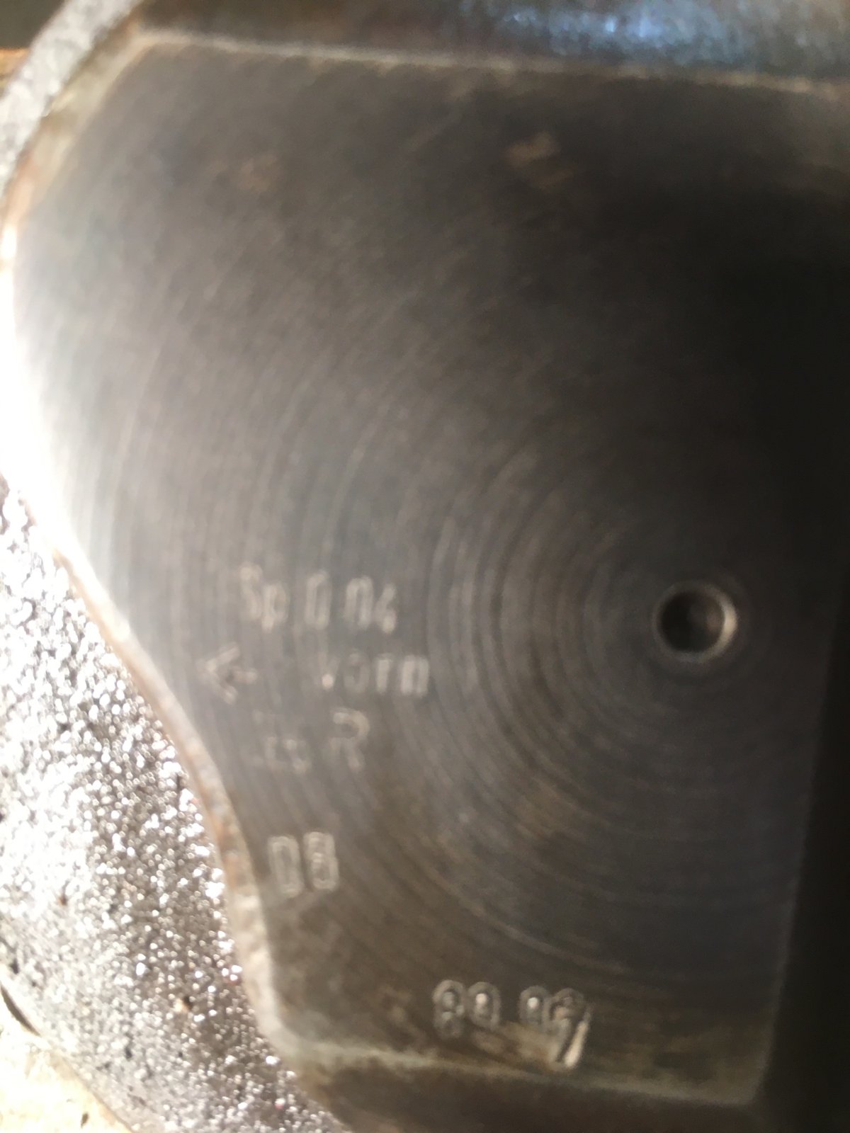

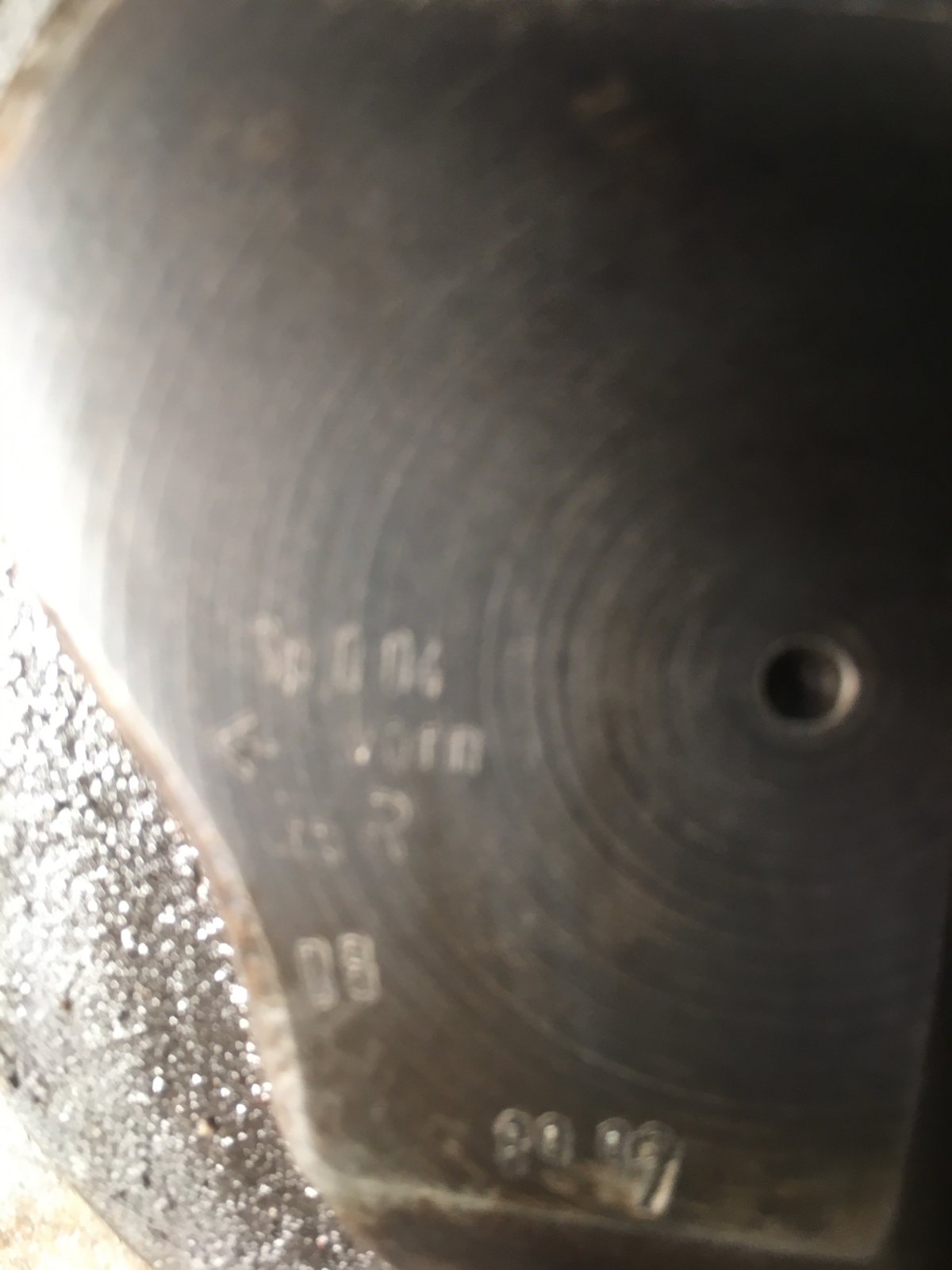

Can any one tell me if these are over size? If so what are they?

ok, 89.9..mm where pretty standard in ti & tii 2002, that was my first thought.
In that case pistons might be from 3.2 csl engine 3,153cc

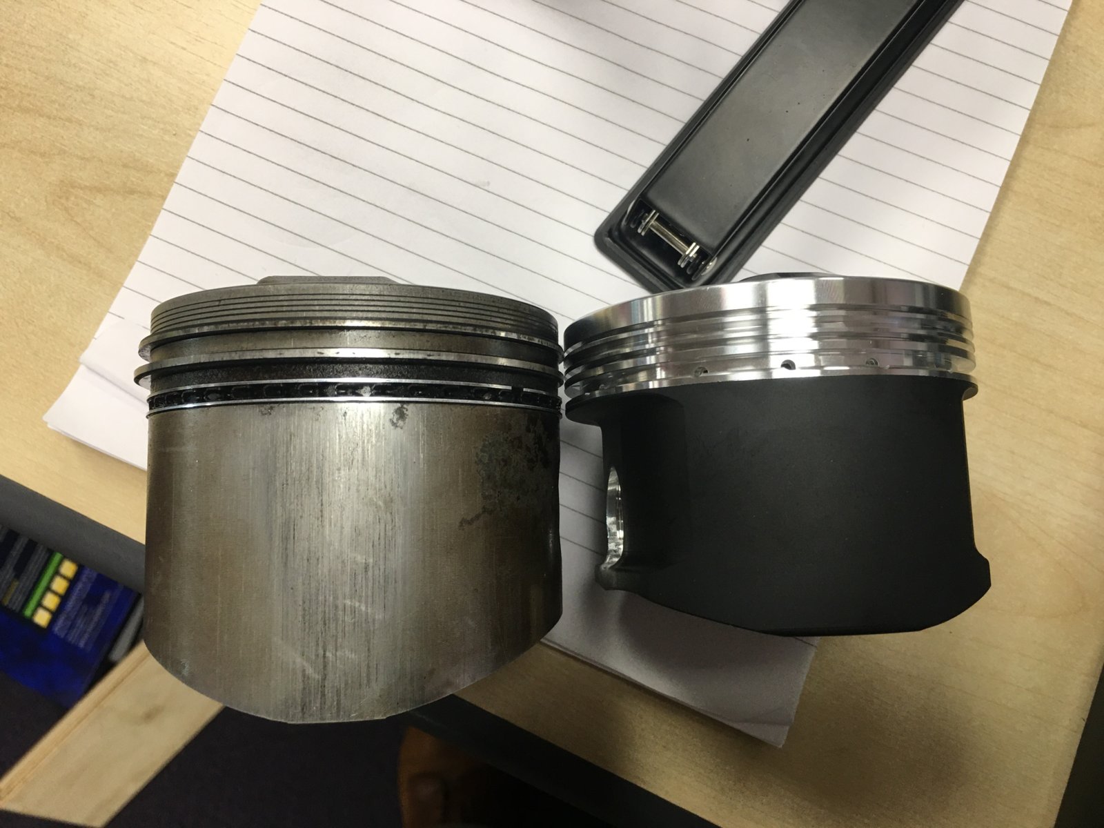

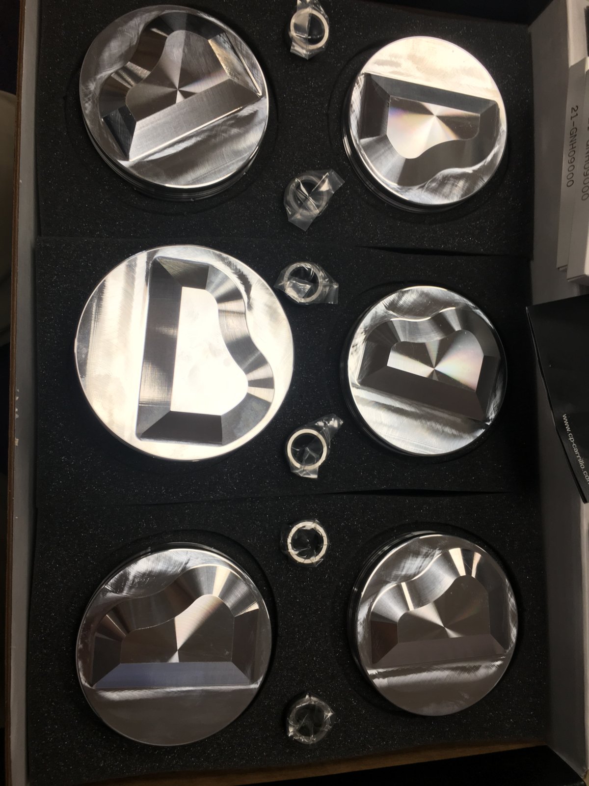

Anyone know where I can get pistons and rings or even just rings?.
you cant get new pistons oversize - i had them made and they are cheaper than buying a set off the net if you can find them..
the company has drawing for them so you just need to tell them what size you want
i paid £360 plus vat last year for al 6 - i also got the skirts to the piston coated -- these are the guys

no longer available from w&n
