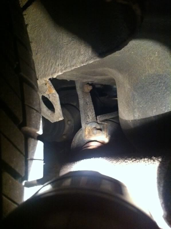

One of these hangers started cracking on the rubber and was well on its way of breaking completely. Probably too much weight of the exhaust that is straining on the thin rubber of the hanger. Decided to put 2 hangers back to back (one side of hanger is flat) on both ends the rear muffler and they have held up very well with not cracking of the rubber yet.
