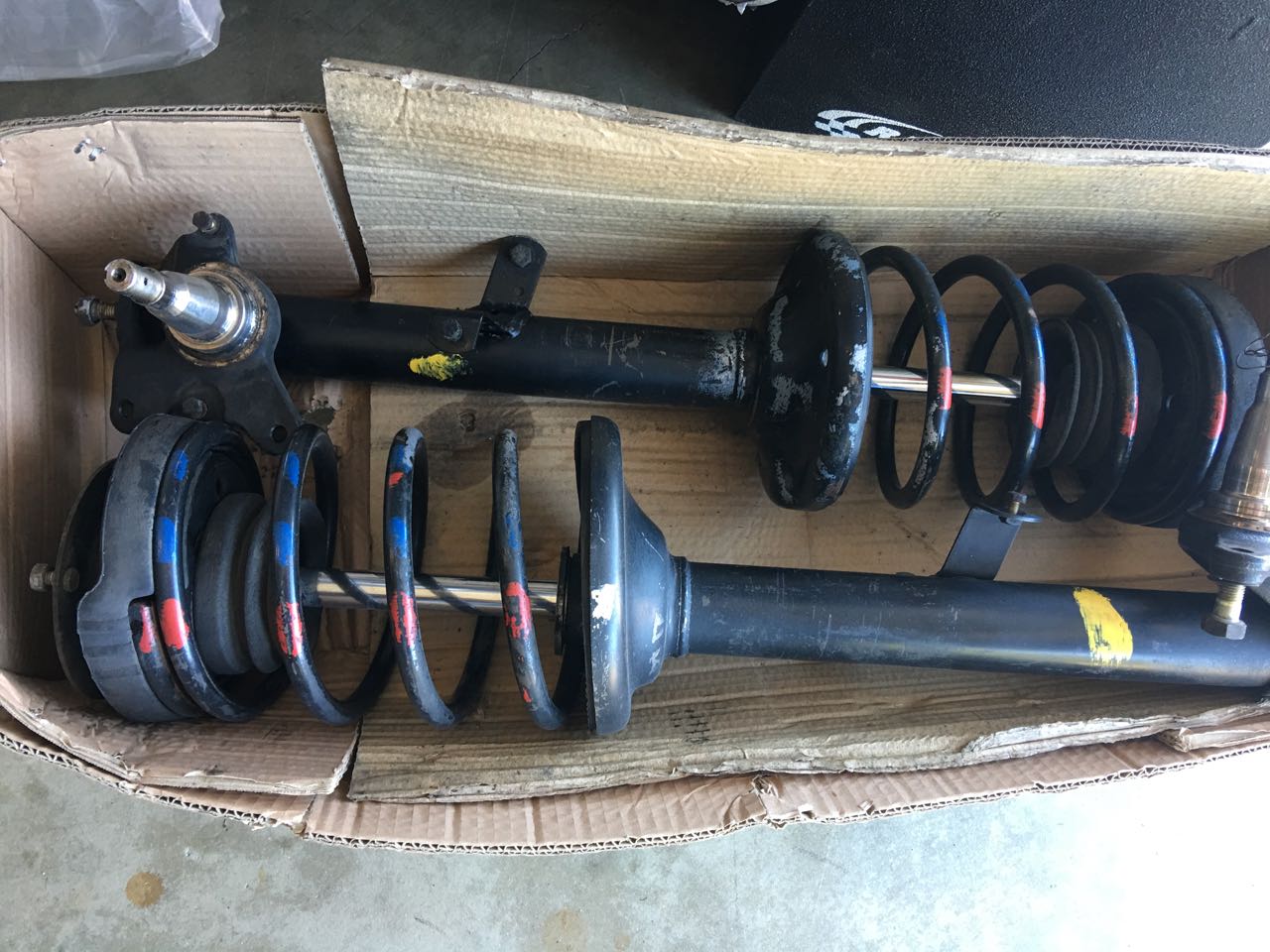

Hmmm, I noticed that mine had several markings as well, not only on the spring but also on the strut housing. A big yellow one and a smaller white one on the spring perch.
And the springs seem to have two blue and one red stripes. I always thought these were added later by a previous owner. Would all of these be original markings?
