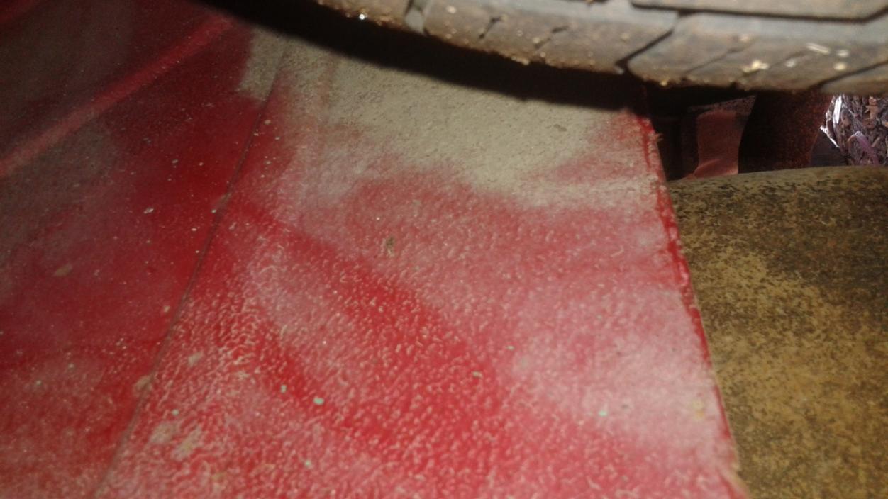

Power washed the wheel wells on my e3, I can see a undercoat texture under the paint.
Bob, that looks like the chip guard. On US coupes, primer is very thick and appears to be tan color, almost khaki/yellow or something close. Body color is oversprayed around edges, not everywhere. I think dealers applied undercoating, it is found on the window stickers, and it is grey. Years of oil, grease and dirt turns it black.
