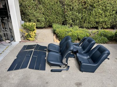

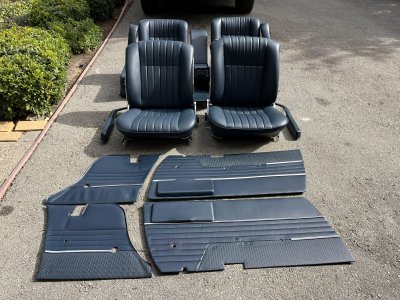

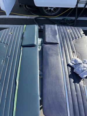

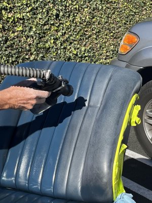

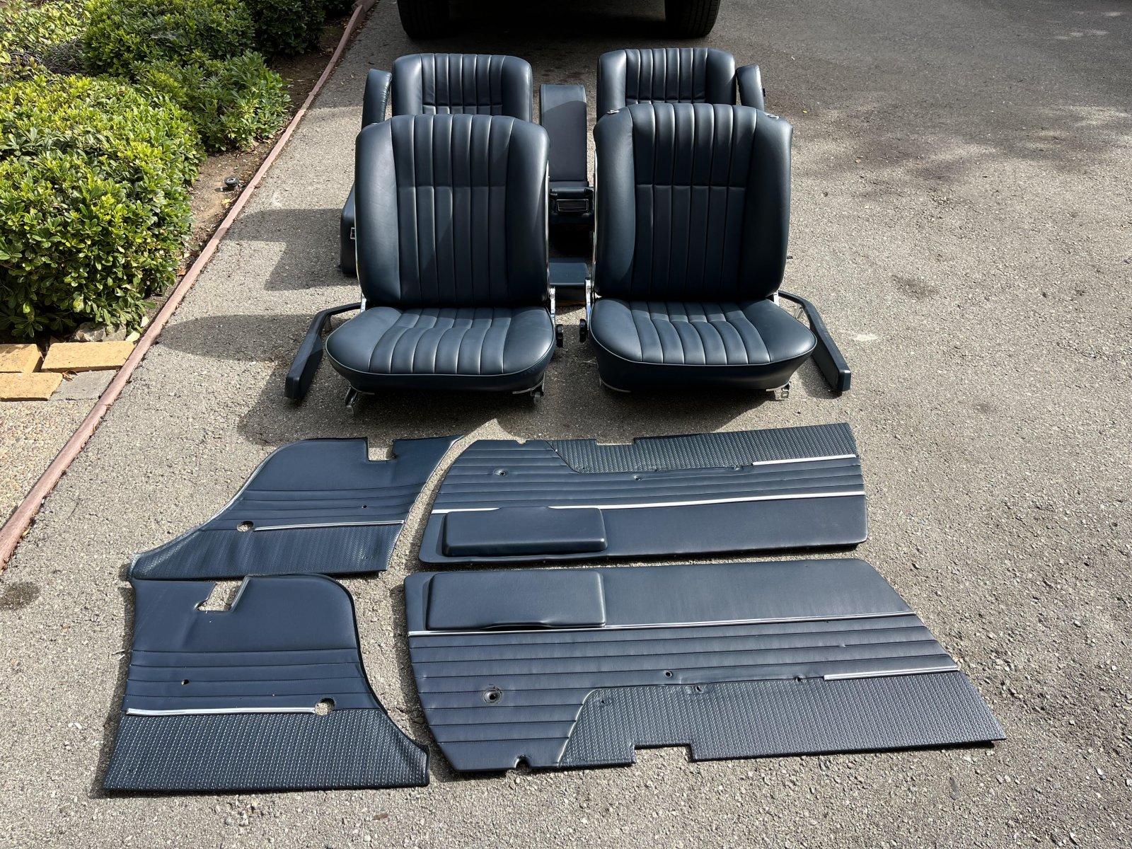

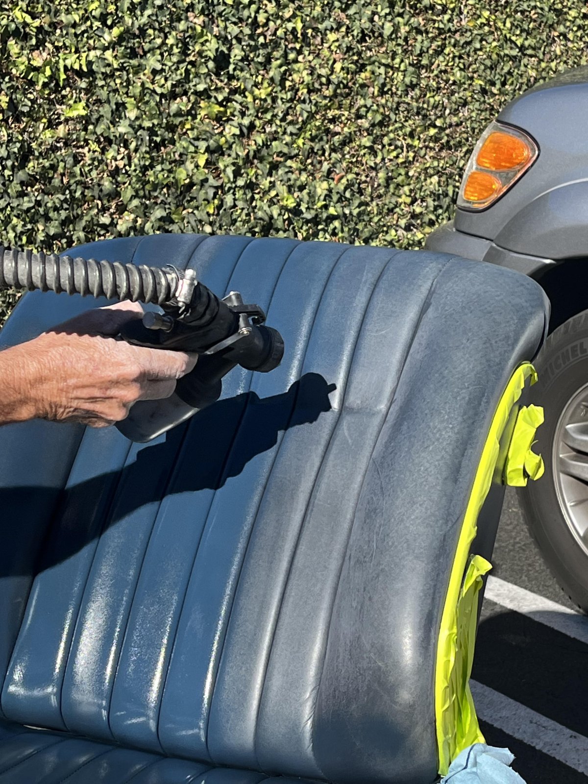

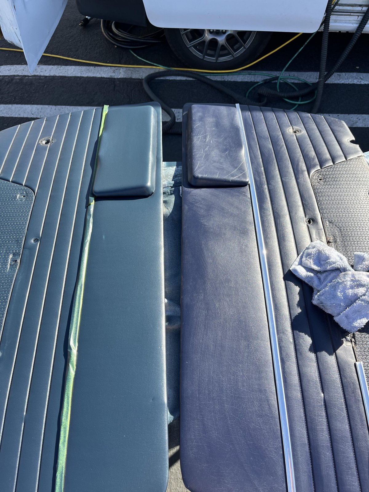

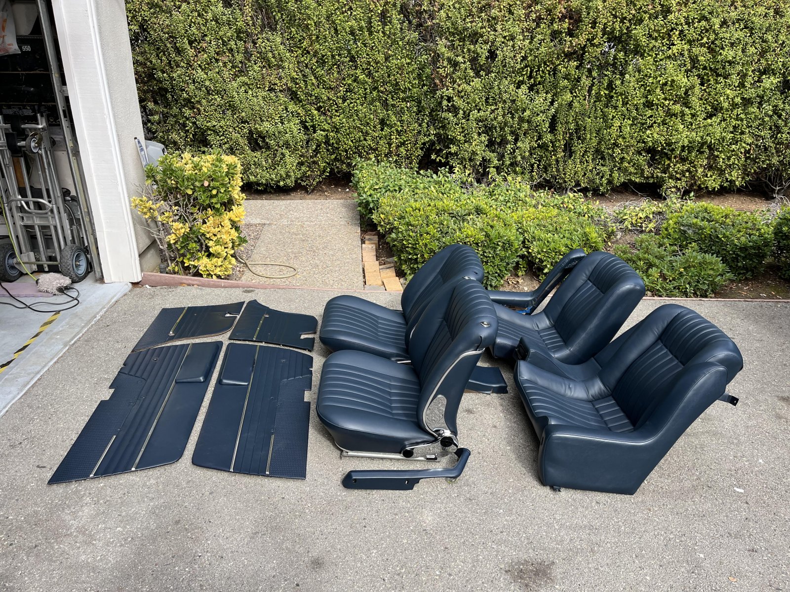

Body painter left seats out in sun and faded my new seats. As a fix had all the seats painted same color and as a bonus painted the door cards to match.

Very nice Probably a leather dye I just finished up a 71 2002ti full resto and installed 320 i recaro seats that I had to dye so I did all the door cards and the rear eats even with new rear seat covers It makes big difference when everything is in the same color and tone helps to hide minor scuff marks as well
Thanks, Rick
Very nice. I've died several seats and door cards over the years with good results. It's all about prep.
Dan

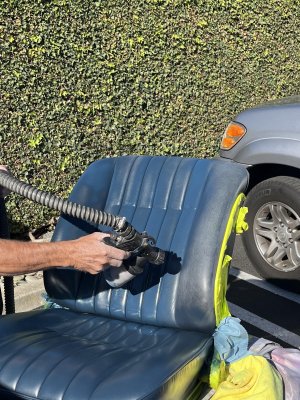

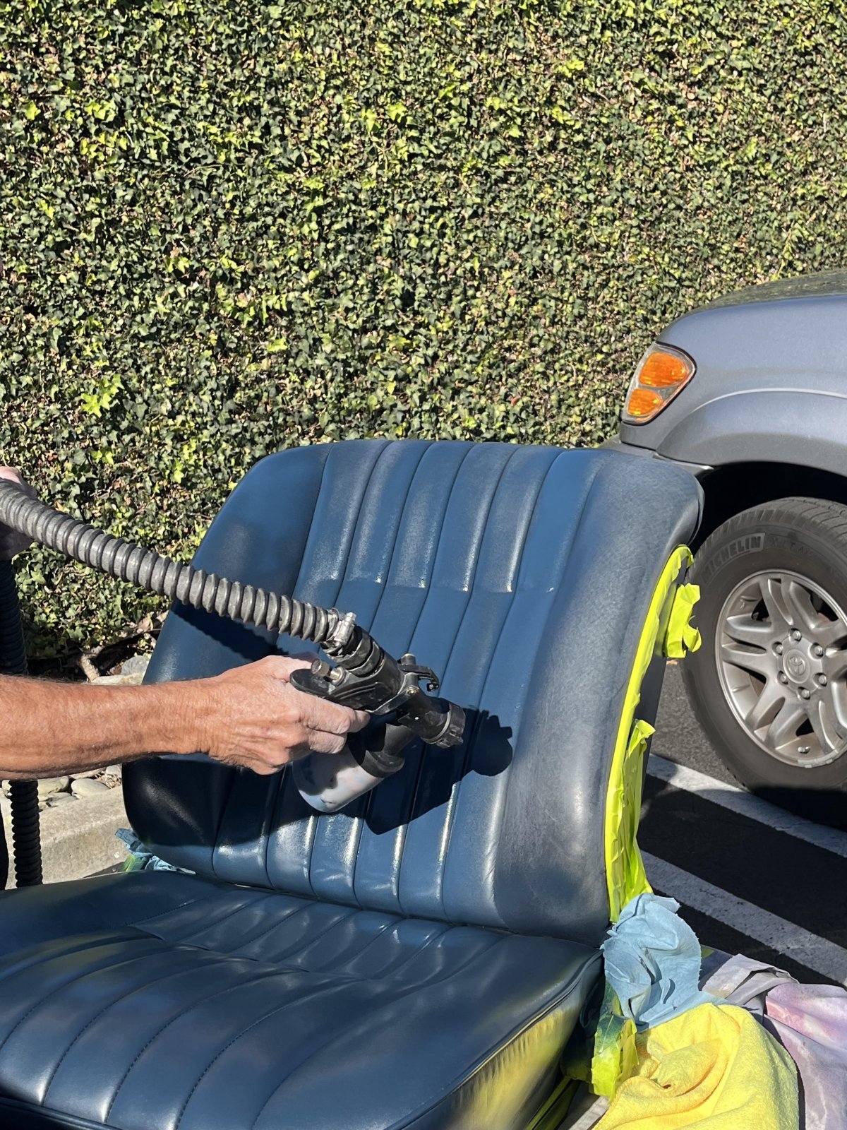

I had Rick’s Auto upholstery out of Gilroy do it. He used a water base paint custom mixed. He sprayed it on then sprayed a clear coat on
I know that you folks get a lot of sun out west, but I am astounded that the leather bleached out in what I'm guessing was not a long period of time...How long did it sit in the sun? If it was residential/interior spec leather, I would understand...
I currently have a swatch on the dash of my car, been there 6 months, to see if it would bleached out, as I was trying to see about longevity of color, cooking daily....as it was a residential, but "protected" hide, that I have access to for cheap...so far, no noticeable change in color....we'll see.

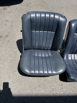

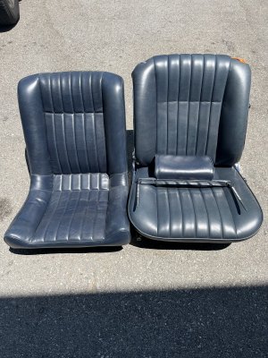

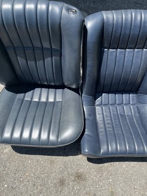

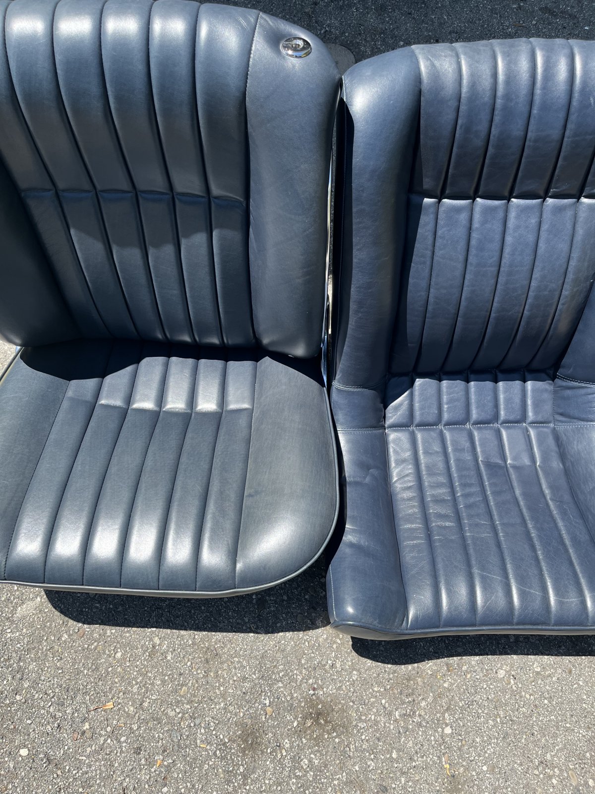

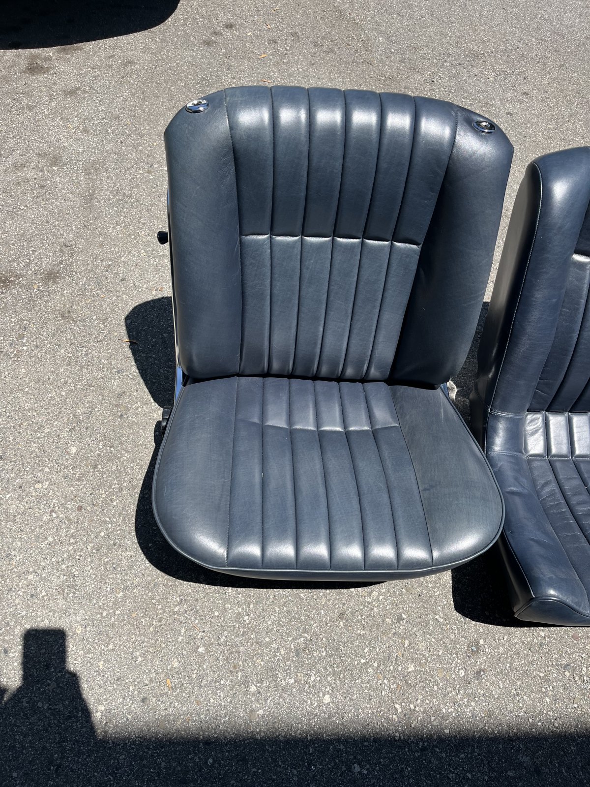

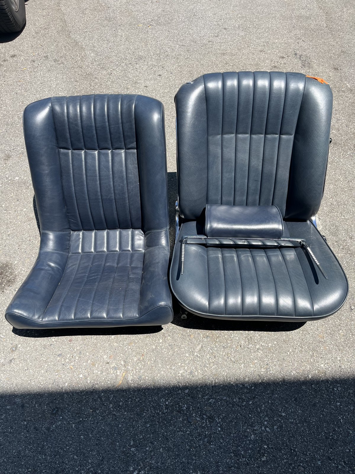

Ignoring my better judgement I left the front seats in my coupe when I left it off to be painted. I thought the job would be 3 months but after 5 months of the car being left outside during the day this is what the seats look like. They were covered with plastic to keep clean but you can see how much they faded in these pictures comparing to the back seats that I stored in my garage and the front seats that were exposed to sun

A friend that has been doing leather upholstery for years told me to clean/scrub the leather with something mild like Woolite, then go over it with rubbing alcohol before using dye. I've done seats by hand with a small rag, taking four to five coats to get it uniform, or using a rag or small brush to get the seams and hard to get areas before spraying dye. He does the latter. Both ways came out good for me.
