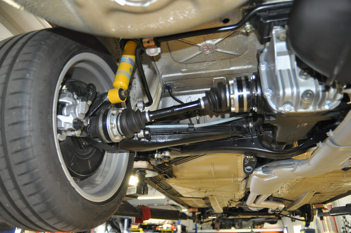

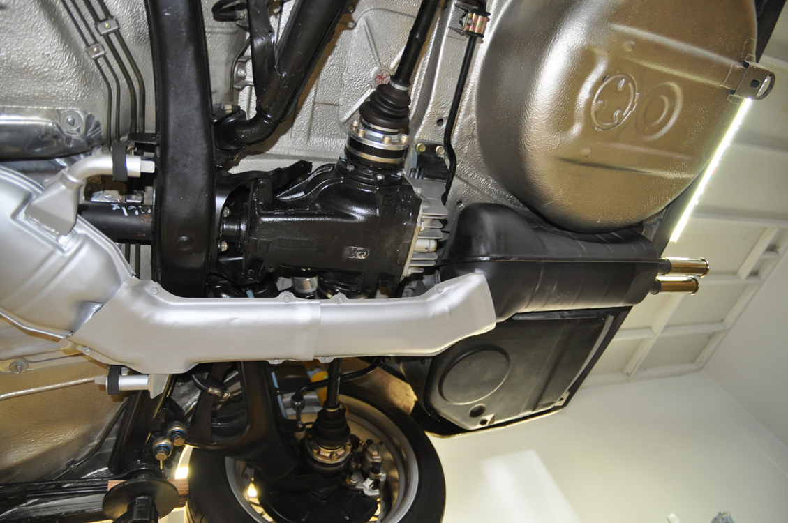

I had mine out a while back and wire brushed it, sprayed rust converter all over it (the stuff you let sit on it overnight that turns it black), then used the Rustoloeum silver high temp barbeque grill spray. This has held up better than the silver VHT hi temp stuff I used last time.
