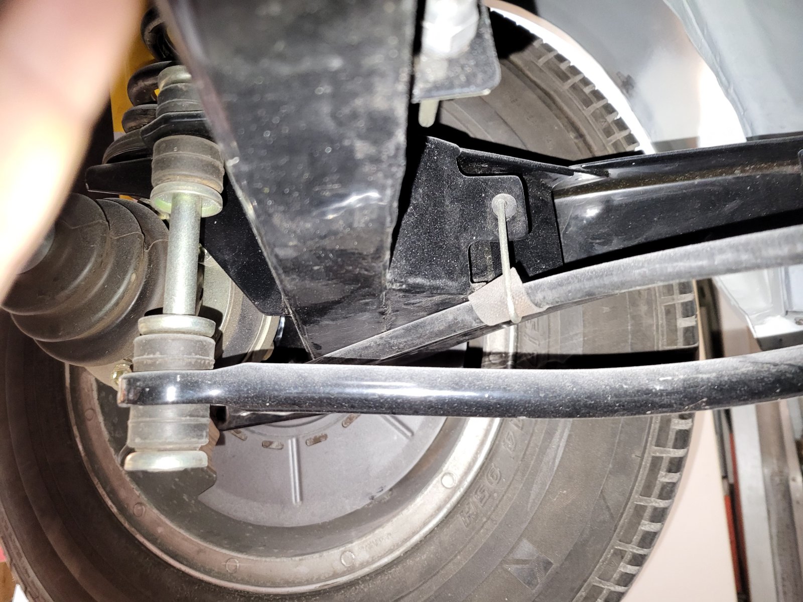

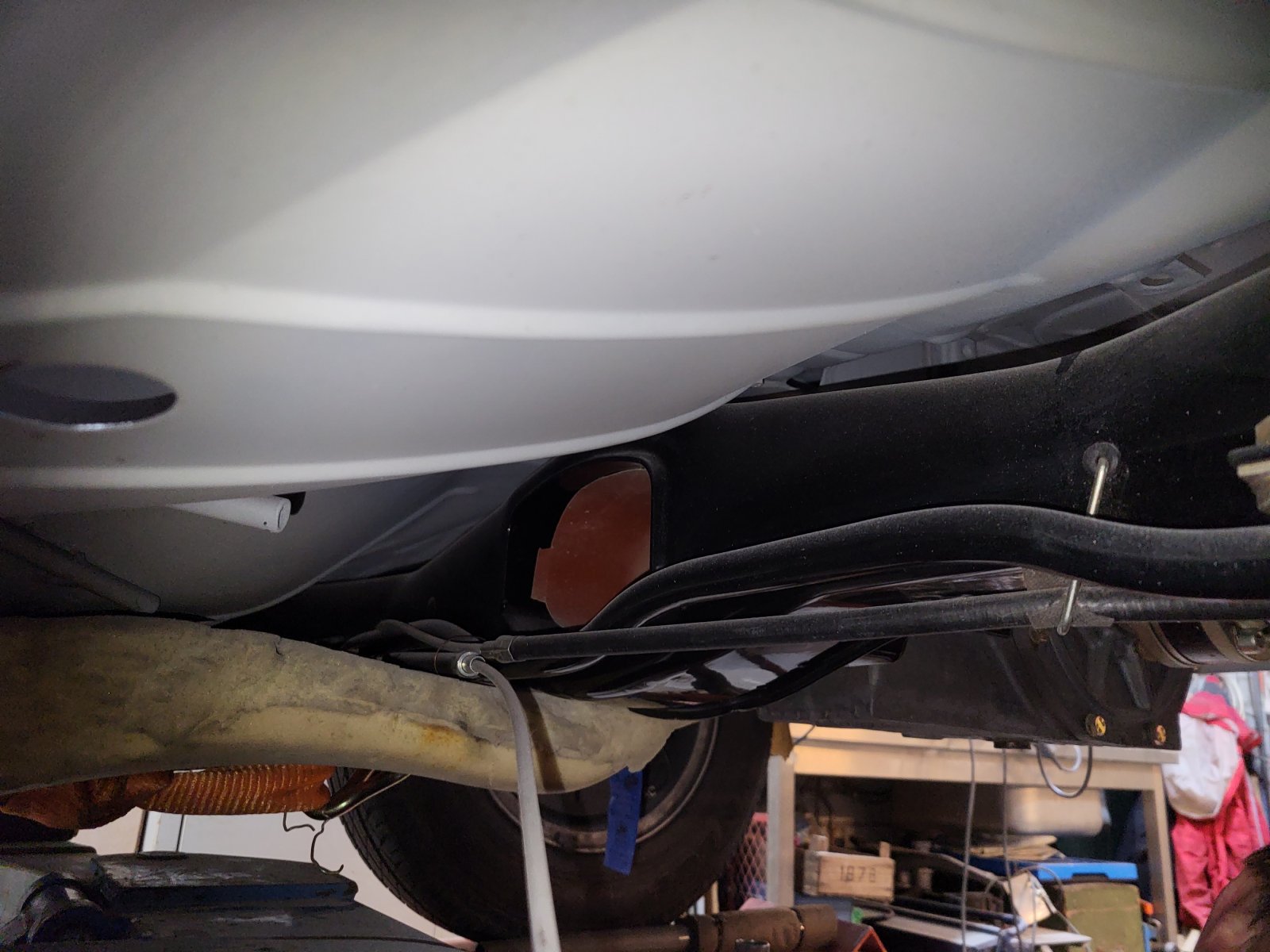

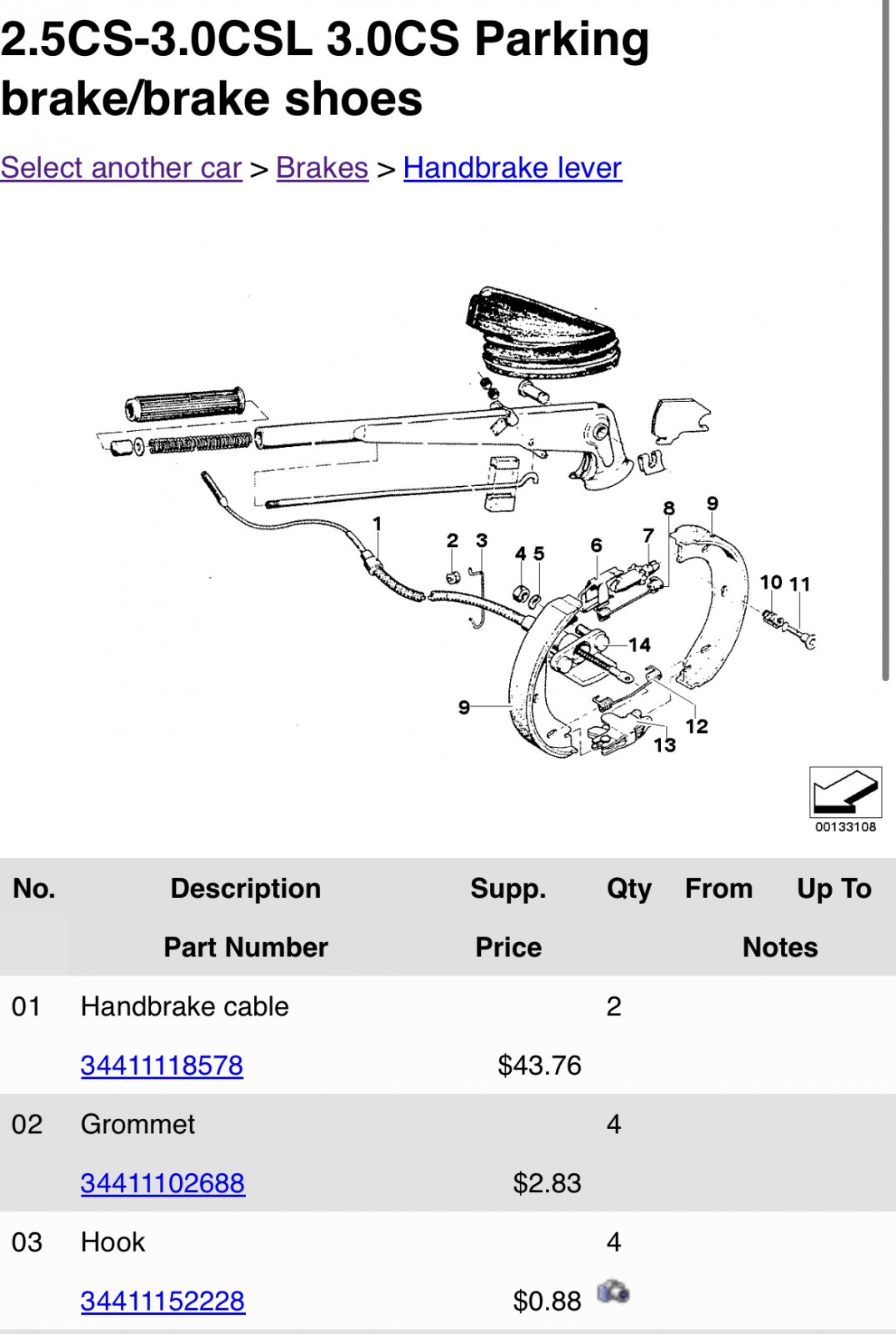

Which holes do the four hangers attach to?
My best guess is the “flaps” on the trailing arm and the hole on the front of the rear subframe. But the cables don’t really wanna go anywhere, so all kinds of combinations are possible. Pictures from this site and bat.com give inconclusive answers.

My coupe isn’t here at the moment but the flaps on the trailing arms are for stabilizer bars, there are only two clips, they clip to the trailing arms.

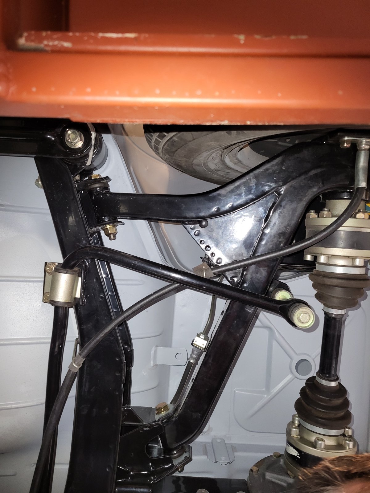

Hi there

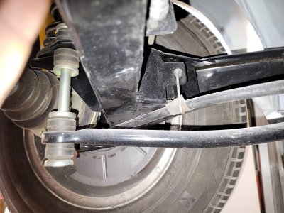

You can just see them still hanging on my subframe and swing arm , They are not the best photos to be honest , but they might be some help to you.

Parts catalogues says four hooks and four grommets.

Having owned 2 e9, 1 e3, 4 2002s, 1 NK and an e12 I have never seen more than two and they all use this clip. Maybe someone has a pic of all four.
At your service:

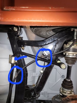

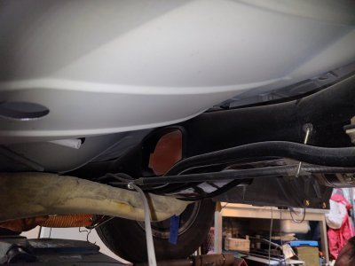

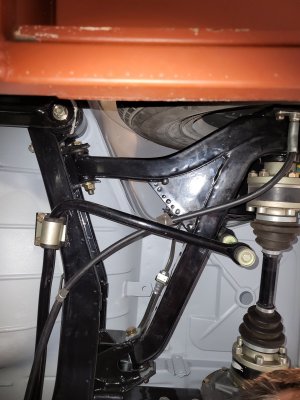

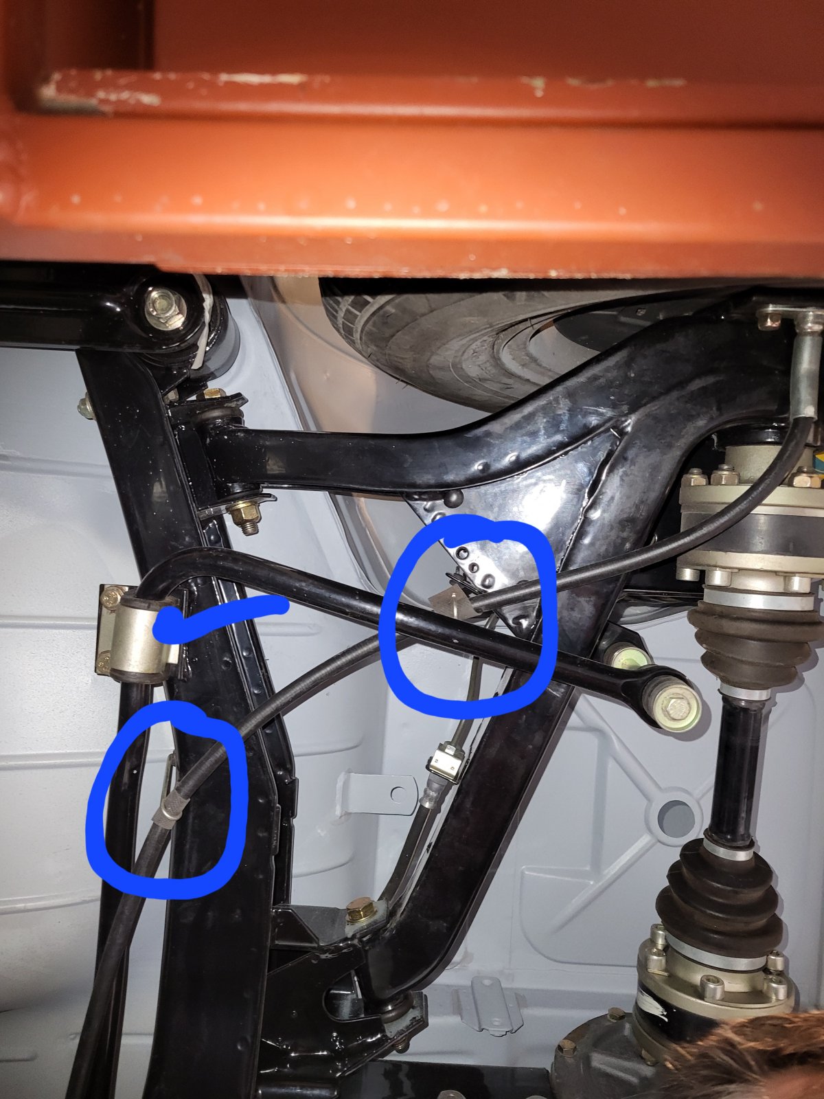

4 clips on my car.
Not the best pictures now that I'm back in the house, but one set is on the subframe, the other clip is inside the training arm. See the blue circles-
(Ignore the blue line)
