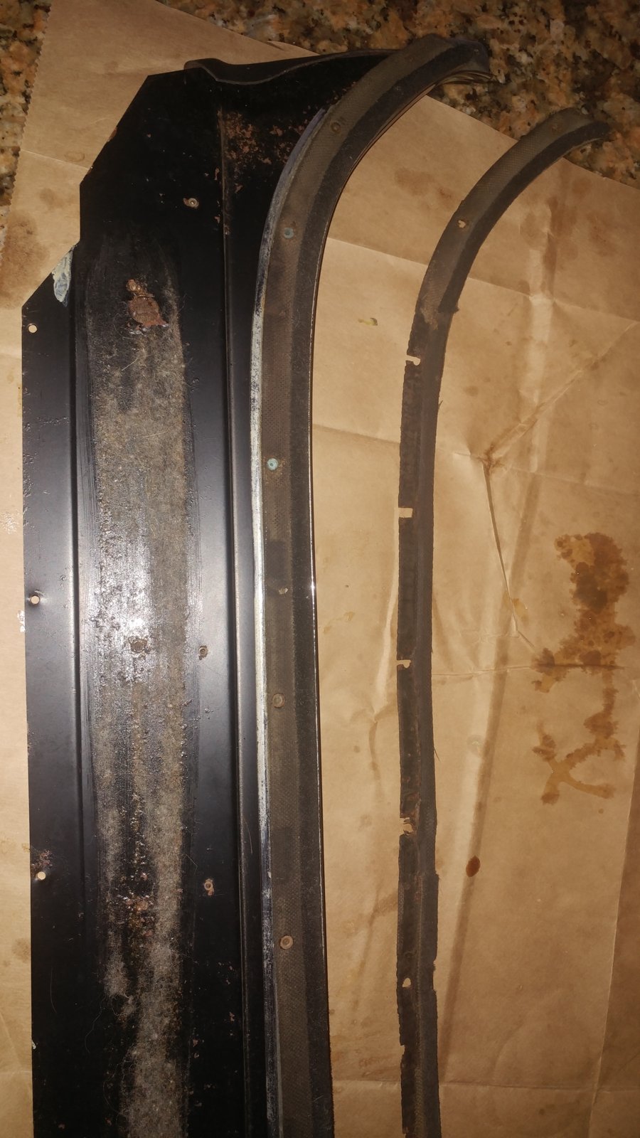

Looking at the photo i have added showing the felt fuzzy strip attached to the inner molding with rivets. Also in the picture is an old felt piece removed from the outside chrome molding. This is the piece that sits between the outer chrome molding and the rubber squeezee. The two pieces look identical and was wondering if the outer piece could work on the opposite inner side. So if the inner fuzzys are still available it does look like the left inner could be used on the right outer and vice versa.

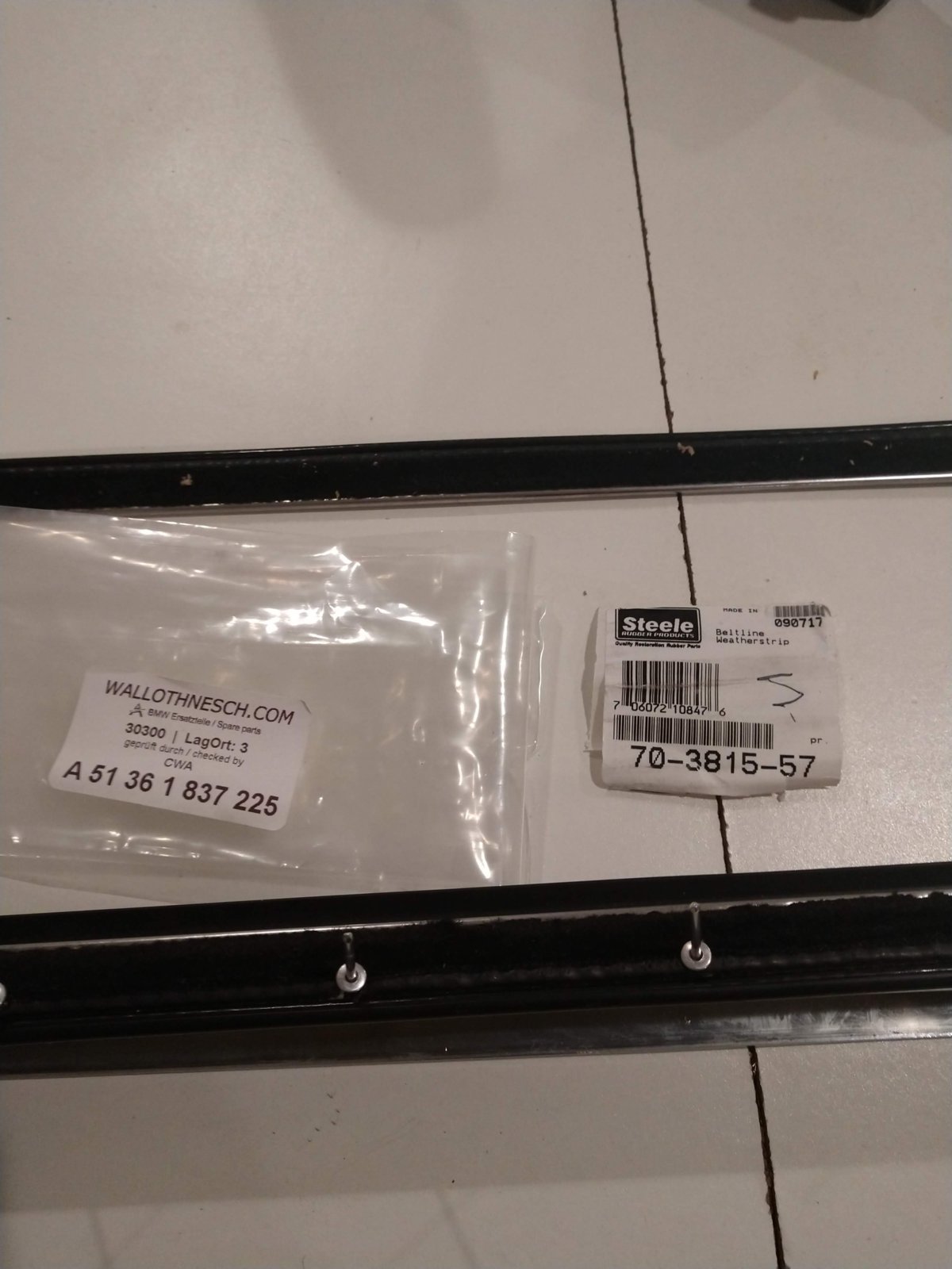

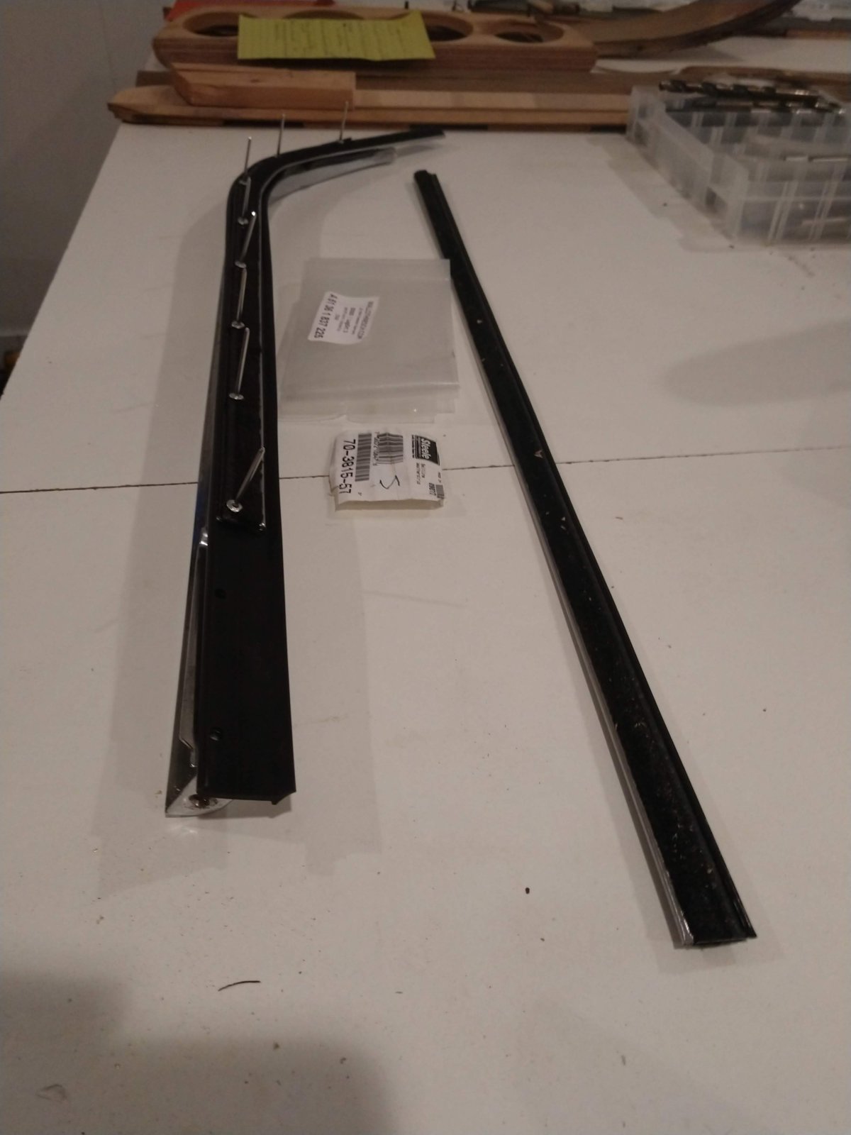

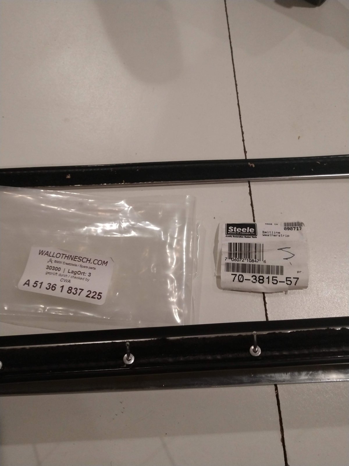

Here are the part numbers I settled on. Turned out ok but not show quality. Two pieces, one rubber strip and one Felt strip sandwiched on then riveted.
Pics are midway through the process before I trimmed them.

I did remove the inner fuzzy from the molding and compared it to the outer fuzz in the photo, they seem identical. The inner one fit in the outer rubber squeezee perfectly, but of course the rivet holes don't line up.

Makes sense with 2 part numbers, they are technically mirrored with felt facing opposite direction. Enjoy!
FYI-Use the shortest rivets you can find, I had interference issues when installing on the car because my rivets were too long.
