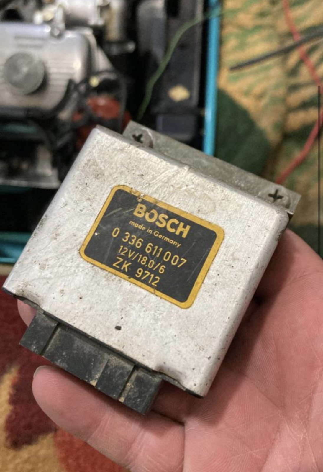

merdad Well-Known Member Site Donor $ Site Donor $$ Messages 543 Reaction score 378 Location Tehran, Iran Oct 9, 2023 #1 Is this relay any part of an e9? It was on my friend’s 69 2800 and now they don’t remember where it goes. Thanks Attachments IMG_4241.jpeg 204.2 KB · Views: 136
Stevehose Well-Known Member Site Donor $$ Messages 13,764 Reaction score 6,737 Location Sarasota, FL Oct 9, 2023 #2 Speed relay for emmission, goes below the coil near the frame rail. Usually a pair of them that mount to a bracket which then attaches to the fender.
merdad Well-Known Member Site Donor $ Site Donor $$ Messages 543 Reaction score 378 Location Tehran, Iran Oct 9, 2023 #3 Stevehose said: Speed relay for emmission, goes below the coil near the frame rail. Usually a pair of them that mount to a bracket which then attaches to the fender. Click to expand... Thanks Steve, So not needed if there no emissions stuff ?
Stevehose Well-Known Member Site Donor $$ Messages 13,764 Reaction score 6,737 Location Sarasota, FL Oct 9, 2023 #4 merdad said: Thanks Steve, So not needed if there no emissions stuff ? Click to expand... nope!
merdad Well-Known Member Site Donor $ Site Donor $$ Messages 543 Reaction score 378 Location Tehran, Iran Oct 9, 2023 #5 Stevehose said: nope! Click to expand... Thanks
HB Chris Moderator Site Donor $$ Messages 21,253 Reaction score 10,537 Location Huntington Beach, CA Oct 9, 2023 #6 Known as a speed relay to control vacuum dashpots on firewall for emissions
