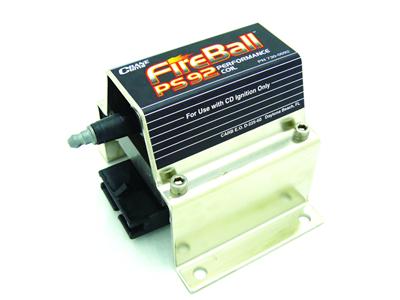

The problem of rotor issues (overheating or meltdown) typically arises when you introduce a so-called "super/blaster coil" (e.g. Crane PS92 etc.) in combination with non resistance wires and non resistance terminals and non resistance plugs. Per G. Ohm and his maxim, the ignition system is designed to include a modicum of resistance. If the high tension leads do not resist some of the aftermarket coil's energy, the rotor may. Having tried a variety of aftermarket ignition hardware, the only stock Bosch rotor failures have been due to unexplained carbon button disintegration (at the top of the distributor cap) and normal wear. I have modified rotors out of sheer curiosity, but never noticed any difference.
