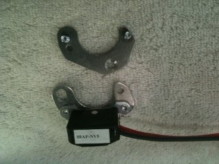

Please take a look at the photos. There are two adaptor plates shown in the installation diagram, but the kit only came with one.
Thanks.

As long as the module and the magnet line up at the bottom per the instructions you shouldn't need 2 adapter plates, see if it lines up and if you even need one plate. I don't rememer having 2 plates - those instructions may be generic.
It's only needed as a spacer if things don't line up. Make sure the reluctor wheel, the part on the dizzy shaft, is all the way down.
p.s. - What Steve said.
I thought it might be generic; thanks.

My Pertronix came with only one bracket, like your photo on the left. I can't explain the diagram on the right, showing two brackets.
An additional bracket would position the sensor higher, which might cause it to interfere with something. I doubt it is needed for e9 applications.
