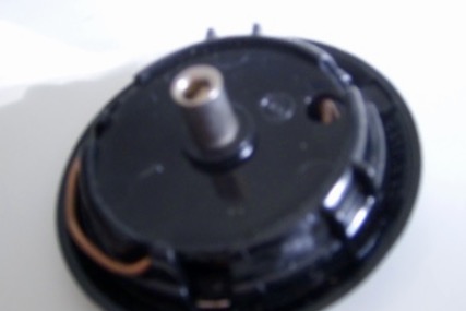

Remove just horn button itself without chipping it. Plastic is old and brittle and chips easily. The other (safer) way is if you can unscrew the 6 screws on the black ring underneath and lift the ring up with the horn button together . It's the spring under the hb causing the hesitation. 2nd pic shows the ring underneath the hb

if you are not confortable with pulling this plastic piece, just unscrew the allen bolts, pour some oil spray and remove them, then everything will be fine
it is more important to keep the plastic in one piece
i slip a business card in between the button and wheel. then another. then a credit card in between them and it will start the process and you can slide it around to get it off.
