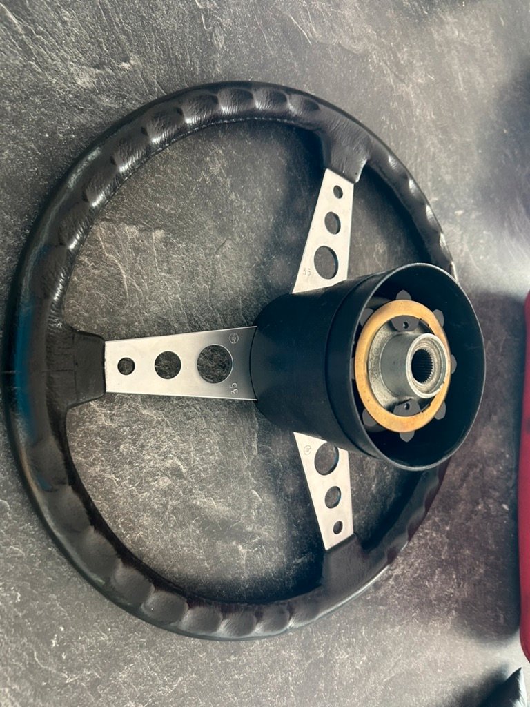

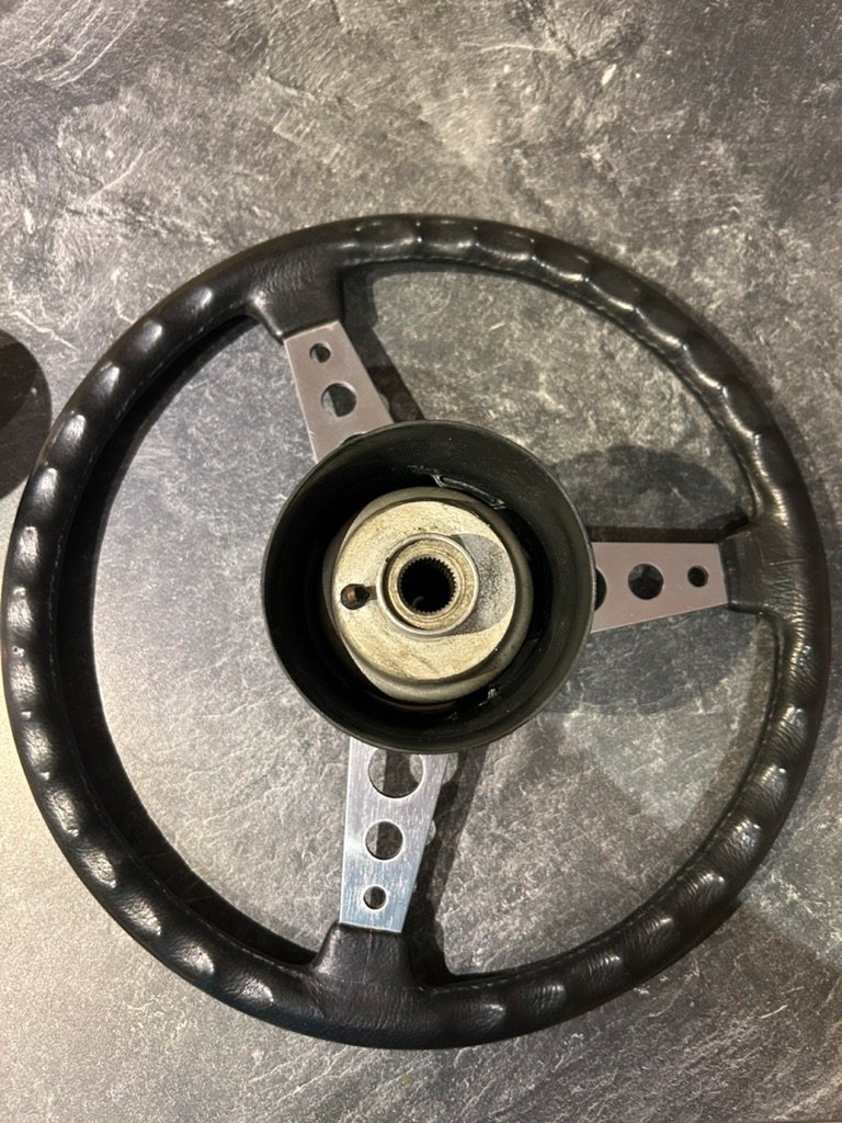

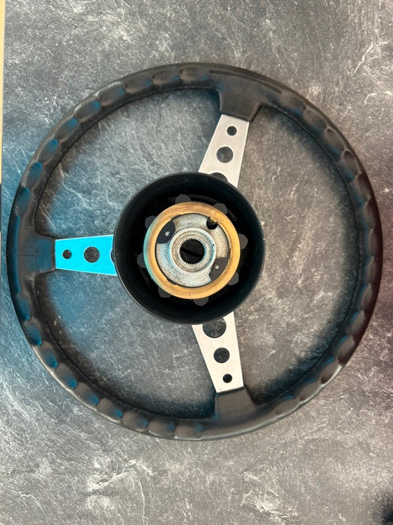

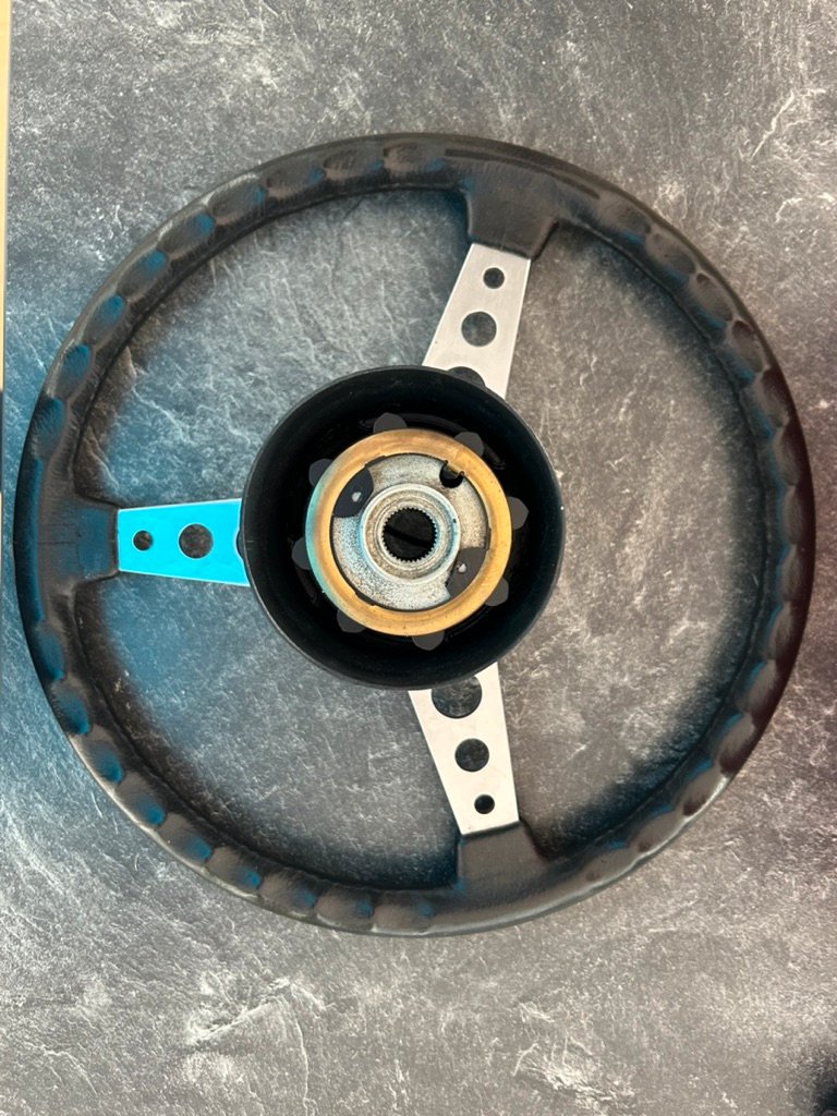

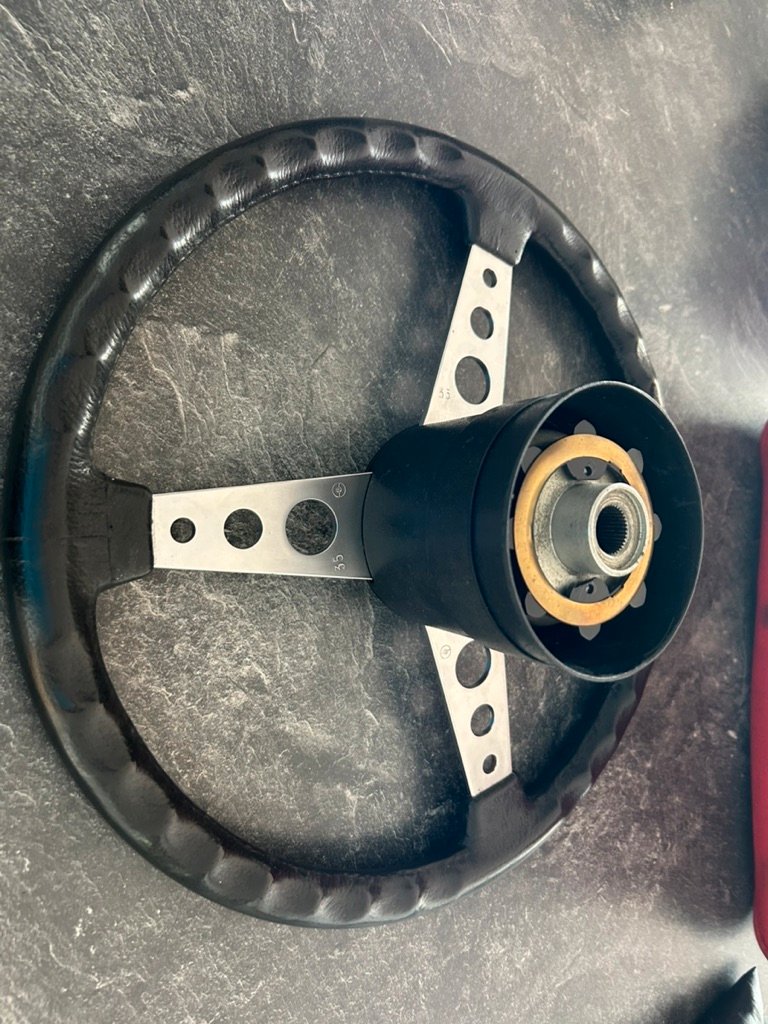

A question for the steering wheel specialists, is this hub correct for E9 or 2002?

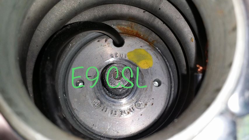

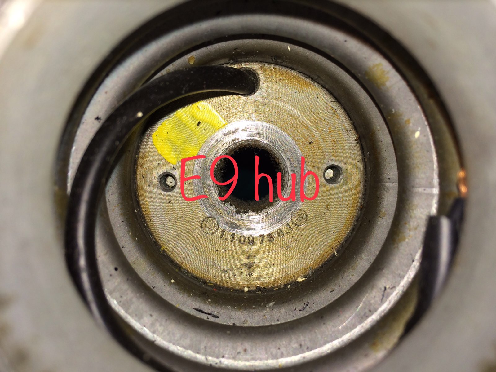

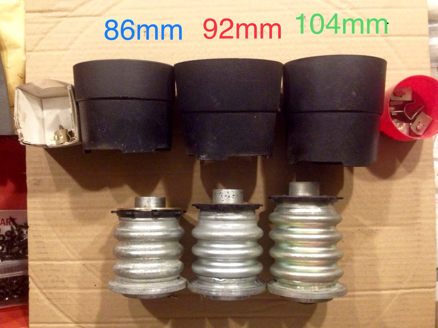

e9 horn ring, but the diameter looks like 350, which is generally 2002. the hub is interchangeable between the wheels, but the 2002 hub is a different length than e9 as is the hub cover

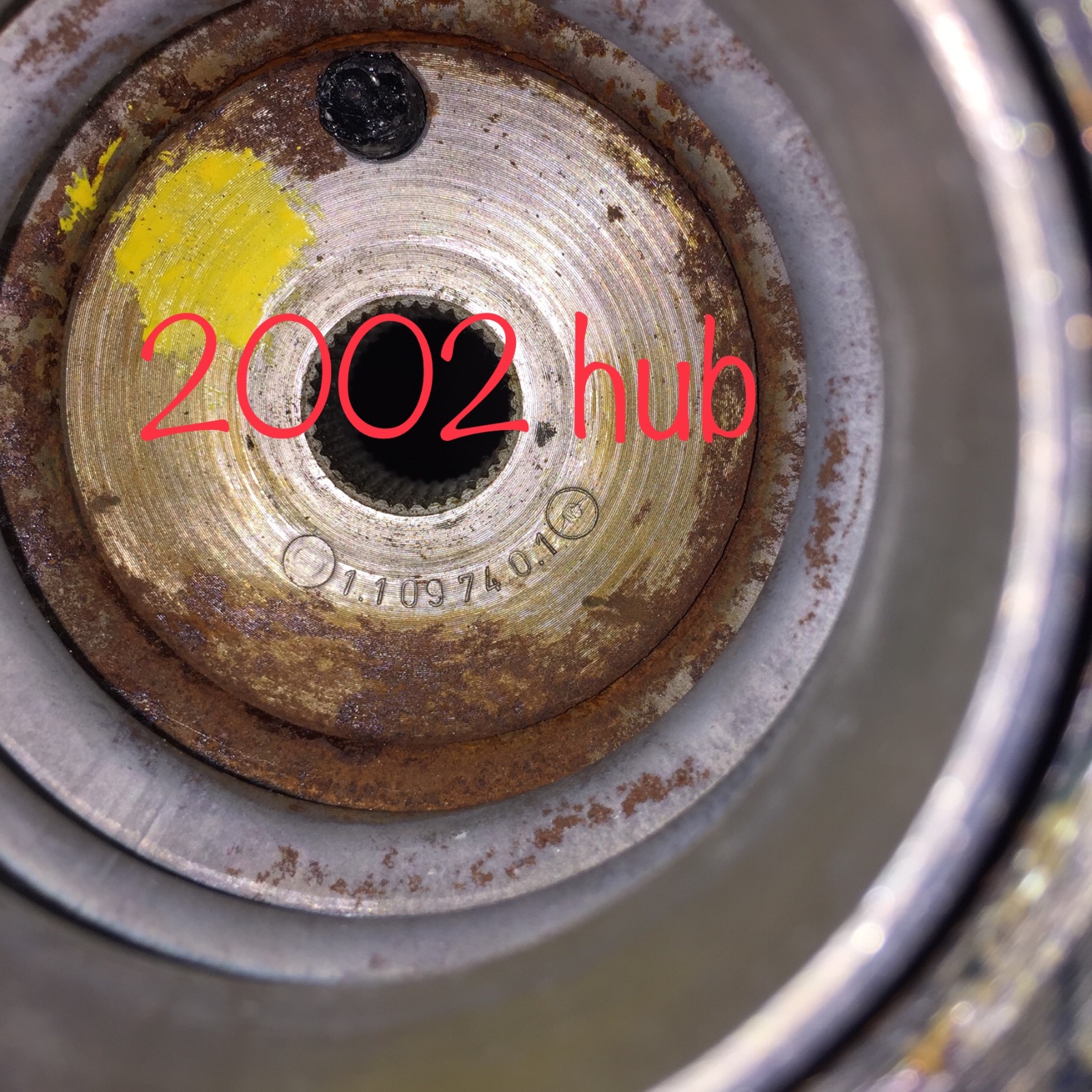

The number on the hub is 1.113192.1
Is this for E9 or E10?
