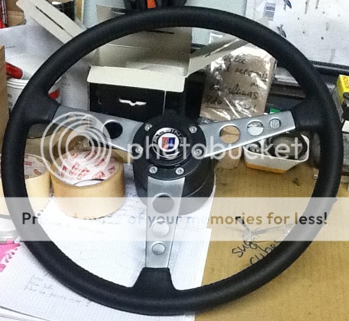

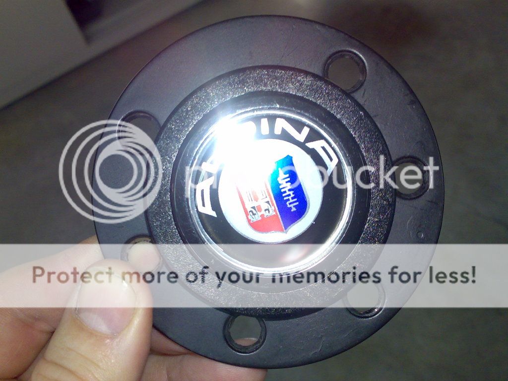

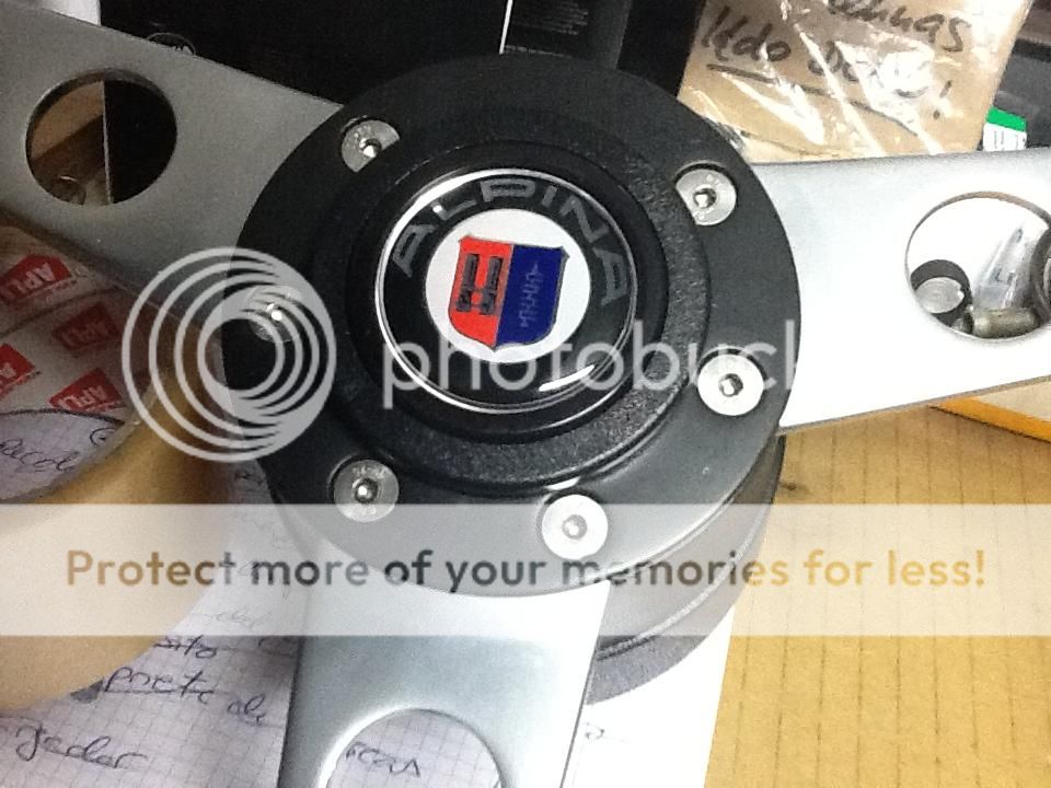

I know the right man here, he can even do this: transform a petri-bmw in a petri-alpina
summary of the work done:
- new leather
- clean and brush and finishing steel
- central plate paint in satin black
- new allen bolts
- profound plastic cleaning
- new alpina button
- modifications to install alpina button in existing hub
