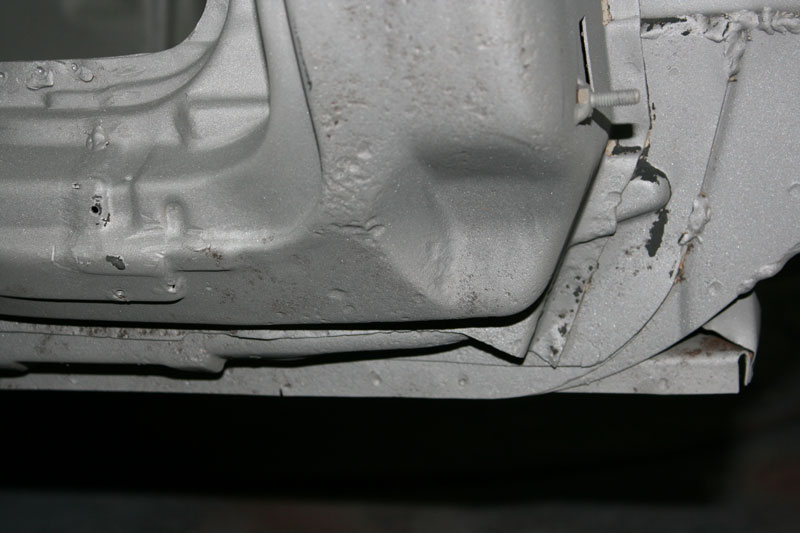

Paul,
I did a couple of pictures of my actual "E9-puzzle". If I understand it correctly you're searching for this area :
http://s1160.beta.photobucket.com/u...rt=3&o=0&_suid=135470260786204438039982586873
I did this piece by myself and also just had pictures in the net (you can see it here for another impression: http://e9coupe.com/forum/showthread.php?t=5282 )
for the design and a certain clue of the dimensions of it. The flat piece isn't for sure not a big deal. I did it 10 by 11cm for the base surface, if I remember that right. The more advanced one is the connection part to the bulkhead, because it's not rectangular in any direction :-x Don't ask about dimensions. You have to make a template anyway. Please don't ask me about the funktion of this. I can't see any ...

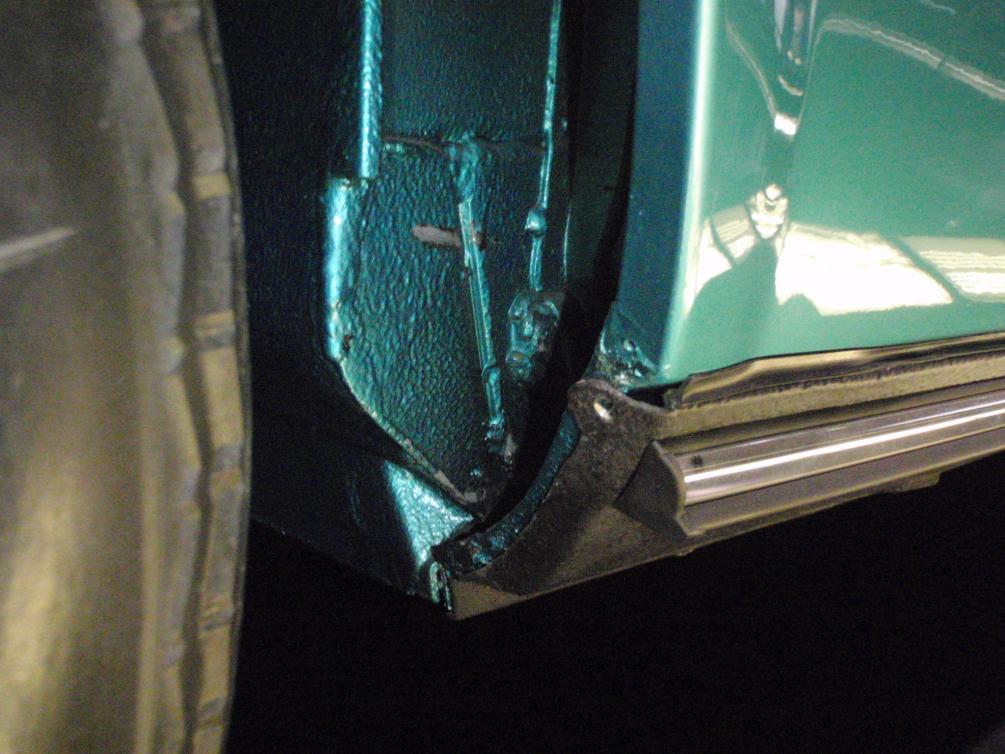

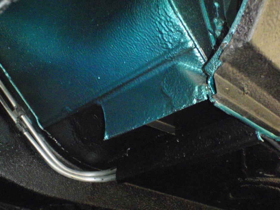

Pics from this location of the E9 in BMW museum
Just visited the BMW museum last week, took some pictures of this spot as i will probably tackle this somewhere in the coming years....
for your orientation, it's the right front wheel well, looking towards the rear. You can just make out the fuellines and the black (screwed on :mad:!) rocker panel.
I have other pics of the e9 on display, also from the M30 engine on show. Just ask.
Hope this helps.
included 2 other pics to get you through to the weekend...
