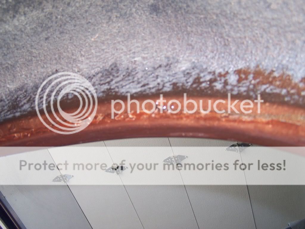

Here are your wheels. BBS RS-005 16X7 ET-11 all around. These wheels do have a staggered tire set on them. 205/55 & 225/50. All 4 lips were rolled due to rubbing. You will destroy your fenders if you try to fit a 225 up front. This car is running a Dinan spring set without camber plates. ET-11 in the rear with a 225 requires you to roll the lips. You will not have a problem running all 205/55 with these wheels.

Good eye! When Don and I received this car it had a LONG list of things that needed attention. The guards have been corrected prior to delivery to the new owner.
