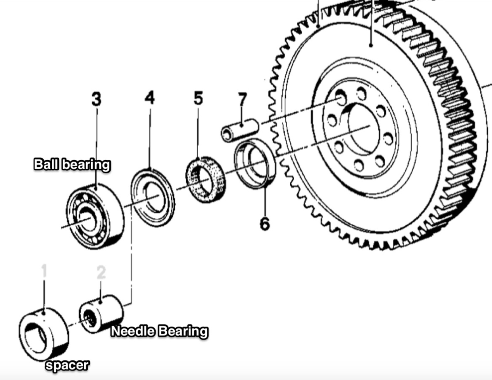

Sorry, to still be on this subject,
Has anyone had success in removing the spacer for the pilot bearing in crankshaft ?
If so how ?
This is the one that reducers diameter from 32 mm to 21 to suit the needle roller bearing.
I want to use the ball bearing rather than the needle roller bearing, but am having trouble removing the spacer / sleeve.
I have been able to remove pilot ball bearings (using bread method!) but cannot remove this spacer
If so how ?
That’s very old school and a PITA.
I use a dremel fiberglass reinforced cutting wheel to cut a slot at top and bottom from front to back.
https://www.lowes.com/pd/Dremel-5-P...MI5ZvUuuev3AIVBLXACh1MjAEAEAQYASABEgLE1fD_BwE
As wheel gets smaller it will cut deeper and deeper. The slots allow the metal to cave in on itself with a hammer and chisel so it can be extracted easier. It’s 20 minutes of fun.
Other folks use extractor tools.
https://www.summitracing.com/parts/...MIy4u11-Ov3AIVjbbACh2bCwshEAQYAiABEgLeEvD_BwE
https://www.harborfreight.com/3-jaw-pilot-bearing-puller-4876.html
