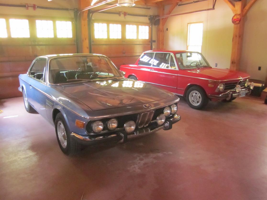

I know it's not much to go on. When I had it for the day I only took one picture. And it's no help what so ever.
FWIW mine is 72 Polaris with all silver front grill with silver hood and fender grilles and I prefer the chrome vs. black look.
It looks comfortable in your garage next to your '02!
Good combo. I saw that picture when you posted it over on the 2002FAQ. I too am a 2002 tii and 3.0 csi owner. If you can, please post a picture of the engine compartment. Does the car have the original D-Jetronic injection? If so, that's a good thing in my opinion. I'm very happy with the original D-Jet setup on my car. Also, do you know whether it has a Limited Slip Differential or not? All good things to find out before purchase. Good luck,

PS, I just noticed that the wiper arms are on the wrong sides. The one with the air-foil thingy should be on the drivers side, not the passenger's side.
Good catch, but it is already fixed in the picture in the garage!

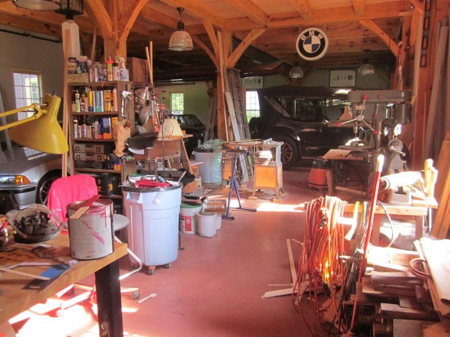

BTW, that garage is pretty wide, how about adding an E24 also?
It's pretty cluttered, the picture is hiding all this...already need a lift.
