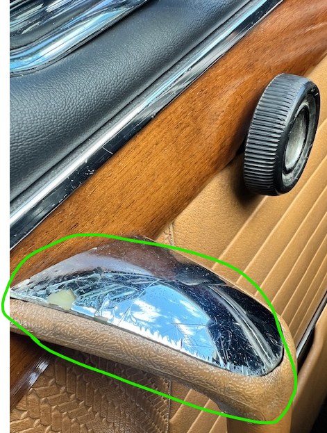

Hi folks,
anyone know how we can get these replaced?

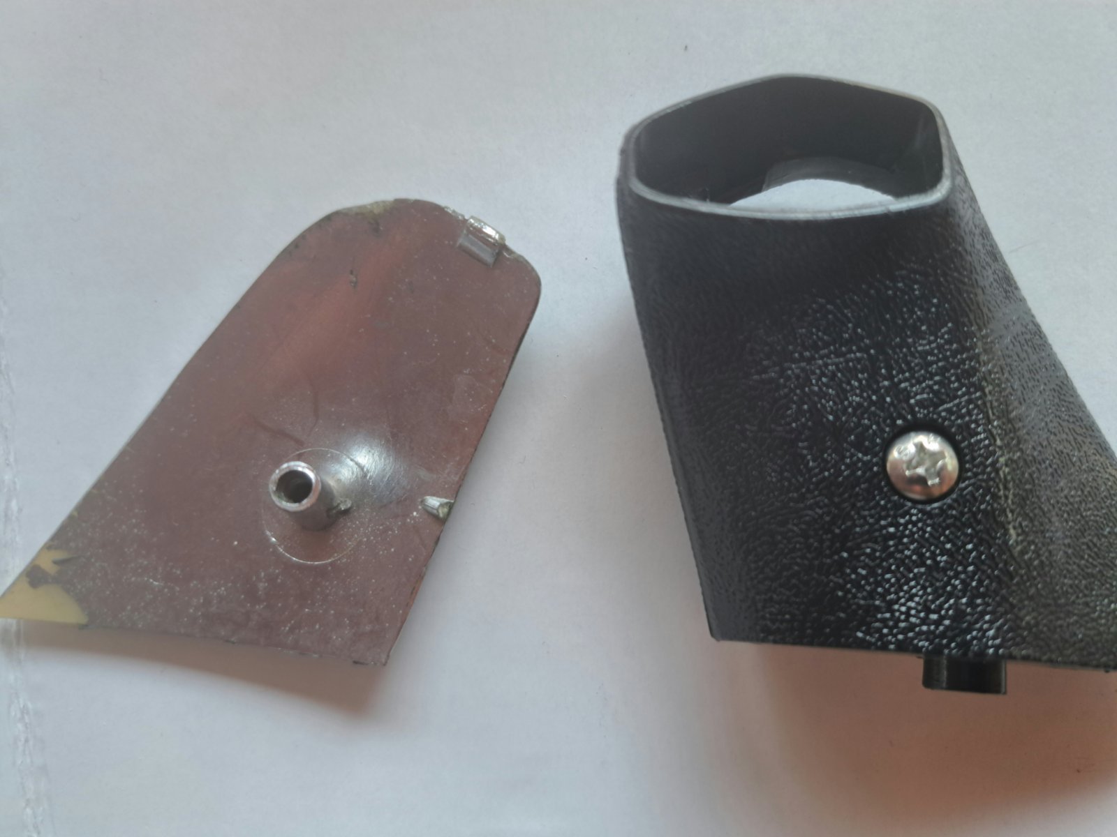

....from below there is small screw, take it out and use something like a needle to press the chrome cap upwards20250420_161914.jpg
I do have a source for these NOS chrome caps, much better than what you get in the shops nowadays. If you need a set let me know

I actually set a set back to W&N as the plastic moulding quality was so bad, that you could see, under the chrome layer, little parrallel lines from the (too rough) millingprocess of the injection moulding tool they used.

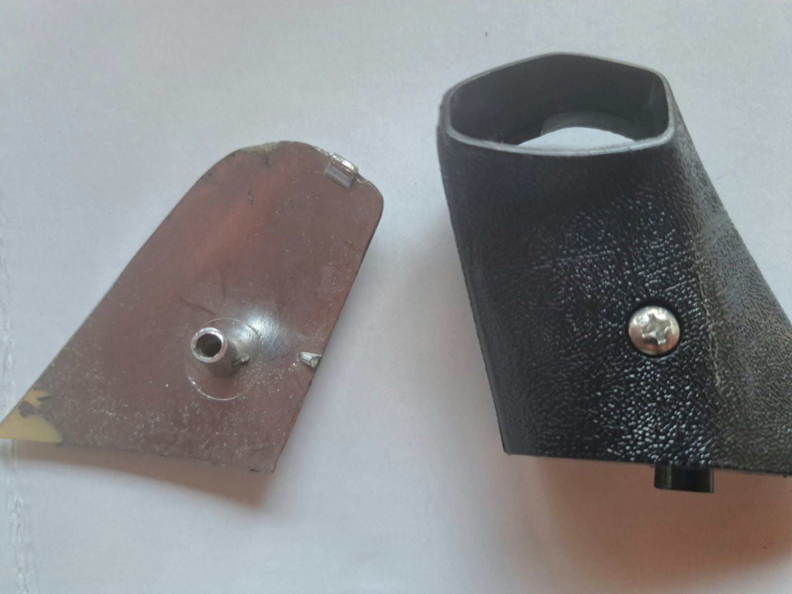

....from below there is small screw, take it out and use something like a needle to press the chrome cap upwardsView attachment 201011
