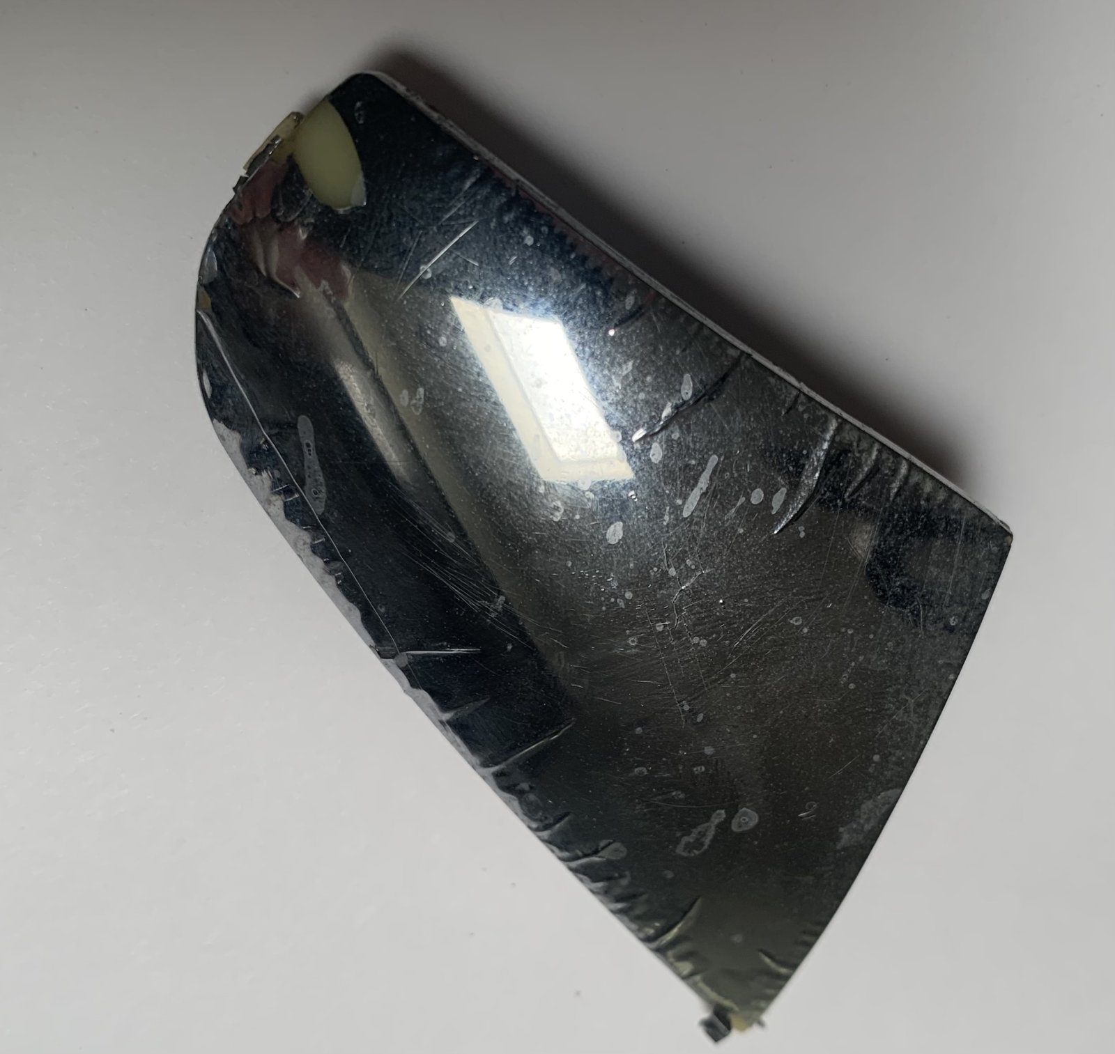

Both of my door handle "chrome" pieces are bubbling and flaking.
Has anyone successfully rehabbed these? Somehow cleanly strip the "chrome" off and re-paint with Chrome Spray Paint or some kind of dip?

Go to local sign shop and ask for a scrap of silver mylar sign vinyl.
peel n clean that old stuff off and adhere, heat to form, trim the new.

They can be rechromed.
(basically anything can with the right equipment)
I believe they are just 20 euro's each at Walloth. Though the set I got from Walloth wasnt perfect. The chrome was fresh, but it showed lines from the underlying plastic surface ( due to a cheap injection moulding tool; it didn't have a smooth.surface prior to chroming).

I found them. €8 each. I'm putting together an order so I may as well roll the dice on their product at that price. Thanks!
