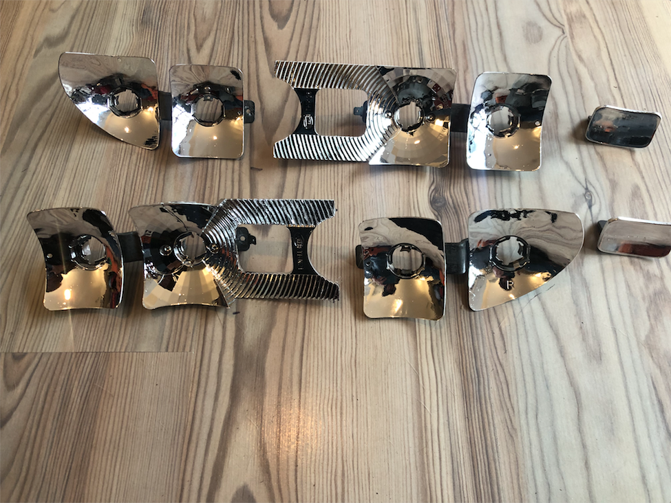

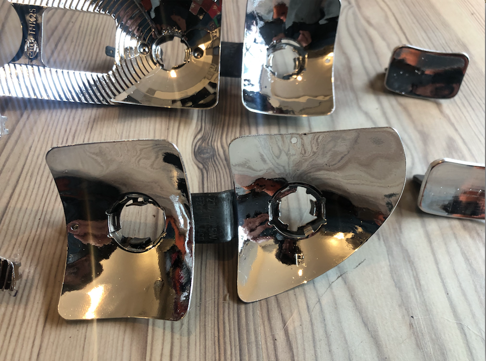

I open this post because some persons are interested.
They call the process metallic, and works on metal or plastic parts.
Those who are interested, I need you to put electrical tape where you do not want the metallizing process.
$60 USD Taillight plating set cost
Shipping process
Send me to Miami.
We put all the sets in a box and send it to Bogota.
I send to "chrome"
Back to Miami and we send it each of you
The shipping cost MIA-Bogotá- MIA is shared between the sets.

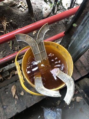

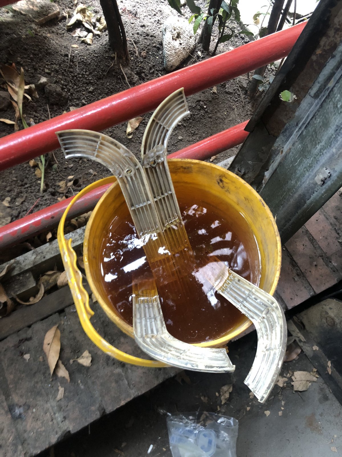

Not included, I removed it with ferric chloride and then I sanded the parts
