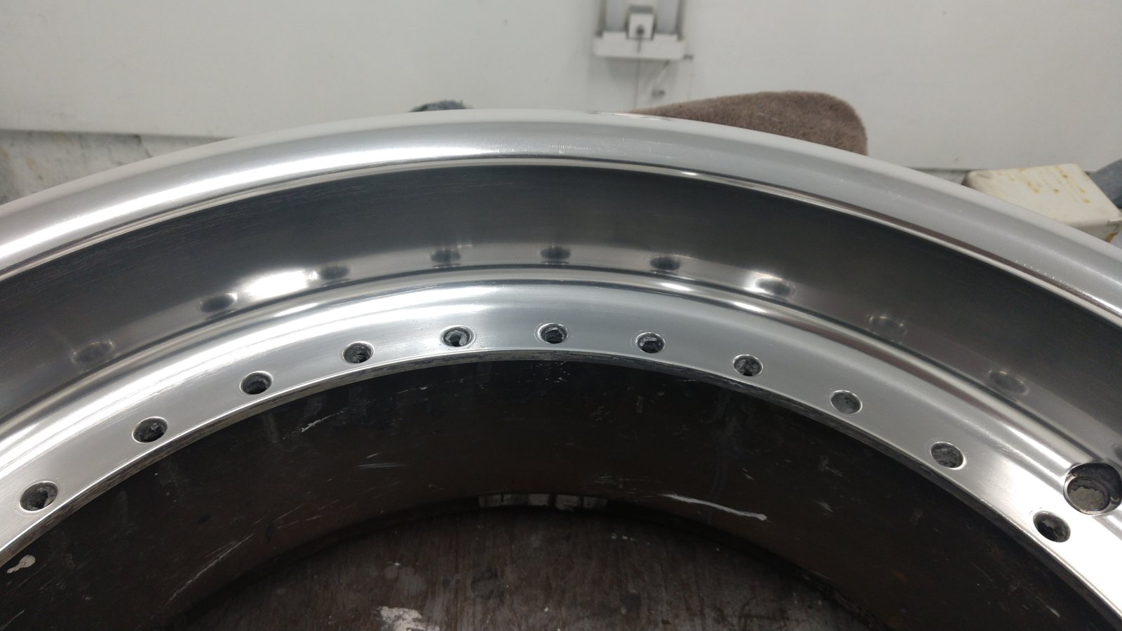

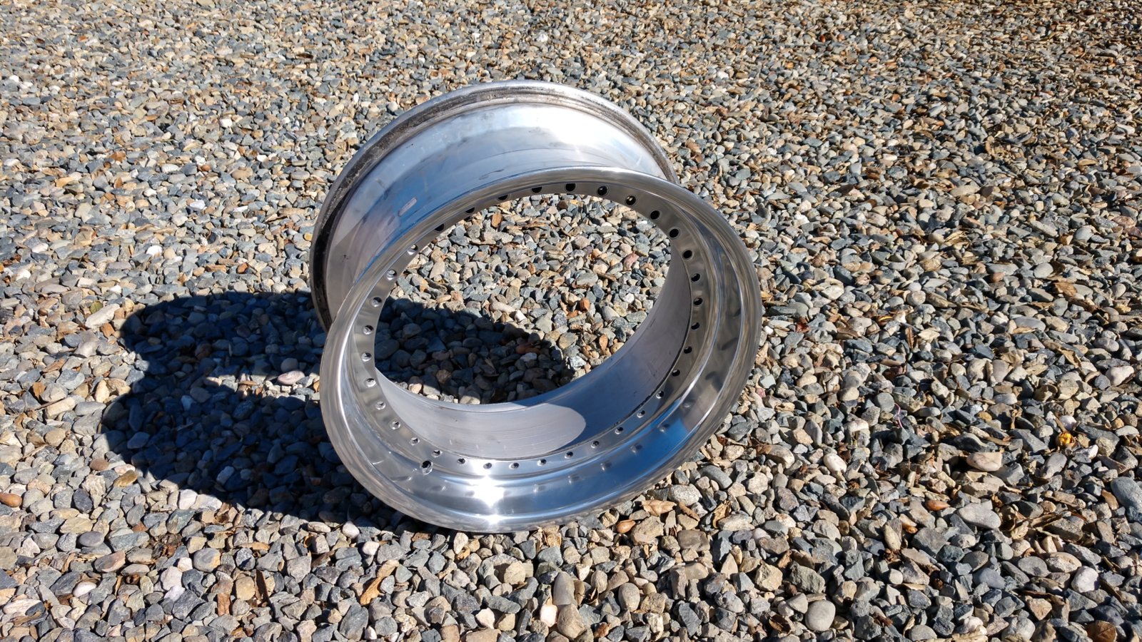

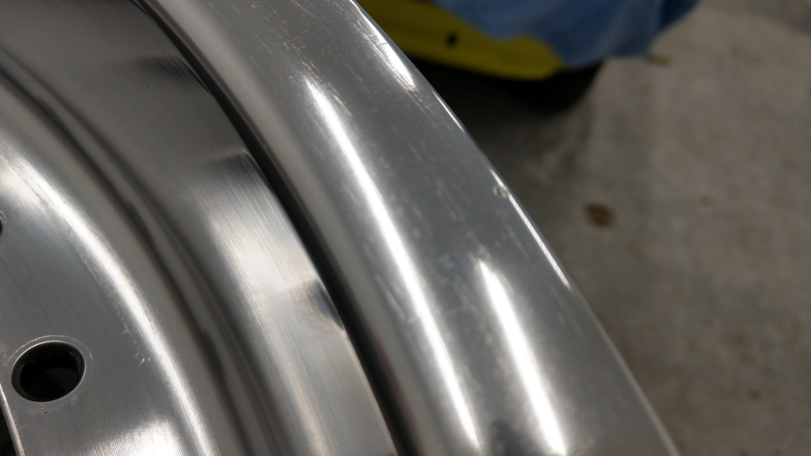

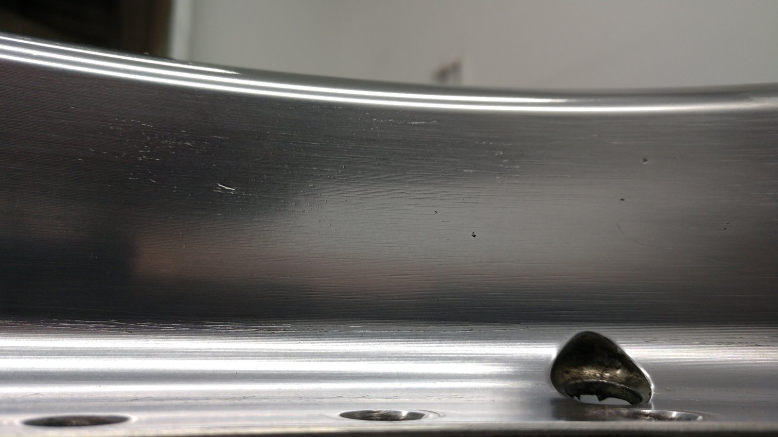

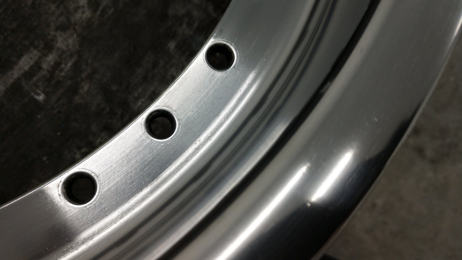

I'm in the middle of polishing style 5 wheels for my E3 and was wondering if anyone else has done this? There's videos on youtube showing different wheels getting polished, including style 5's, but I'm having trouble getting them past the machining marks from the factory. I've been doing it all by hand but I think I'll have to get some power tool help to do this right. They look "okay" but not a mirror finish. I removed clear coat with paint remover, then sanded with 800, 1000, 1200, 1500, 2000, metal polish.

I did a set a while back. If i remember correctly, I dry sanded with 600, 800, and then wet with 1000-3000. And then polished with Nuvite products. The polish was three steps.
I haven’t done it myself but had a set with a mirror polish. If you think about it, if you haven’t made your way to the lowest point in the wheel. No amount of polishing is going to get those marks out. I think you need to start with a more coarse paper.

Yeah, that's what I figured. I have an extra wheel so I'll test it on that one. My shoulders and arms are ready to fall off as it is! :p
Are you BUFFING with compound after the 2000 wet? If not, that is probably the missing step.
After wet sanding with 2000 I used 3M cutting compound (1) and polishing compound (2) with a buffer before using Blue Magic metal polish by hand. I think the polishing process will work fine but I need to sand the machine marks out first.

They won't polish aluminum. Aluminum will shine very quickly with the products I linked to. You may still see some scratches if you didn't get all those out with the sandpaper, but the aluminum will be shiny.
I just found this video that talked about the machine marks. He starts with 80 grit! I really like his "poor man's lathe" setup.

I did a quick test at lunch, starting with 80 grit, then worked up to 2000, then hand polished with a rag with metal polish. It's much better starting out by cutting the machine grooves out, only dealing with scratches now. I'll get some Nuvite polish and spend more time on them and expect them to turn out much better.
